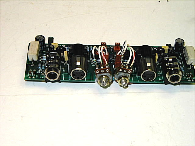

Which version of circuit cards do you have? Do they look like the DH-220 cards such as in your P-225 (P-230)? If so, you can use the bridging wiring diagram for the DH-220 bridging kit and these instructions are at the end of the DH-220 manual available from Hafler. The P500 should bridge in the same manner.
The balanced input schematic should be quite standard and similar to that used in other P versions. Do these balanced inputs go to their own separate smaller circuit board? You could examine the schematic for the Hafler P-1200 to get an idea of what to look for to handle balanced inputs. Can you supply a picture of the inside of the amp?
MOSFETs when used in parallel, in dual or triplet, must be matched to each other. The P channel paralleled devices must be matched to each other in that channel. Ditto for the N-channel devices. The P device sets in a channel do NOT need to be matched to the N device sets in that channel.
All your MOSFETs should have a Hafler grade number (1 through 7) stenciled to the top of their cases -- I guess. The older amps did. However I have a set of 12 MOSFETs here that came from a DH-500 and all have the same part numbers as yours but they are NOT marked with a grade number -- but -- they all are matched triplets based on readings from my Hafler MOSFET checker and have their grade number written on them. Hafler may have been able to get pre-matched sets from their supplier. Confusing? I'll send a picture in my next response.
As I told you in my email, for trouble shooting purposes, you can run this amp with fewer than 6 MOSFETs per channel. You could set one channel to run from 4 MOSFETs and take the extra MOSFETs and install them in the other channel. This other channel then could be run with only one N and P device. This assumes you will re-bias each channel as needed to adjust to the use of a smaller number of MOSFETs -- and that you will not be running up the channels at a high wattage level.

Thanks for the good pictures. Nice camera!
It is too bad a schematic/manual is not available for this amp. The DH-500 manual is of some value but it is out of date. Your circuit cards are of the DH-220 type. I think the bridging is done passively by some extra wiring, a resistor and a switch. The DH-220 manual explains how to do this. On the back should be a stereo/mono switch.
The extra circuit card seems to contain the balanced input/volume control circuits and the DC offset protection and relay time delay circuits. It would sure help if some gentle reader here could supply a schematic for this card and some wiring diagrams of how it is connected.
It should be possible with, some internal rewiring, for testing purposes, to bypass this extra card completely for trouble shooting to enable getting at the basic amp circuit. This would entail careful use of a variac to begin with low voltages and working up to full rail voltage as trouble shooting progresses, borrowing some MOSFETs from another channel or amp to replace those missing, and careful monitoring of offset voltages and bias current.
You could also swap in a DH-220 circuit card as long as you keep rail voltages at 65VDC or below. The voltage table from the DH-220 manual should help as it lists expected voltages at the EBC of all transistors on the circuit card plus voltages expected at the gates of the MOSFETs. Your voltages should be about the same, with the exception of those from the rails. The transistors on your circuit cards are all the same as those on the DH-220 circuit cards. Only some minor changes in resistors are made to enable use with 90 VDC rails instead of the DH-220 65 VDC. And, circuit board bypass electrolytic caps should be of the 100 WVDC variety.
Perhaps someone else has suggestions on how to bypass the extra circuitry card to get at testing just the amp itself. And, perhaps someone can help with a schematic of this extra board.
