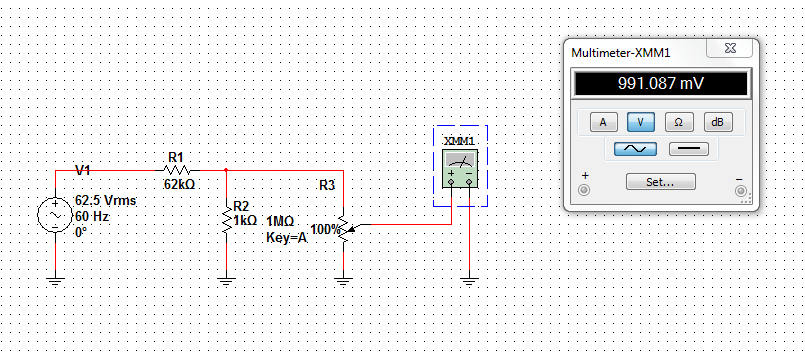

Isn't that how gain knobs are implemented? I'm not worried about distortion at the moment. I just don't want to feed about 20v from the second stage into the preamp of my solid state amp (which doesn't have preamp bypass for pedals). so how do i reduce the output from 20v to 100mv. (20v is just an random number).
Like i said i was contemplating a voltage divider after the coupling cap, but im not sure what effect the impedance of the guitar amp's input will have on the voltage divider.

My new question is if i were to make a tube distortion pedal (essentially an overdriven preamp in a pedal) what way is best to reduce the output of the second stage back to guitar level, lets say 100mv?
Use a volume pot on the output of your tube preamp and put a couple of back to back zeners across the output in case you have the volume up accidentally feeding too much voltage. That or a bunch of diodes in series at the voltage level of your choosing. Don't bother worrying about the loading effect on the pot from your amp, just set the volume where you want it.
I just ended up doing this. 1vrms at max volume shouldn't any damage to a preamp. It will defiantly distort, but that's what the volume pot is for. I just didn't want to push 60vrms into a preamp. and thats 1vrms with no load, so a low input impedance input should reduce that max voltage by quite a bit.
