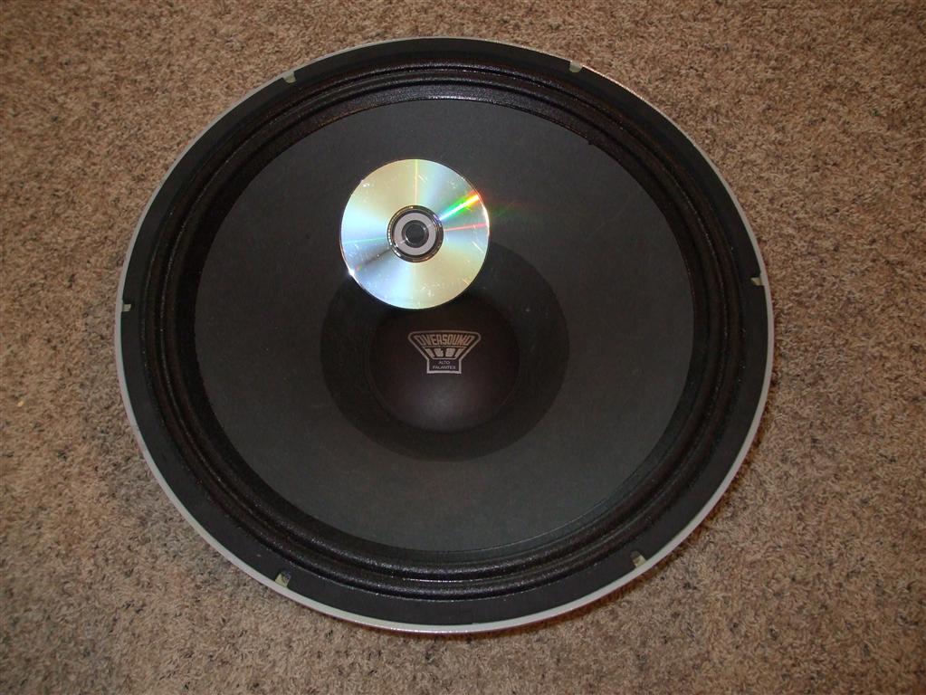

The cube box is ungodly loud. @.@ 100w rattles everything in the livingroom. It would be great for sound reinforcement but lacks deap bass. It's very "punchy" and kick drums slam your chest. I ran out of 4" pipe to try longer ports.
Oh look that's just what I said it would be like
The second enclosure is sort of strange. If I use a shorter 4" long port (44hz) the deep bass extends lower then with the 10" port (34hz). I'm not sure why. I haven't had a chance to drive it hard yet. The kids went to bed.

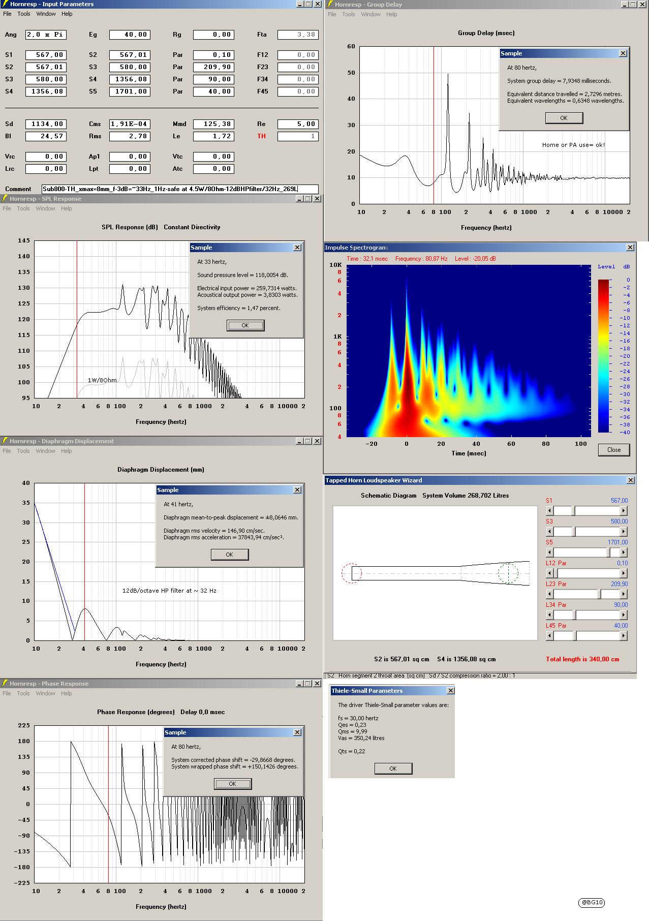

those are nice specs.
8mm of Xmax in an 18inch is unusually high.
The Qts=0.22 indicates a good motor.
Keep going.
I have a twin 18inch with twin 8inch vents in a 300litre enclosure with similar specs (before I added some cone mass) and only 4mm Xmax and it turned out to sound great.

If you take a look at this you can see that meyer sound agrees... Subwoofers benefit from large ports. Guessing that's about around about 4x10" dia. port area for just 2 15" woofers. By that standard my suggested single 8" port is tiny. Winisd alpha will model airspeeds, check it out.

A single 4" created a lot of noise but with two 4" or a single 6" I didn't detect any port noise at the levels I've been driving it even when I listen with the port facing me. I believe that's do to it's low xmax. This speaker doesn't seem to be particularly efficient at very low frequencies where higher volumes of air are moving. I never believed it to live up to audiophile expectations anyways. After all, it came off a table at a swap meet.
I enjoyed building the enclosures and experimenting to see how good I could get it. I've decided on a 24x24x16 enclosure with two 4" ports. My guitarist friend plugged in his bass with a 500w head and it liked it but it would need tweeters to be desired by a bassist. Looks like it will serve it's life as a PA sub. I'm sure I can find a DJ who would like it.
