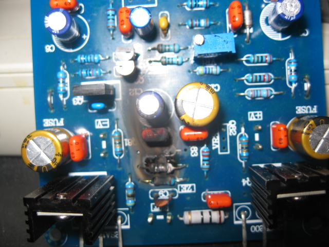

Well I set up the bias according to Carlos's instructions here:
DX Amplifier Adjusting the bias, and trimming DC offset
Everything went to plan. BIAS set OK in the correct range, DC offset also adjusted OK. No smell, no burning.
Time to remove the 10 ohm setup resistors and test at full power with the fuses in. Again no smoke. Measured temperature of devices, all OK. Check DC offset again, still OK.
OK let's plug in a source and a test speaker. Power on.... yeah music !!
First tune from this amp "One less bell to answer - The 5th Dimension". Next, "Hell's bells - AC/DC". Left it on for half an hour so far, all transistors are slightly warm at about 30 to 35 degrees C. Heatsink just warm at 22 degrees C.
So it turns out the only problem was using the BD140 that was supplied instead of a BD139 for the Vbias circuit shown on the DX website.

On the bright side at least the location of the original problem was self evident. On my latest project the SymAsym, one channel simply did not work, I spent hours looking for the issue having no idea where on this crowded pcb with lots of components the problem could be. I figured out that one of my Vbias transistors was connected backwards, but this was not causing the problem...so it took some helpful posts from others here to figure it out - a loose solder joint (invisible to my eyes).
I exploded a chipamp when it turned out that my plastic case was made of conductive plastic! I thought the screws holding the heatsinks into the plastic were insulated from each other but the plastic case actually connected a bunch of heatsinks (at different voltages) together. A LM4780 explodes with how do you say? A sharp report/ retort? Sounds like a .22 or slighltly larger gun being fired. Great fun when something THAT bad happens, and it was not hard to figure out what went wrong. It blew up the chip and also blew up that part of the board. You did better than me, your project is much more difficult than a chipamp.

I got mad when I blew a few outputs LONG ago on a repair. This can be expensive whether you do DIY or a repair. I knew enough even then to realize that the drivers were just a small amp by themselves.
One thing led to another and I refined this after 20 more consumer items. I just halve the main Re of the drivers (2 - 47R's for a 100R setup) temporarily tack these to the output bus and have a small working amp powered by the drivers.
I then adjust to 1.2v between P and N emitters , even listen to the amp with cheap headphones connected through a 22R resistor after I have determined there is no offset or magic smoke. Then.. and only then will I populate the main OP's , testing each one with the DMM as I go along. No more "crossing fingers".. I know at this point I will have no issues , even with 4 or 5 pairs hooked up as long as I check each one on a DMM and carefully observe polarity.
BTW , greg .. those 10R "screwup" resistors are my exact method.
