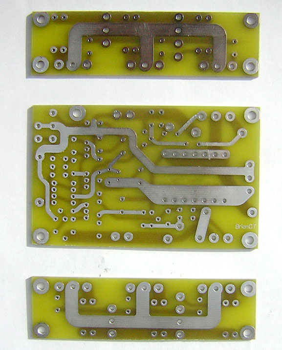

Some of those lead wires look very close to each other.
To tidy things up a bit I would use Peter's pcb as a driver board, and buy yourself some prototype board. You want a thin strip for each side of the driver board and mount your mosfets and resistors on that board.
Something like this (see the picture)
I remember nelson saying that you want to make sure you keep the output and input wires as far away as possible from each other. In the picture they run almost on top of each other. If this is how you have it set up at the moment, route the ouput wire away from the input wire.
Just one more thing. On the left side of the picture you can see a thermistor wire and resistor wire crossing each other (almost touching). When the heatsink is mounted verticaly there is a good chance that the weight of the thermistor could cause it to come into contact with the resistor lead wire.

When the sink goes back vertical the inputs and outputs are reasonably separated.
The resistor is above the thermistor...pic is deceiving. There is plenty of clearance as the thermistors on both sides sit pretty flat and the additional 47 ohm resistors arc above everything.
