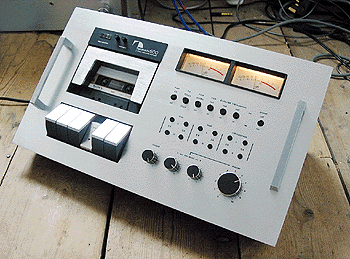

thats a hell of nice device ......and after all these years all it had wrong was afew caps and one faulty relay .....nice hei
e mail me
if its the same i have manuals ( that i will not photocopy and make pdf ) but i can give you any info you want or sent by post a copy of the manual .....
i also fixed a 1900 and a 480 a few days ago .....the 1900 was cra****py was allready vandalised
but the 480 was a joy ...really played very nice after the repair .....a lot of caps man

Nakamichi 600. It has that slooping front.

The 600 is fully configurable for either Ferric (EX) or Chrome (SX) tape.
Metal tape for cassette use had not been invented and Nakamichi wasn't a fan of Sony's new-fangled FerriChrome formulation.
A built-in 400Hz test tone is provided,
which in conjunction with separate left and right pots for recording level, bias and IM suppression (Nakamichi's proprietary intermodulation distortion suppression system) for both EX and SX tape,
lets you tailor the machine to the tape with great accuracy.
No other rival design offered such adjustment, and the result was an incredibly convincing sound, even by today's standards.
