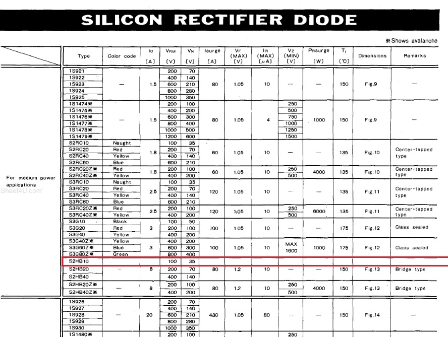

I can't find the rectifier component S2HB10 in order to replace the damaged one.
But is it damaged? Replacing rectifiers is trivial, no need for same type if the replacement is physically compatible and able to withstand higher current and reverse voltage.

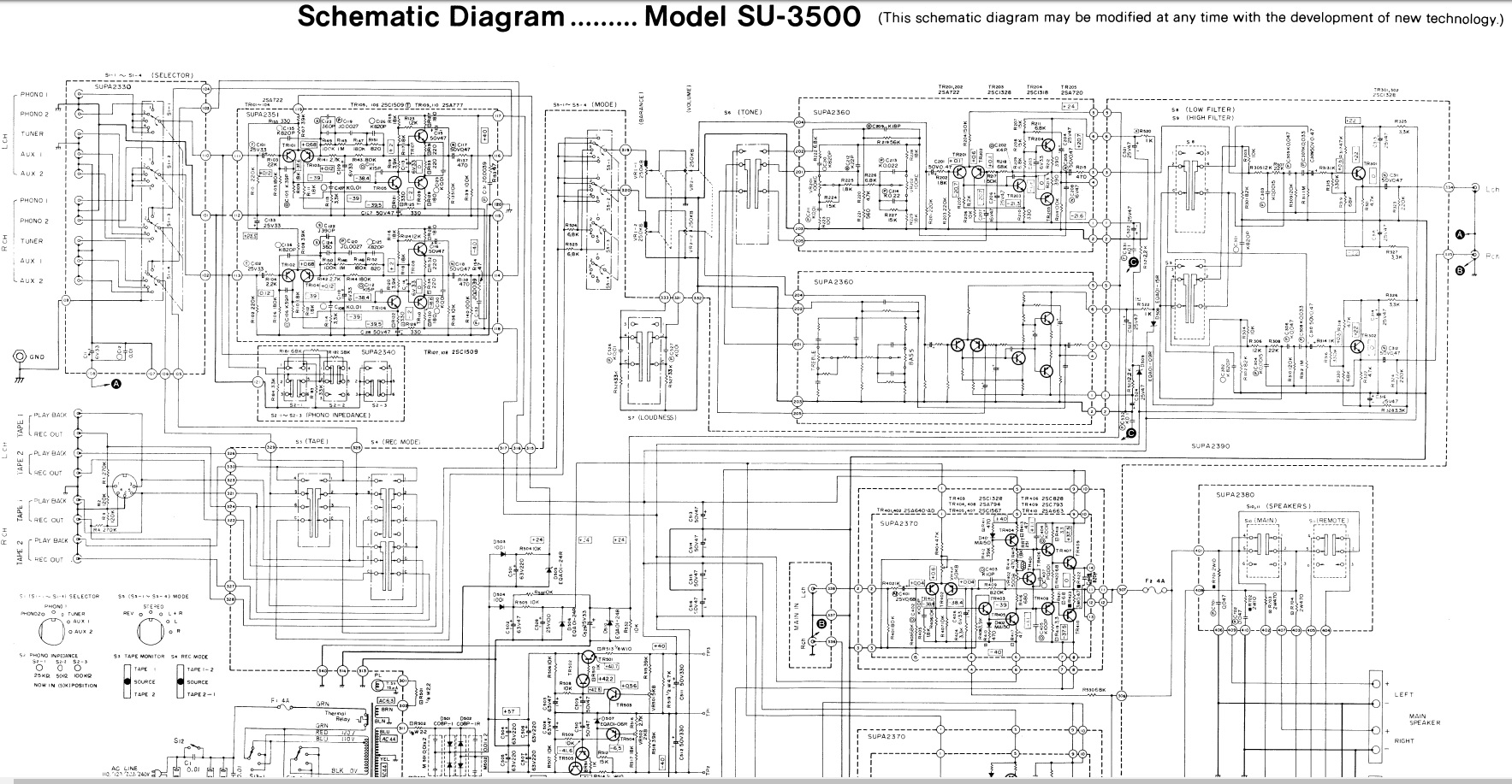

I understand that the current goes from the main 10000uf caps to the rectifier and from rectifier goes to what components
Nope.
The current in this circuit goes:
Mains - Transformer Primary:Secondary - Relay contacts - Rectifier - Caps - etc.
When you reverse the polarity of the capacitors, the internal insulator erodes and becomes conductive. This leads to a short circuit.
Your fuse blew because you provided the current a new path to the ground that had no load (the rest of the amplifier circuit) and this current flow (and consequent current demand on the primary) exceeded the value of the protection fuse.
The components that would have been potentially damaged are those in that short circuit loop as they were the ones exposed to the high current flow.
That is the caps (obviously), rectifier (but they are usually fairly robust), relay contacts (worth checking) and transformer. The transformer should have been protected by the fuse so I would personally focus on replacing the supply capacitors (don't turn the amp on with the suspect capacitors again, you may cause more damage. Reinstall the old original ones for testing if they are still good) and checking out that first power relay.

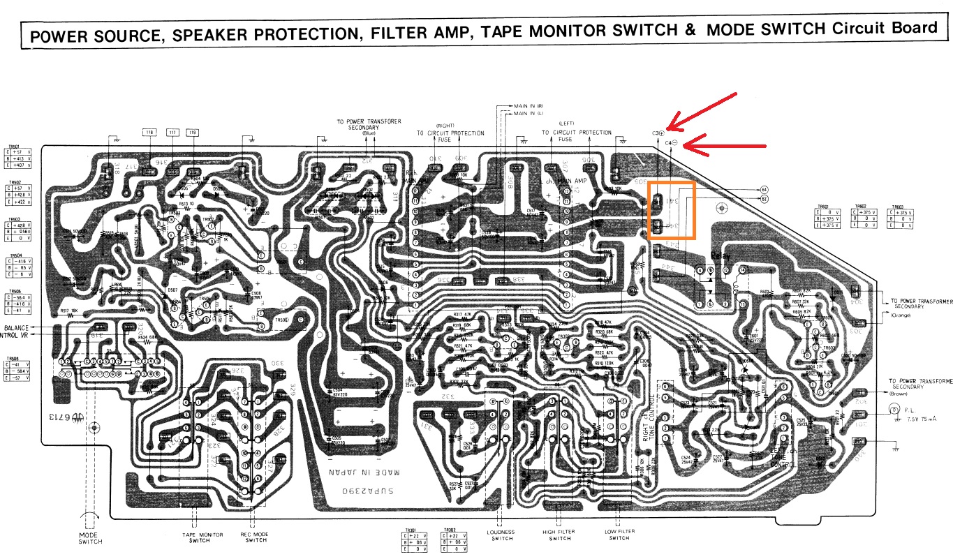

I installed the caps backwards because the old caps are tricky .
On one side it writes negative black but under that writing is the positive and the negative is on the other side of the cap .
I don't understand why they did this in the past .
If a manufacturer writes negative on a cap the negative lead should be on the same side of the writing ...

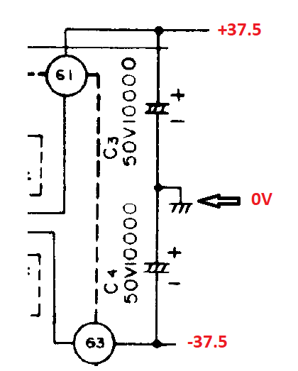

The amplifier circuit is powered by a 'split rail'. This means that you have a positive supply, a negative supply and a ground.
In your case, the circuit is supplied with +37.5v, 0v, -37.5v.
Look at the highlighted part of the circuit that I've attached.
The top capacitor has the "+" connected to +37.5v, the "-" connected to the 0v. All good there.
Now look at the bottom capacitor. That "+" is connected to the 0v. The same one we just connected the top capacitor's "-".
That is because the "-" is connected to a voltage that is more negative.
As to the bridge rectifier, yes that one should work as long as the physical dimensions are near enough. The '20' is rated to handle more power than the '10' that is in the amp but that's fine. Generally higher rating is better than lower as long as the other parameters remain the same.
So I replaced the main caps today and the rectifier S2HB10 with KBPC802.
