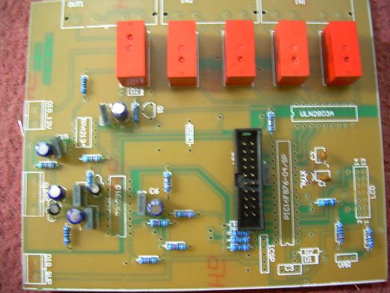

what you have to do send 16 bits of data to PGA is define variables as:
one variable containing data of both channels as word byte
one variable defined as byte containing data of left channel
one variable defined as byte containing data of right channel
when you want to shift data to PGA transfer word variable and you ll be able to operate both channels.
Right now I am working on two different version of pre around PIC and PGA myself one isa simple version and other is a high end one.
I have got the board (made in my own fabrication unit).
Here is the PIC of the simple version pre board ( I ve got 6 each)
Hopefully you ll be able to control both channels if you still have problems let me know and I ll try to help.....
