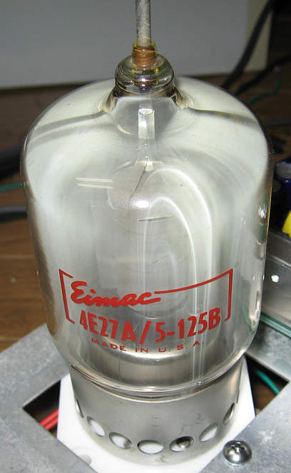

On the other hand, I ordered one 4E27 but they shipped out
4E27A instead. I applied 5V to the filament but it went
burn out with smoke (see below URL). I requested to AES
to deduct the cost of 4E27 from my credit card account.
http://www.ny.airnet.ne.jp/ohashi/D-classBBS/data/4E27A.jpg

I have seen an Eimac RF tube smoke like that before. If you think about it smoke is created when something burns. In order for something to burn there has to be air. My 4 - 65A had air in it. So did that 4E27A.
From many years of experience I have found that virtually all old Eimac tubes with "green glass" on the bottom will be air bottles to some extent. Even if it doesn't smoke the filament will light up dull. For some reason the seals just didn't hold up. You stand a much better chance with clear class bottoms. I won't even buy the green ones anymore.
Also, almost anything in that style of glass power tube (4-1000 & down) with dark streaks on the radiation shield just below the plate structure will be weak. Those burn marks, which aren't always obivous to the uninformed, are a sign of hard use. Even if there is no coffee stain on the glass.

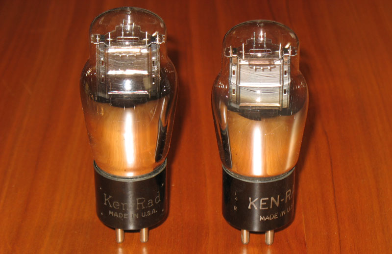

The moment of truth has arrived. A package from AES bearing the new, hand selected, supposedly physically matched, 71a's showed up at my door. And the verdict?
They are the same brand, clearly made in different years (probably different decades) and one is considerably taller than the other. That is to say, they are not even close. This is just bewildering.

I have had the same problem with 71A, and whats more 50% of the NOS/NIB ones I have purchased have been bad - and as you know they are somewhat expensive. I currently have a mismatched pair in my headphone amplifier and can neither measure nor hear any audible differences. (It sounds really good!)
I've also got ones that are same date code, same brand and mismatched in height so go figure.. :D
The problem with the 71A is that it quite quickly became obsolete and only a replacement type made to keep outdated am radio receivers in operation - most were made during the worst years of the depression and QC does not appear to have been the primary consideration, either that or mis-handling of my NOS/NIB tubes must have been egregious. (Two have severely mis-aligned filaments relative to the grids, they work but are not great.)

Frustrating. I am working hard enough on this project to make it look nice that I'm just not willing to put up with it.
Maybe it is time to find a different tube, then. Any suggestions on a 4 pin DHT with a low mu and the lowest rp possible? Filament needs to be under 500mA or so, too.

The 71A does not have particularly low rp, I think you could select the 45 as an alternative as it's rp is similar.. (It's also wonderful sounding in headphone service.) The 6B4G or 6A3 are other options and have much lower rp than the 7A or 45..
Some of the German post office DHT might work well in this application but have odd sockets and 4V filaments. You might want to look at the AA, BA, and BAS.. They are available on eBay for not obscene amounts of money and are quite linear.. Most of the information about using them is in German unfortunately as they have not traveled far afield. (Although I do have some.) RFT, Siemens and Valvo all made these types.
I've held my peace so far, but I'm gonna say it again.  A tube with the rp of both of these, but about three times the gm, and otherwise really kewl specs (though it's not qui-ite as linear as the 71A), available, cheap, is a teevee video amplifier tube hight 6T4.  There are, of course, other very similar tubes from the era for the same duty, all with similar chars, some differing only in pinout.  I picked the 6T4 over others as a replacement to the irritatingly microphonic 6AQ5 just because Jack was holding. You might want to look at some of these, if you're not married to the gorgeous coke bottle.
They do, in their favor, have heaters that stick 2-3mm out the ends of the cathode sleeves, so they glow very romantically.
