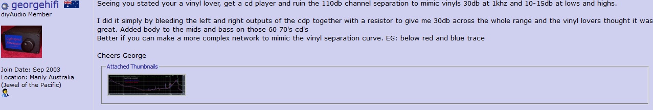

We have about a 20 db at best stereo separtion. Like seeing in the infra red it has no value to to think 110 dB something to get excited about.
