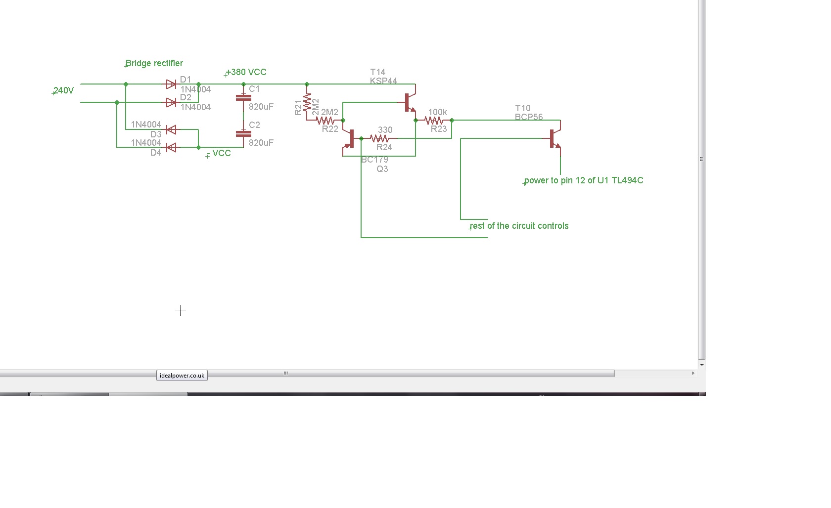

U1 is not alimented.in hes path is T10 marked BCP56 that is another NPN transistor and it seems measured still good.I am gonna remove another transistor 1Bt from the board to see what type is and try to change it accordingly.Thank you for your big effort,will let you know how it goes when the KSP arrive in a few days.
Daniel.

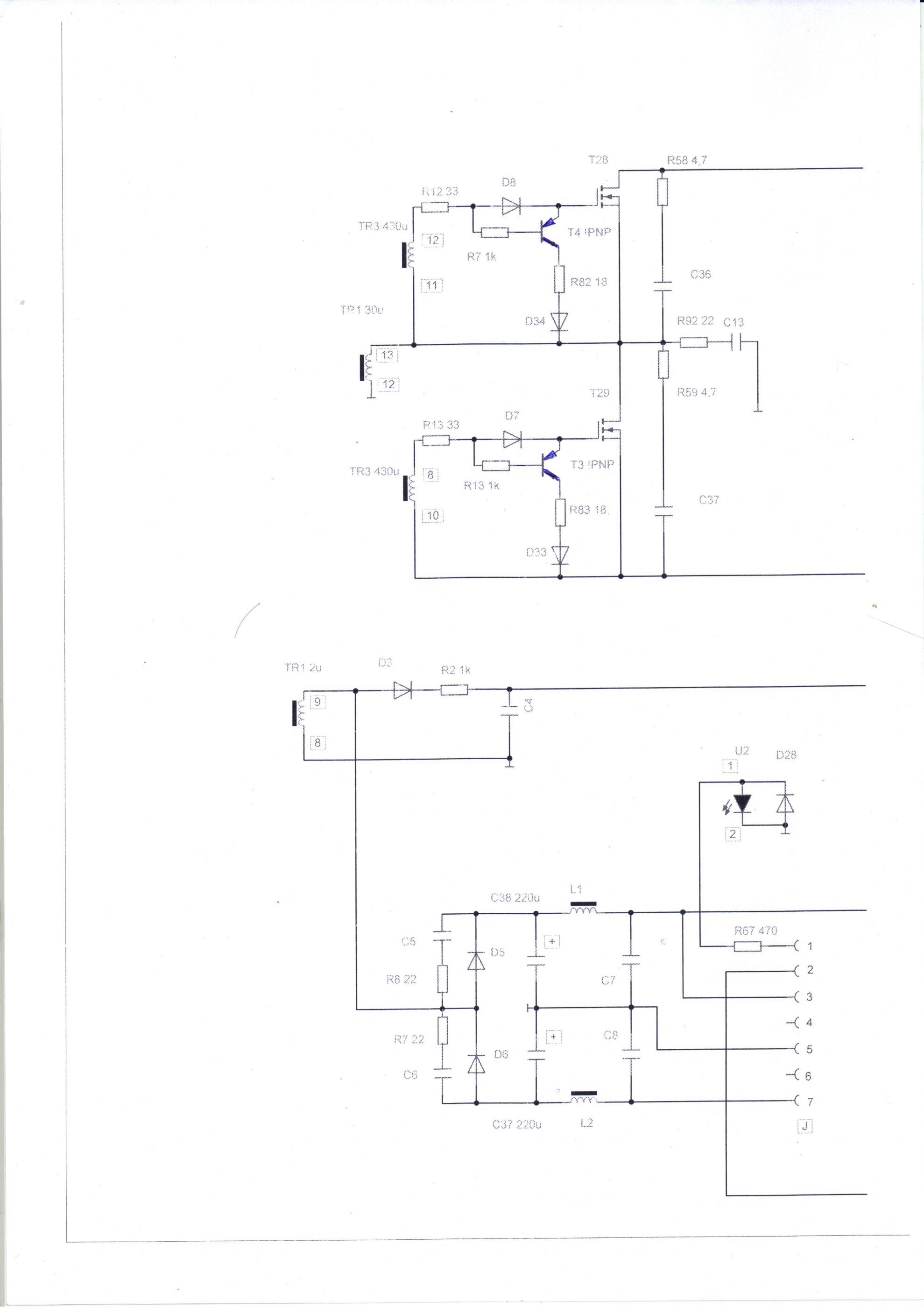

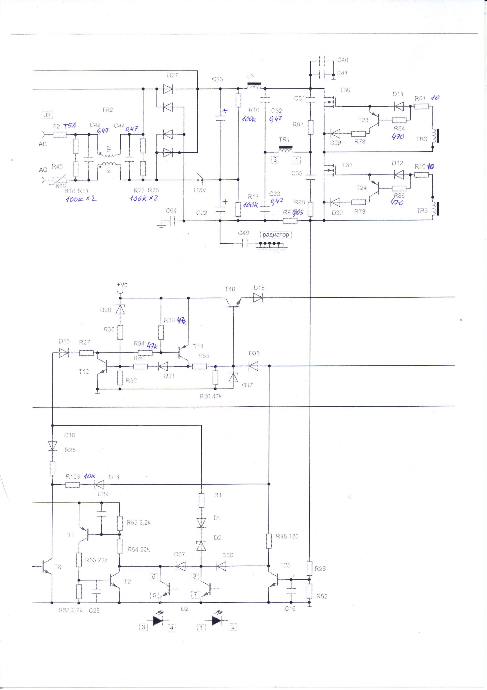

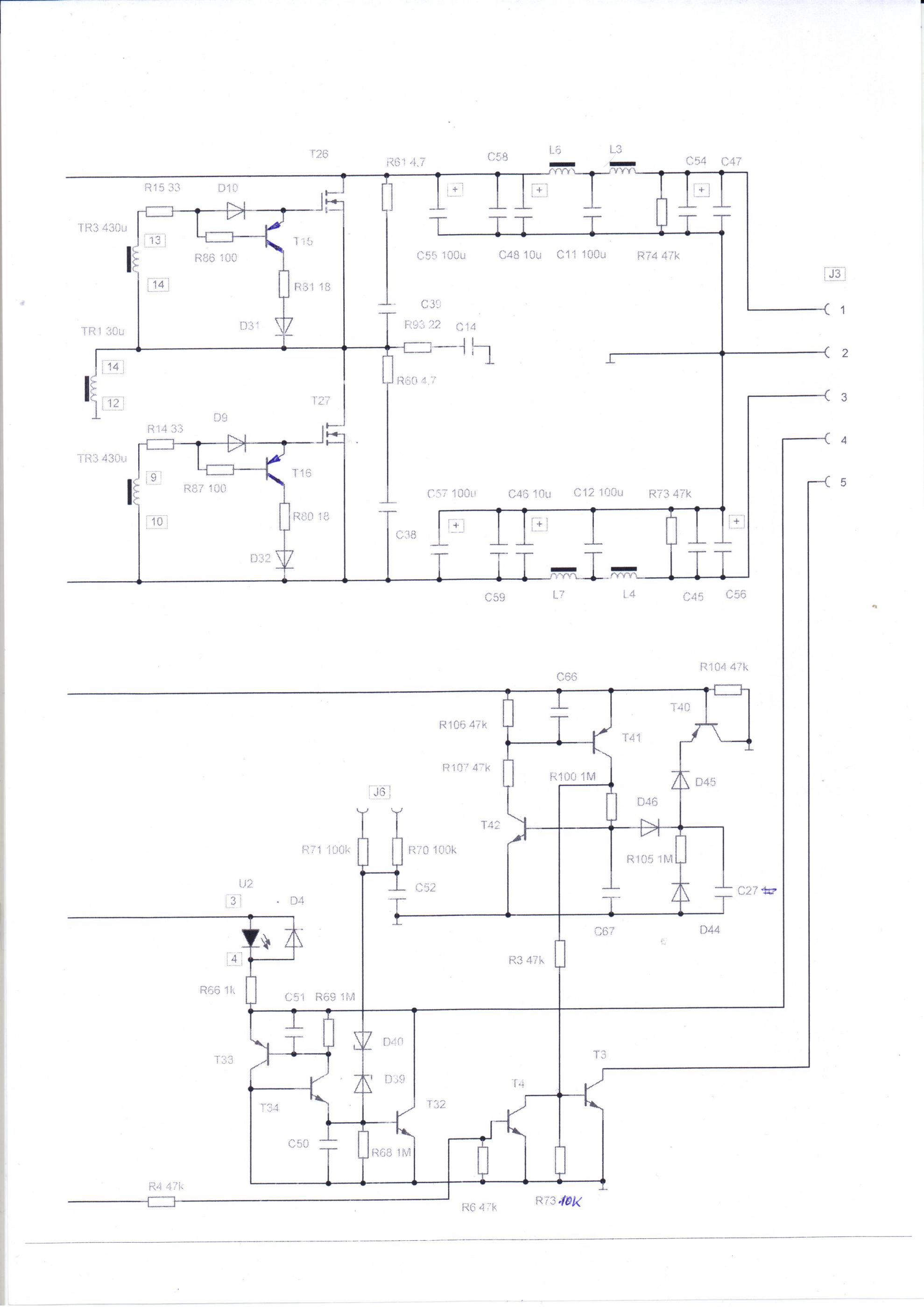

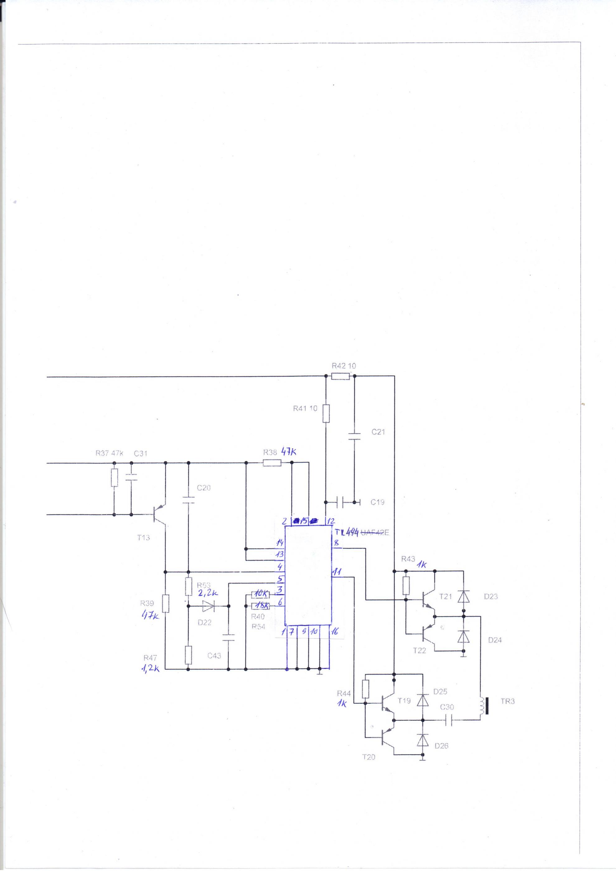

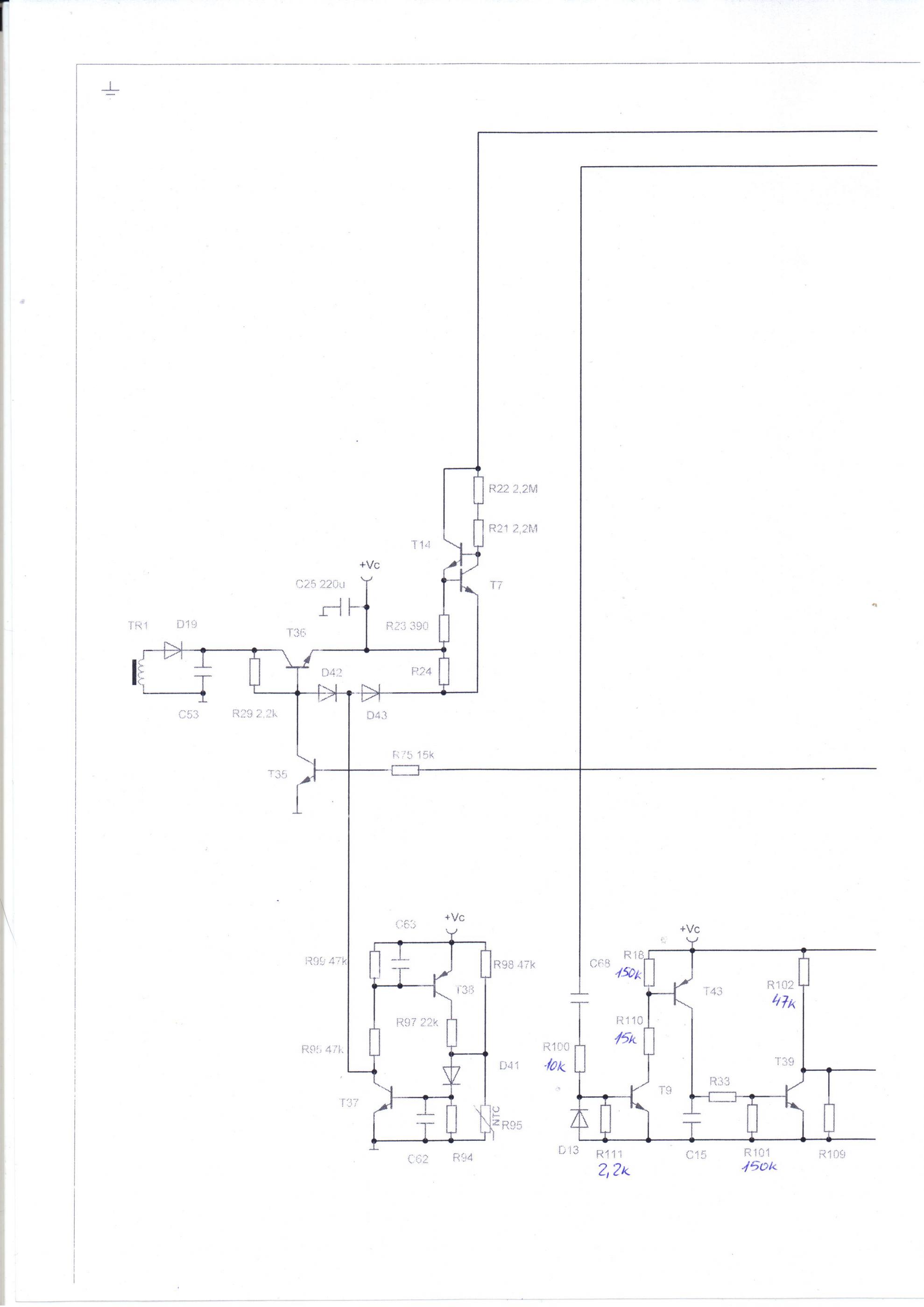

I made a quick drawing in eagle of the primary circuit.The diodes are only simbolic,there is a bridge rectifier and filter,and are all good.There are too many smd components on the board,that for reversing and making a full schematic would mean to desolder them all and throw away the board in the end.My scope is to try and repair it as it is with the only 2 transistors,otherwise will buy a new one hopping it will be exactly the same and will work in my powered speaker.
Back on the right track today.Even if it was more than 3 weeks ago i had a very pleasant surprise today when i received an email from Hypex customer service.I had brough a new supply from then 3 week ago and was very happy that i received it within 2 working days and my cab was working again.Now i have the part list of the transistors i need to repair my old one and keep it as spare.The 2 transistor are
T7 - BC846BW and T14- KSP44.
