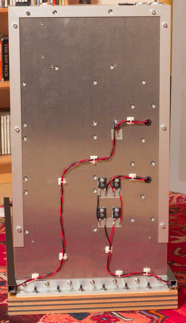

Most excellent, but beware that I use a direct driven ribbon. The impedance of the 2Ω series resistor is extremely large compared to the 20mΩ or so of the ribbon, this means that were talking pure current drive without any electrical damping.
It's a distinct possibility that the low output impedance of the NCore is not an advantage when it comes to mid or high frequencies. If you need to attenuate the tweeter signal you could choose to do that after the amp. I did this for the Neo10 mids in my system. This way I don't loose any bits in the critical midrange.
This is the bottom view of the amp with four 0.5Ω 100W Caddock film resitors for the ribbon and a 15Ω 50W Caddock resistor for the mid.
I also have RF input filters directly on the XLR chassis connectors and paid attention to proper shielding.
