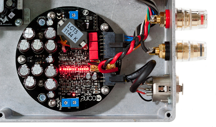

can someone clarify a basic question:
say a DAC's balanced output produces +4dBu at full digital scale. This is 1.23v
Is the differential input voltage at say Ncore input 2.46v or 1.23v
As i understand Ncore will produce peak power at 2V input level. Again is this +2,-2v on the differential input (4V) or +1,-1v (2V) ???

+4 dBu is 1.23 VRMS (root mean square). The peak-to-peak value of a 1.23 VRMS sine wave is 3.44 V, or +1.722/-1.722 if you reference it to some arbitrary middle point, but that is the wrong way to think about it.
A fully differential input doesn't know anything about "ground" or "earth", so when you say "+1,-1", the logical question is "referred to what". The right way to think about a differential amplifier is that it amplifies the difference between the non-inverting and the inverting input - in the case of the Ncore, a 2 V voltage between those inputs will cause full output.As i understand Ncore will produce peak power at 2V input level. Again is this +2,-2v on the differential input (4V) or +1,-1v (2V) ???

My bad - I should have stated "2 VRMS".
The nc400 has a voltage gain of 26 dB, so a factor of 20. For a 400W output into 4 ohm (or 200W into 8 ohm), you need an output voltage swing of 40 V, so an input signal of 2 VRMS.

What's the best way to reduce the gain of NC400 down to approximately 20.6 dB?
Change or remove R141 (in the feedback network).
Ok. I found it. Wow, it's a tiny!
Welcome to the world of SMD devices
There are pretty good guides to SMD desoldering on the net. This one is not too bad.1. How do you remove it?
2. Does it take soldering to replace it by a new one?
Gain is 4.5 x (1 + 2*Rf/Rg). Rf is 2.2K, Rg (R141) is normally 1.2K, giving a gain of 21 (26 dB). To get 20 dB, you need to drop the gain to 10, so Rg needs to be 3.6K. You can buy SMD resistors from an electronics component supplier such as Farnell or RS Components.3. Where and what do I buy to get the desired gain?
