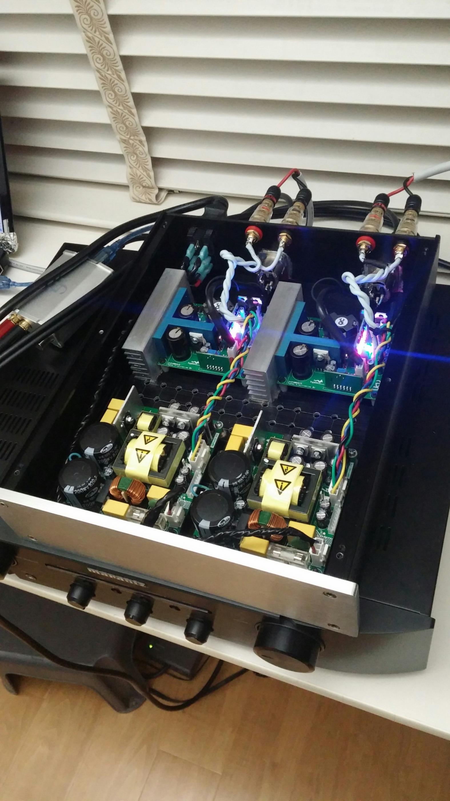

first of two 2ch ucd400 done and playing.
pardon me if ucd amps are out of place in this thread. Please help move to right thread.
