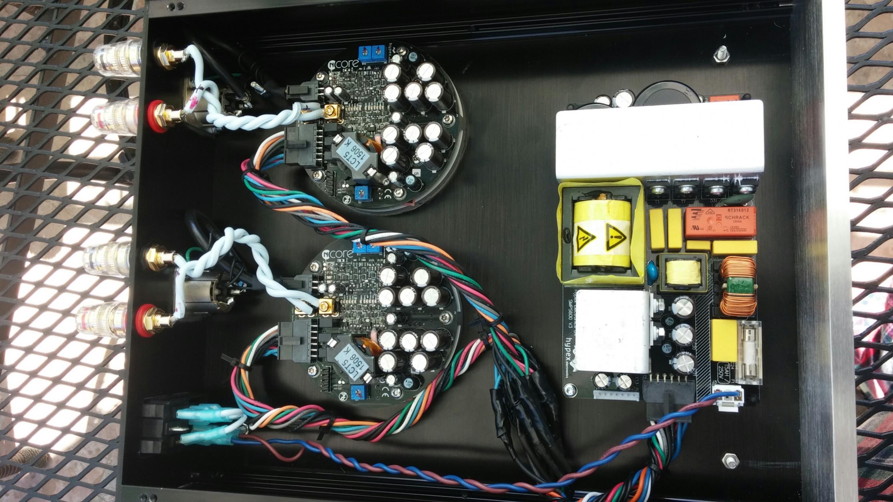

went ahead and connected nampon to chassis.
Powered on the amplifier. I hear it play.

can i connect to chassis?
Yes, unless your chassis is floating. But any ground (the shield of the input audio cable, or power supply ground) will do.

here is the first of 2 nc400 amps and 2 ucd400 amps under construction.
Unfortunately I don't seem to be able to view a larger version of the picture.
[Edit: seems the picture jpg file is somehow broken - it has a non-JPEG header)
adding the picture again
Still doesn't work in firefox, but I did get it to load in chrome.
Looks nice and tidy!
The chassis does get a bit warm after about an hour of music.
How warm? Do you have an IR thermometer, or some way to measure the temperature inside the chassis?

I am measuring 109F/43C inside the chassis. This is with a kitchen thermometer
Ambient today in San Jose is around 86F/30C
I had sanded off the anodization around the XLR mouting, however i did not do that where the ncore modules are placed on the bottom plate.
Does it make sense to unmount and sand the area out? I have to handle the messy heasink paste carefully, dont want any smears to cause shorts on the SMDs.
43C isn't too bad - but a few more ventilation holes would not hurt either. Hypex specifies the maximum heat sink temperature as 80C.
I wouldn't bother with the sanding, as long as you have a proper chassis connection through the audio input cable and XLR connector.
I think I have done that right. I was considering sanding for thermal reason.
I am going to add the ventilation holes, but wanted to make sure the build is right in aspects needed to ensure long term usage
i am probably overthinking this. But the anode coat is pretty good on this chassis and they are not the best conductors of heat and current. Further i did a bit of a sloppy job with the heat sink past under one of the modules.
I would not worry with a chassis with only two amps and one PS - I have to be a bit more careful, with 4 amps and 2 smps's in one chassis.
The fact that your chassis gets warm shows that it is actually conducting heat pretty well. What you don't want is a really hot heat sink/board, and totally cool chassis...
