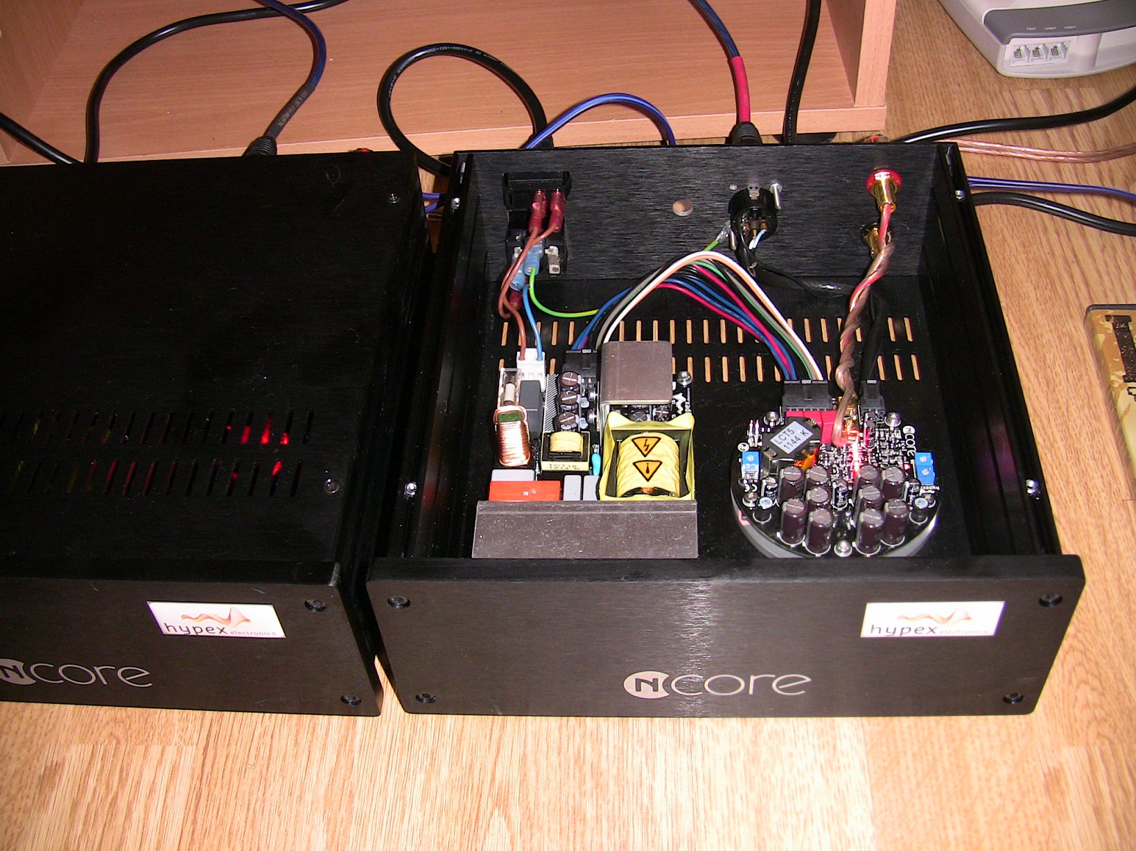

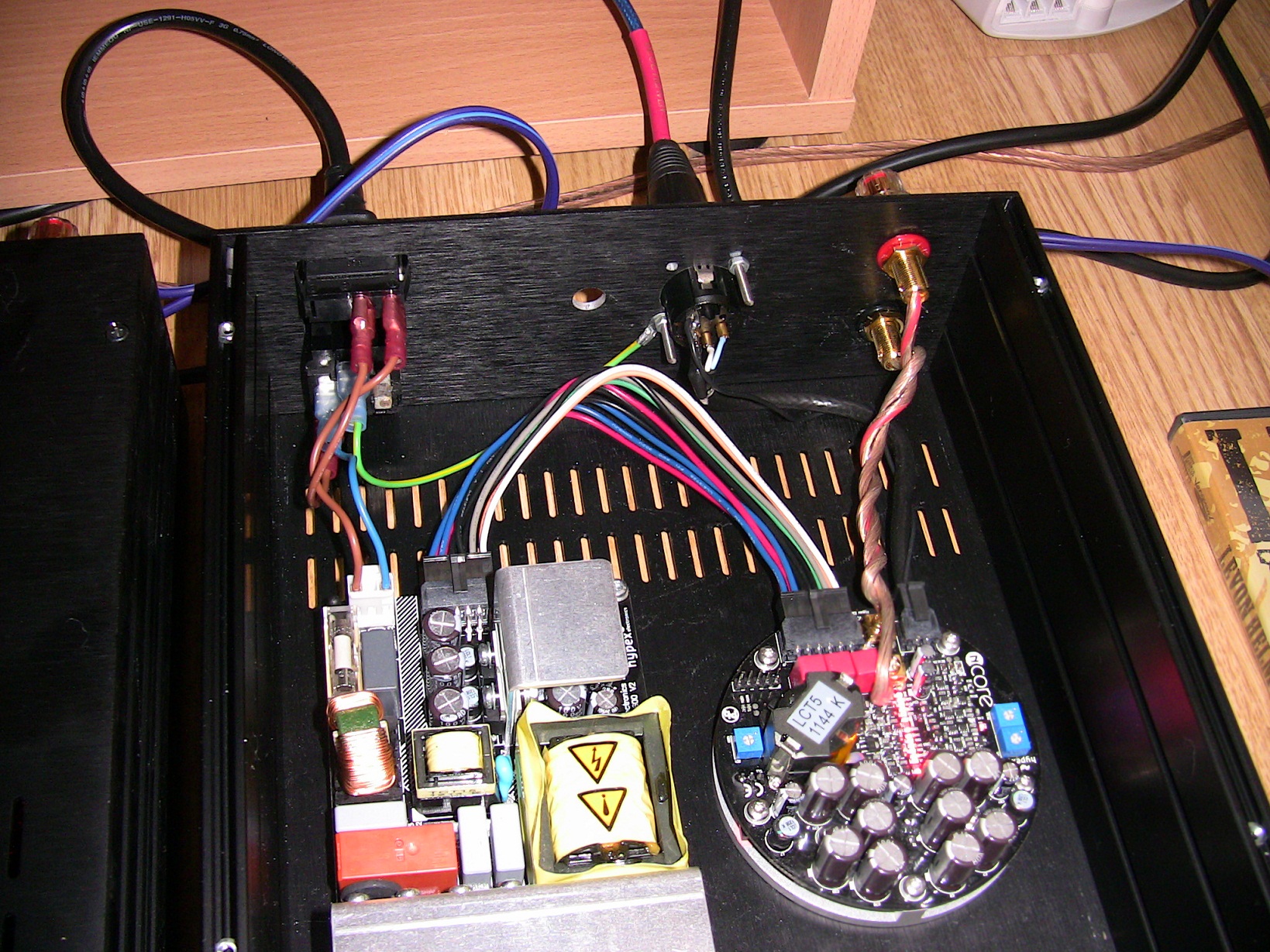

Hi, my NCore, excellent sound.
Only one question: Does connection between case and ground is correct, the green wire.
Look at nc400 datasheet again: "Figure 2: Preferred connection". There is no connection from IEC ground to chassis. Also, check that XLR pin 1 is connected straight to the chassis and also the signal ground from the module should be also connected to the chassis. I did not see those chassis connections in your build.

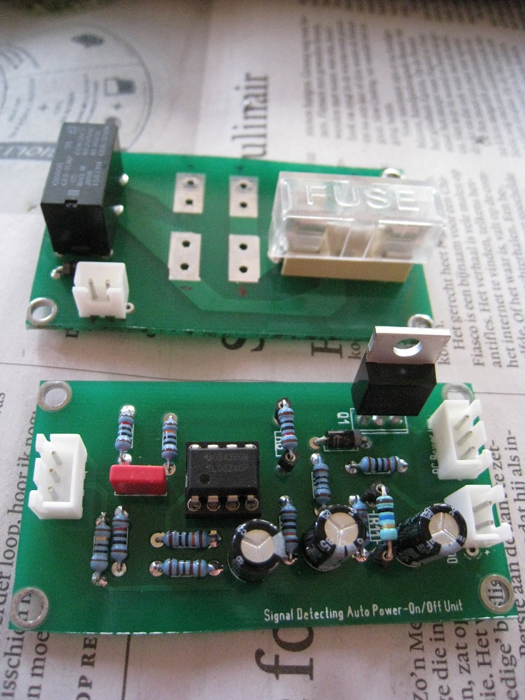

Hi Audioschipper,
At the moment i'm switching the amps on with the power switch at the IEC power inlet. Because I positioned my amps and other audio gear different in my audio rack it is now a bit hard to reach. Therefore I designed a simple circuit that detects the incomming line signal and then switched on the amps. It also switched off the amps when there is no signal for about 15 minutes.
I got the schematics from Elliott Sound Products and designed a little pcb myself using his schematics. I just received the pcb's and soldered the components to it this afternoon. I'll build it soon into my amps and see how this works out. Perhaps this is also a nice solution for you? Because I had to order 10 pcs I have some pcb's left :spin:

Does that mute the amps (nAmpon) or switch the psu to standby? This would be very useful for lot of people, at least me :) If I ever get to build these, that is.
