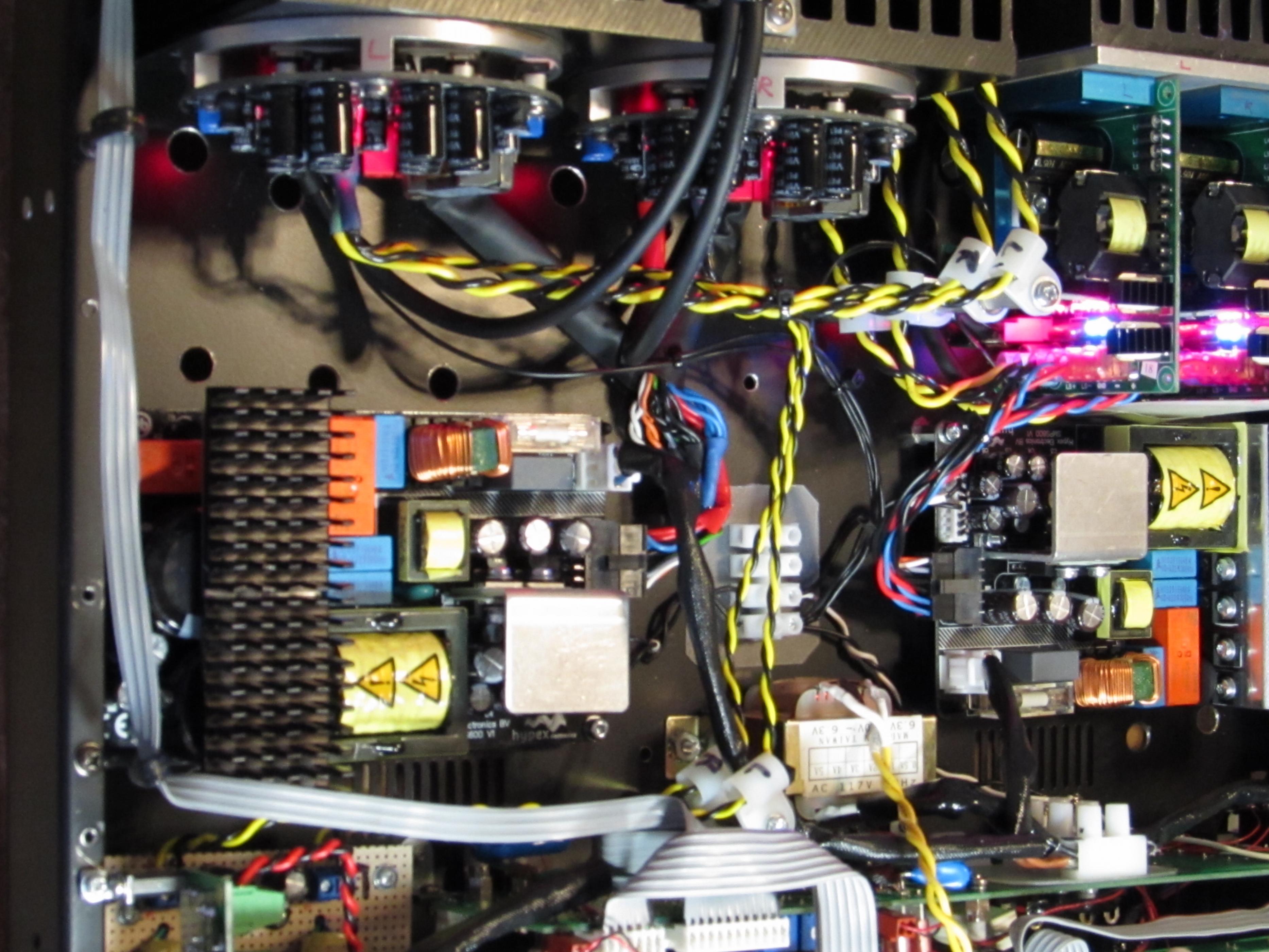

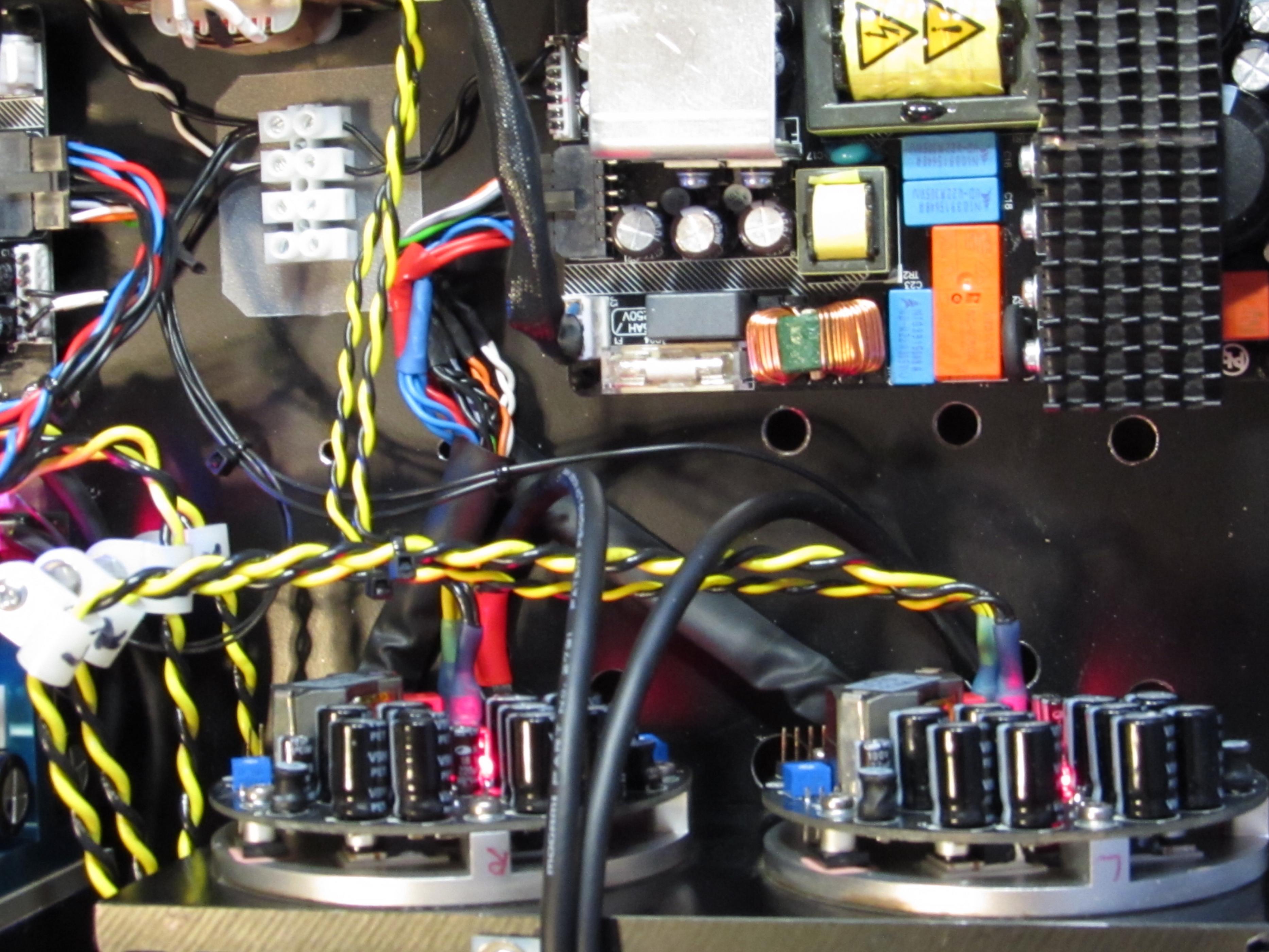

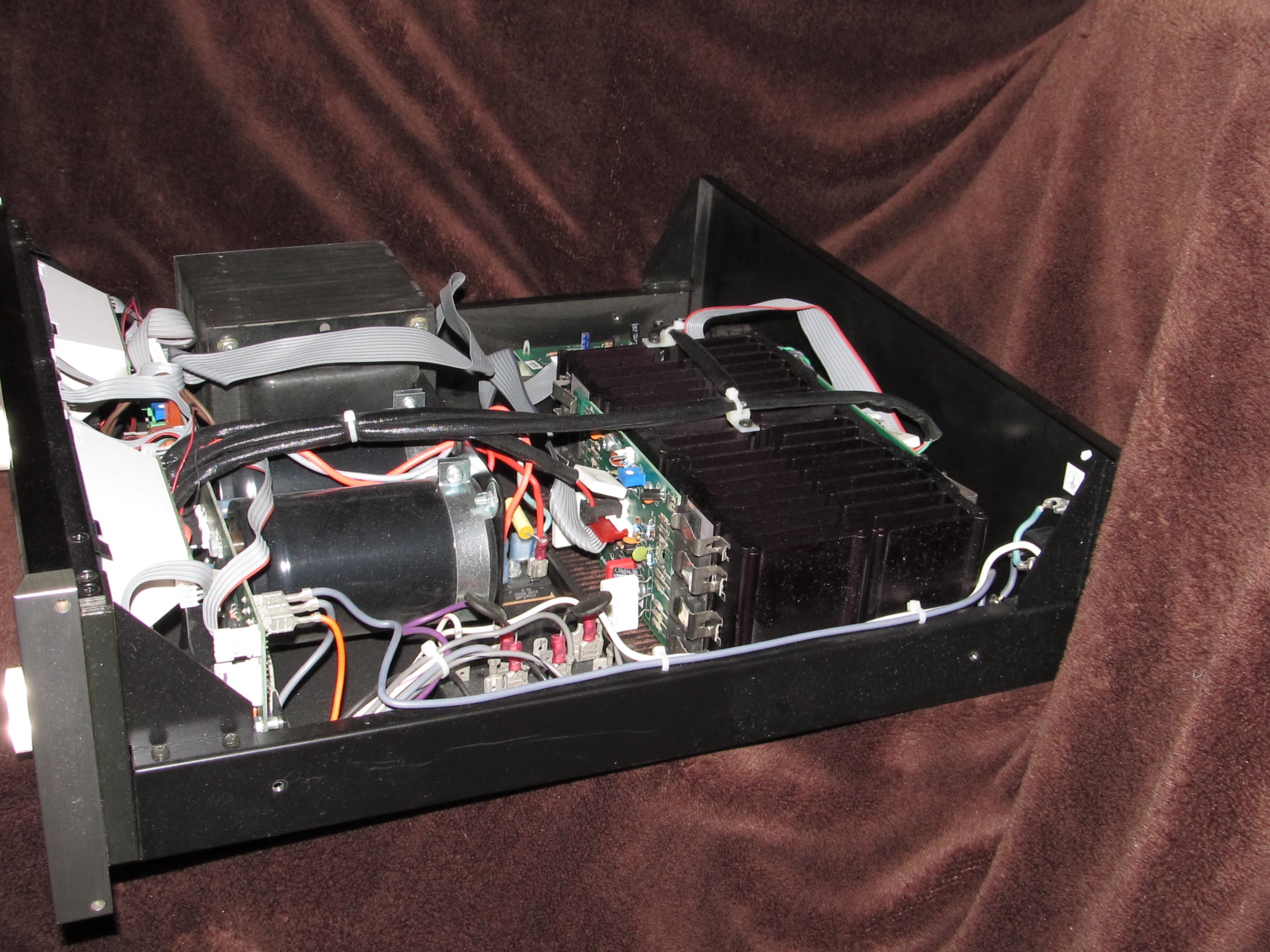

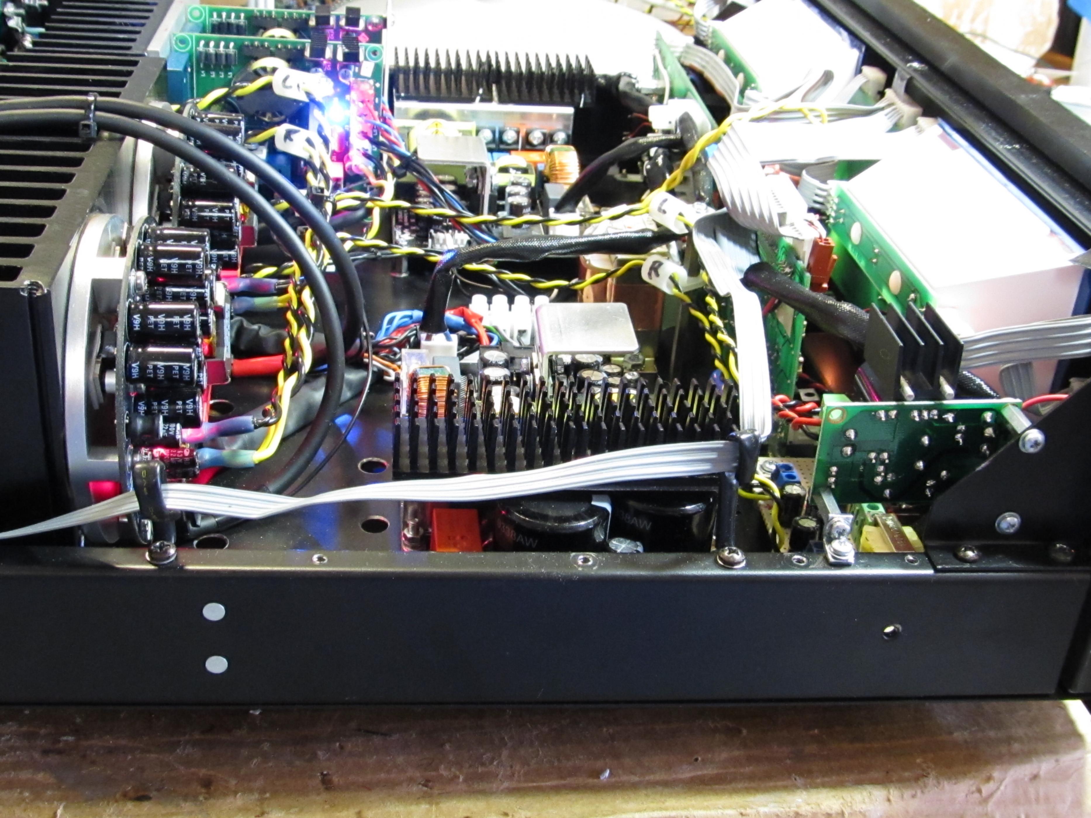

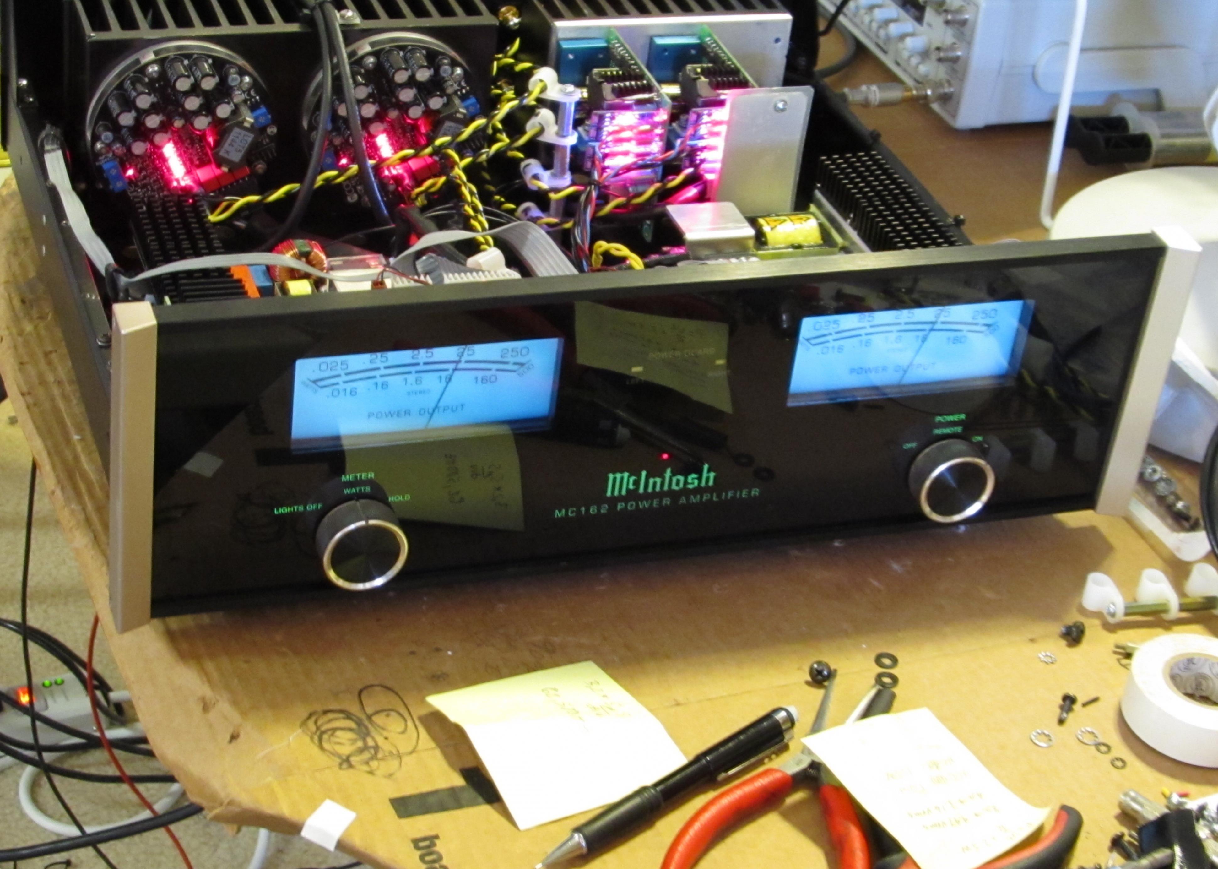

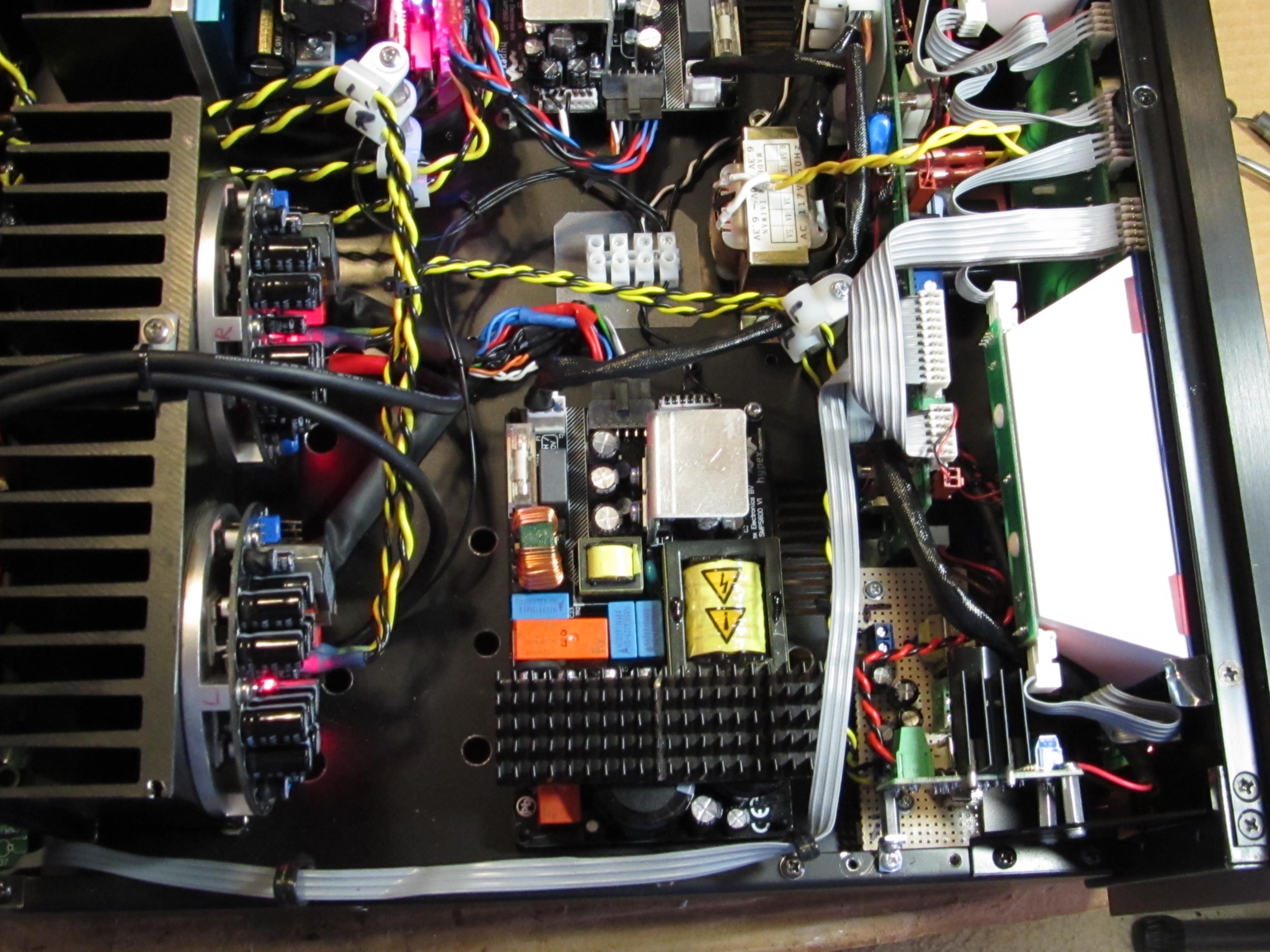

Here are some shots of my NC400 and UCD400 4 channel amp. The left photo is the original donor chassis. One power supply for each generation. OK, the saucers do not need that much HS, but that is what I had....and it fits in w/ the vintage chassis style...
Interfacing to the remote on/off and meter driver circuits was a royal pain...I wish folks would not be so "clever" with their on/off circuits!
I coupled to the meter drivers with a pair of step-down transformers because the Mc circuit has a single ground and I did not want to add a ground-loop to the layout. e.g. dual ground going in, single isolated ground going out.

The McIntosh on/off circuit and remote trigger is a AC/DC plus analog/TTL hybrid - quite strange and unnecessarily convoluted, I had to re-design it; the NC 400 is properly and simply done such that the error-lines and power-on triggers "OR" together naturally, so we can easily use one PS for two channels.

BTW, the Mc 162 is a mid 90's design. Later generation Mc amplifiers have simpler and better administrative circuits for on/off.
