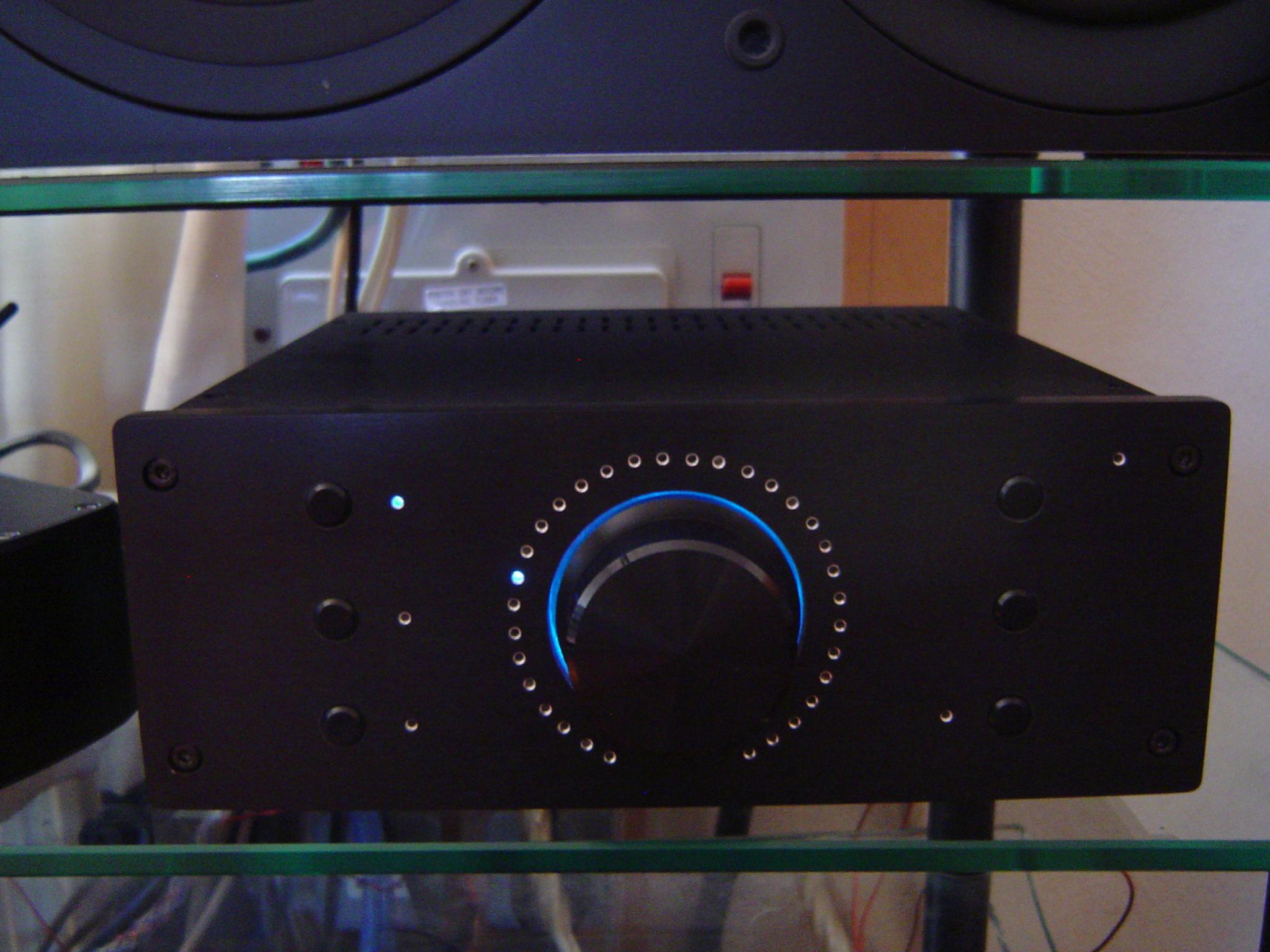

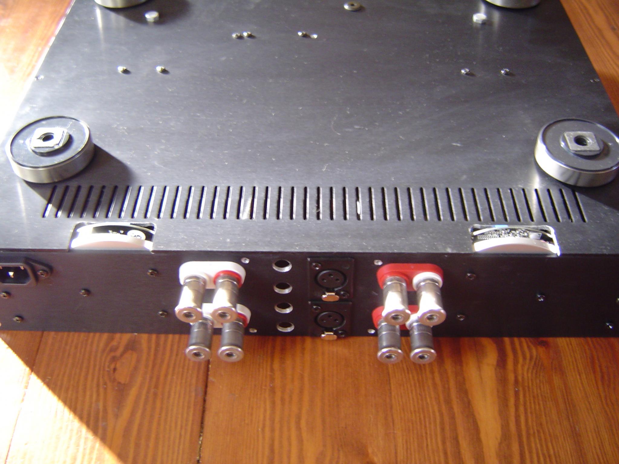

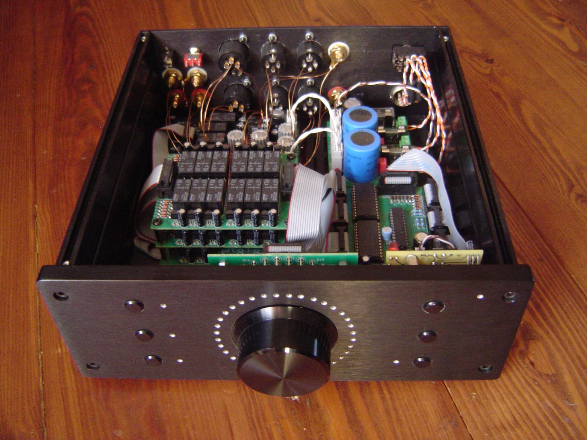

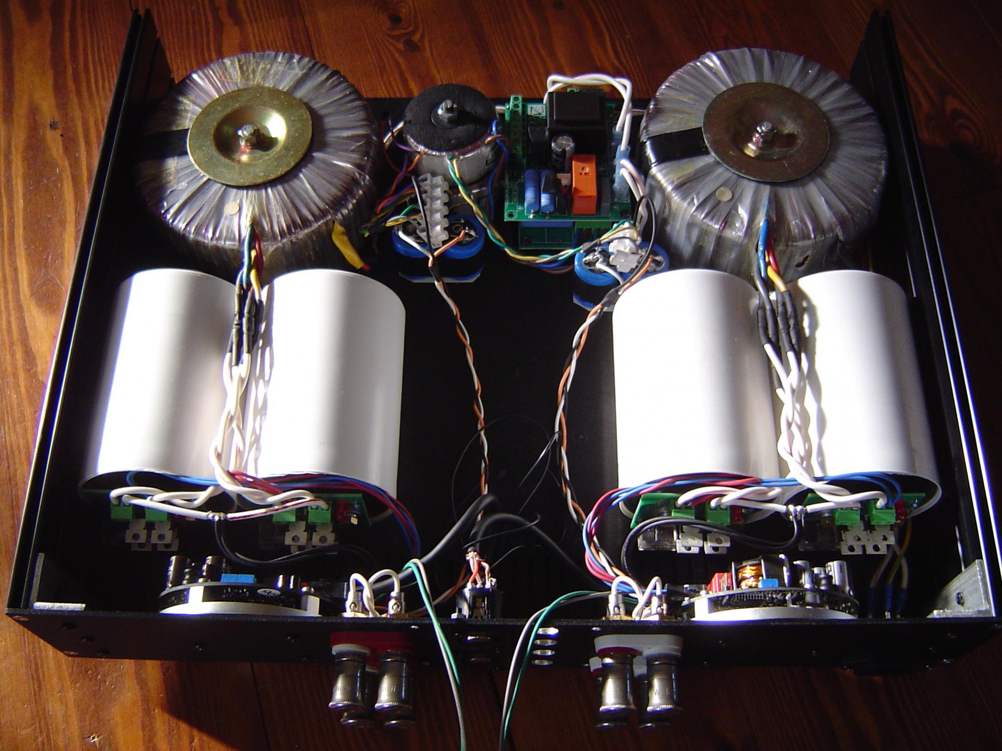

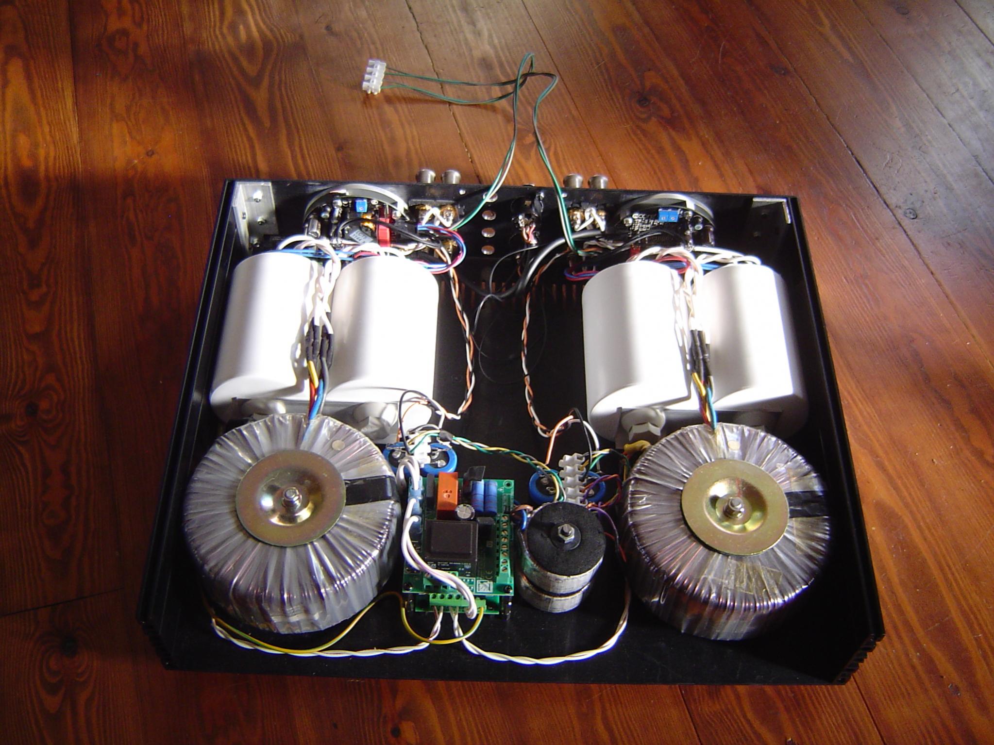

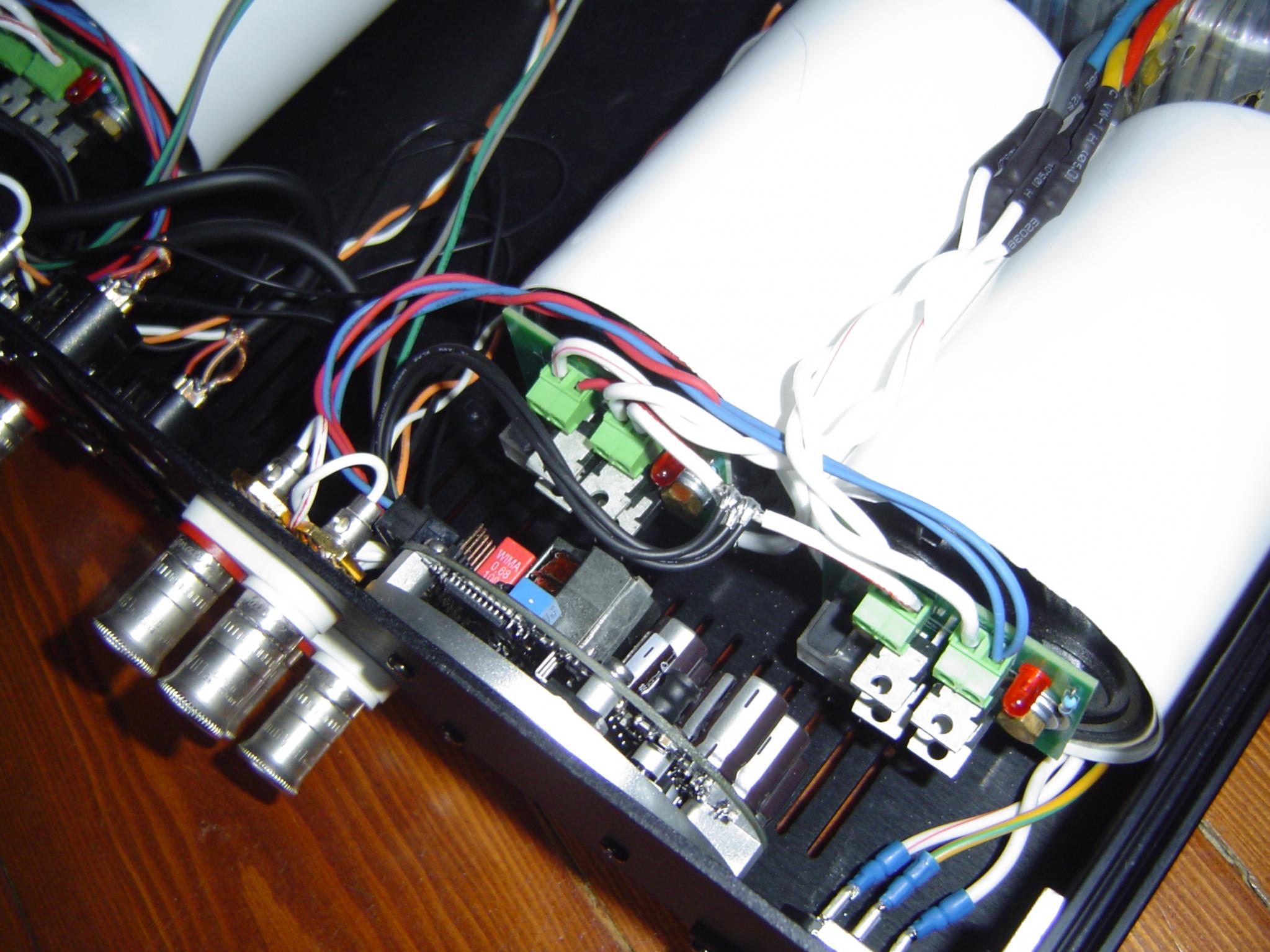

This is my NCore build so far;
It is temporarily rigged up as a power amplifier but will become an integrated.
The volume section will be a my own design pic controlled 32 step ‘balanced shunt attenuator’ with one relay per level (no combinations) as used in the preamp;
The stand alone preamp has buffer/gain stages based on TO99 op amps with my copy of Walt Jung’s Super Reg. The gain can be set with plug in resistors and is an equivalent design to the buffer front end of UCD, I was using it at 12db gain with four UCD180HG monos (with the on-board buffer stages by-passed) and at 0db gain more recently with the NCore. This buffer stage will not be necessary for the integrated NCore, Bruno has taken care of this.
As for sound quality the UCD180HGs perform exceptionally well bi-amping my KEF 205/2 speakers and were the best sounding amps I had heard in my set up until NCore..
