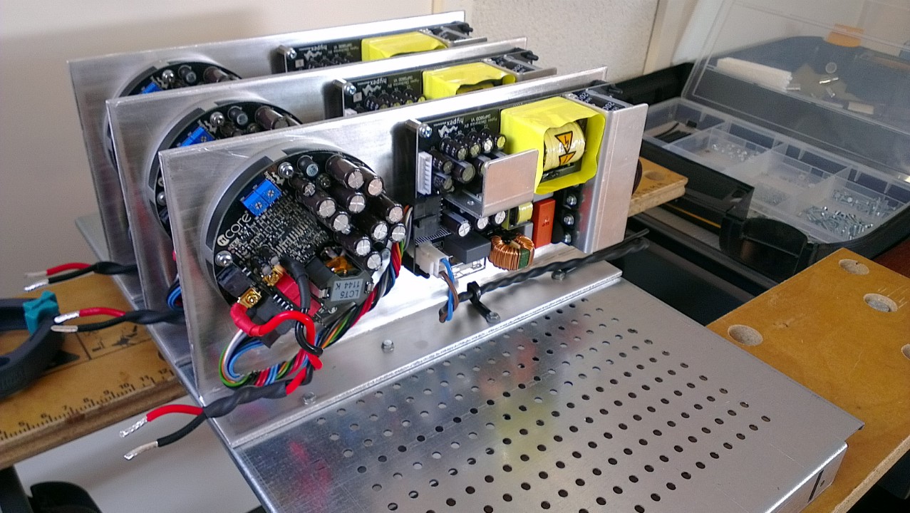

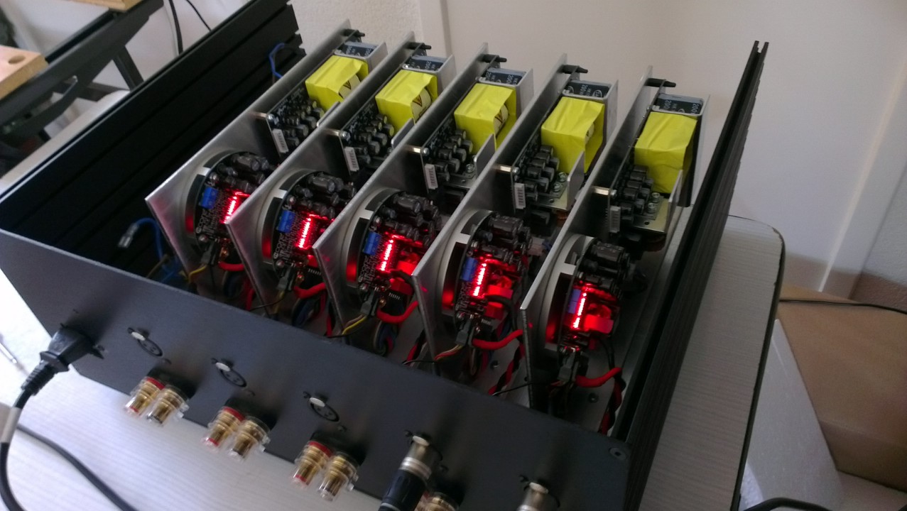

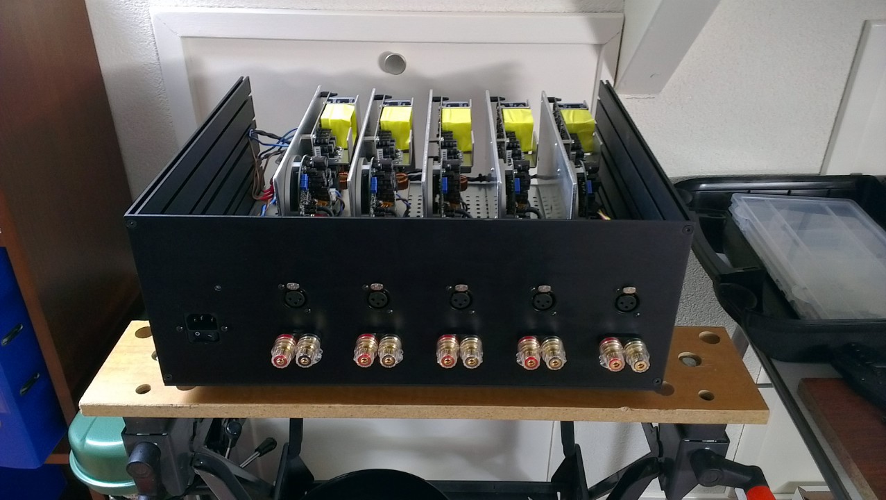

Antonio,
Did the boxes come pre-drilled ??? The right chassis appears to have better wire placements than the left chassis. The power lines do not cross the signal lines and are further apart.
No I had to drill them myself.
Yes I know, the right one has a cleaner layout. Given the specular costruction I couldn't replicate that layout on the left one. But in this way I get more order and simmetry on the shelf where the audio stuff is placed.

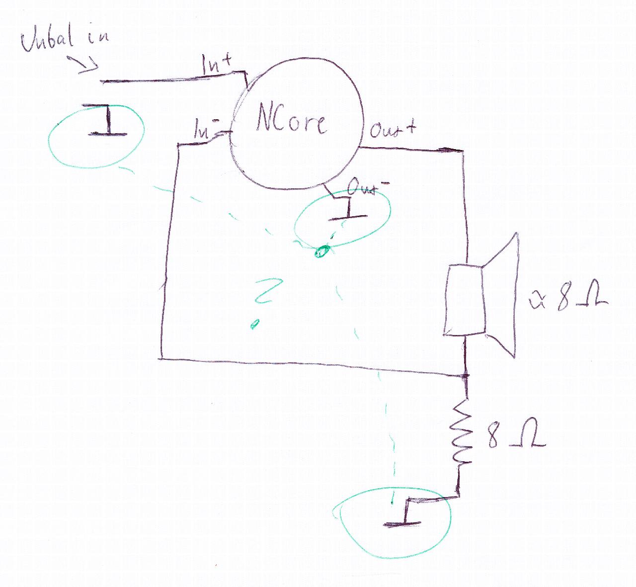

Now it's little me again... I have just placed back the gain resistors for current amp test... but I wonder if my connection scheme is OK or if it's wrong:
attachment.php
Is this how it is supposed to be, with all the green grounds connected or is something wrong?
If someone knowledgeable ( ideally Bruno ofc ) would give thumps up that it's ok and won't destroy the NCore or the speaker I promise I'll measure output impedance and do distortion sweeps on atleast one speaker to check how well it works in practice =)
