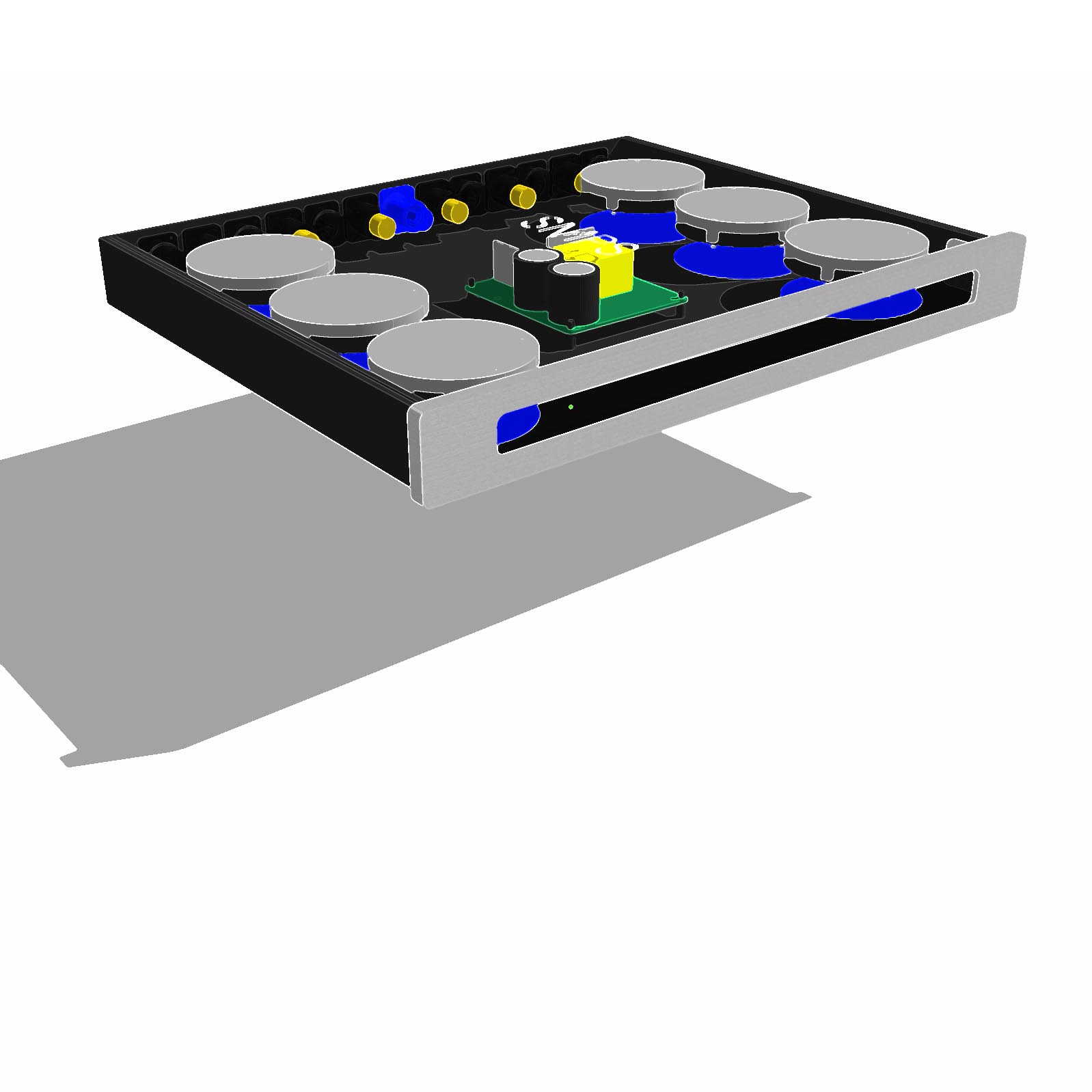

Hi all,
The discussion about enclosure seems to have died, but i did not.
- hifi2000/modushop enclosure, the slimline 01/350 (internal 415x350x40)
- 6x nCore (Linkwitzlab Orion) upside down for better cooling
- 1 or 2x smps400 (smps600 wont fit for its heigth)
- backside with all Neutrik Powercon/Speakon and jack/xlr connections
- modular front with changeable modable black plastic plate
What do you guys think?

Disabled Account
Joined 2008
If I could just follow-up on your question a bit.....what is the optimal amount of physical isolation for the SMPS 600 from the nCore modules? I noticed in the nCore 1200 prototypes things were packed fairly closely leading me to believe this is a not an area of sensitivity.
I asked this question here before, and the answer is you can place the two as close as you like.
