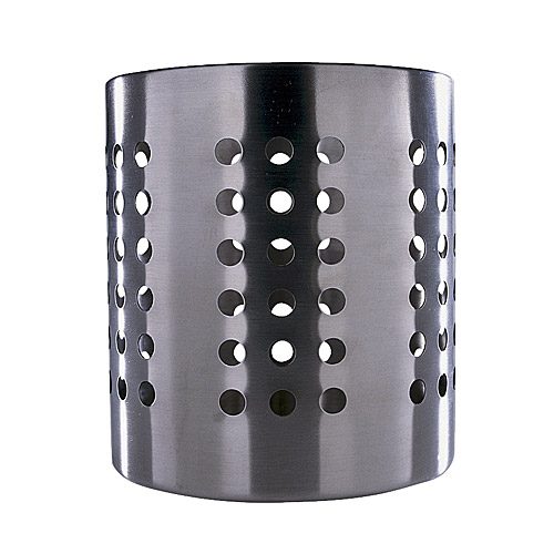

Audio Catalog how about a AL-299B case for the ncore monobloc of course, seems good value
Helloa every1....
What about this one from IKEA - stainless teel 12 cm dia/13,5 cm height!
Dress it with something to see through and with isolation on the bottom. Two pieces bolted together and one square for the PSU - or the PSU in 1 alone standing up/down.
A very FRUGAL solution and with some small adjustment/building can be really nice.
In Norway it costs about 39,- Norwegian kroner(that`s around 6 dollar).
Always someting that can be used - if one keep looking!;)

Sorry - it is not stainless
I think it is. There are different grades of stainless (304 & 316 to name two of them) and some of them will stain in a dishwasher with the caustic detergent they use
But I do like the imaginative use of alternative objects. I have in the past mounted a power amp in a biscuit/storage tin and a mini itx pc in a cut-down wooden bread bin :D
