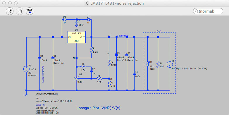

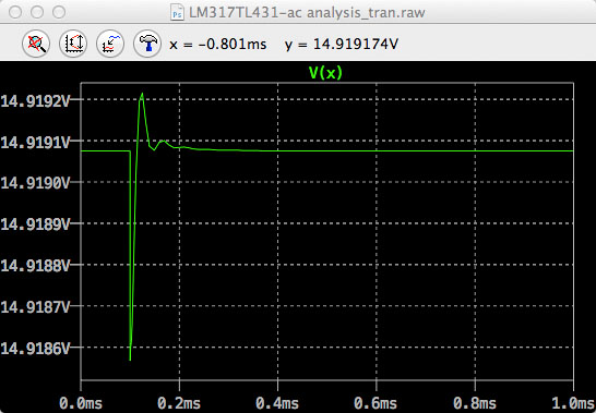

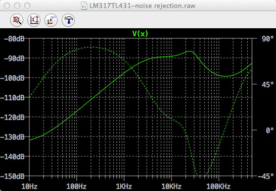

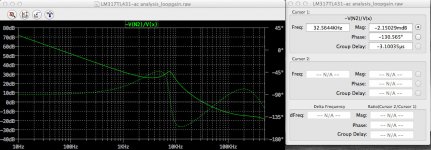

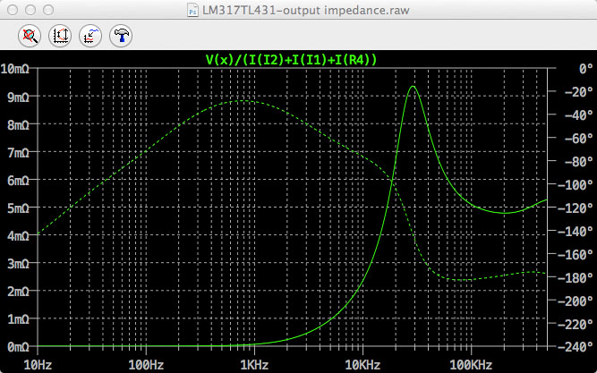

Ok I went back to the LM317+TL431 circuit and looked at all the aspects I had modelled in the other thread but this time with a target of 15V. It's a case of balancing variables to try to optimise things. I finally settled on the circuit values shown in the attachment below. I've also pasted graphs of the modelled open loop gain and phase analysis, PSRR, transient response and output impedance.
The values would seem to provide ok results to each albeit not as good as the 5V circuit. I'm sure there might be a smarter/easier way to optimises the factors affecting the feedback loop - if someone can improve on this I would like to hear it. The genesis of the discussion in the other thread was Fig. 23 from the TL431 datasheet and the question "what happens if we shift the resistor to the output of the LM317?"

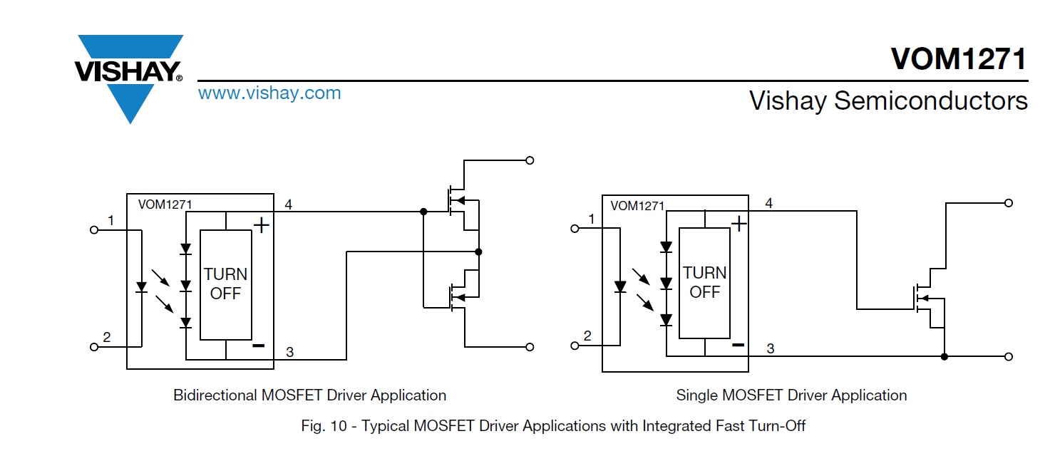

Bad news first , I'm afraid the output pins on the VOM are reversed as I read in another thread , Not 100% sure , but check it out . Vishay's drawing of the chip is a little confusing to me .
I triple checked it and you are absolutely right, I have to figure out something..
I'm will make a pin swap adapter as first aid
The adapter will use a piece of prototype board and 4 pins. VOM is rotated 90 degrees and the pins are connected to the psu board and jump wired to the correct pins of VOM. I'll draw a sketch later..
