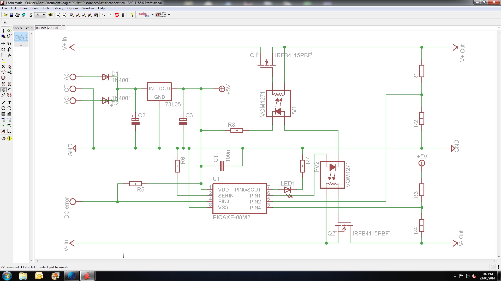

Hi Sami ,
Did some work today ,
Downloaded Eagle to draw some schematics and LTspice , need to get familiar with it again, cause I didn't use it for a long time .
Found some nice FET's IRFB4115PBF 150V 11 mOhm but have to check all the specs . The Picaxe chip needs 5 Volts low current , so a 78l05 regulator will do .
The PVI you mentioned is SMD , not a problem ?
Had some thoughts about the software for the PIC .
Would check for primary FET voltage first on startup , then check voltage after the FET's . If there is any , Fault condition, FET's are shorted . Blink LED
No voltage , open FET's ,check voltage , if OK go to DC fault loop , check for low signal on DC protect output on UCD , if so close FET's blink LED .
If you have any other thoughts let me know .

This sounds just right
I'm going to have an soft-start for big trafos and capacitors, so there could be a startup delay for couple of seconds to open the FETs.
SMD is not a problem
The soft start and delay can be handled by the picaxe as well very flexible and programmable . Would be good , to control the soft start by the Pic , so it could also disconnect the start relay when a FET is diagnosed to be shorted .
The AUX power supply for the pic should be always on for most program options ( after the power switch )

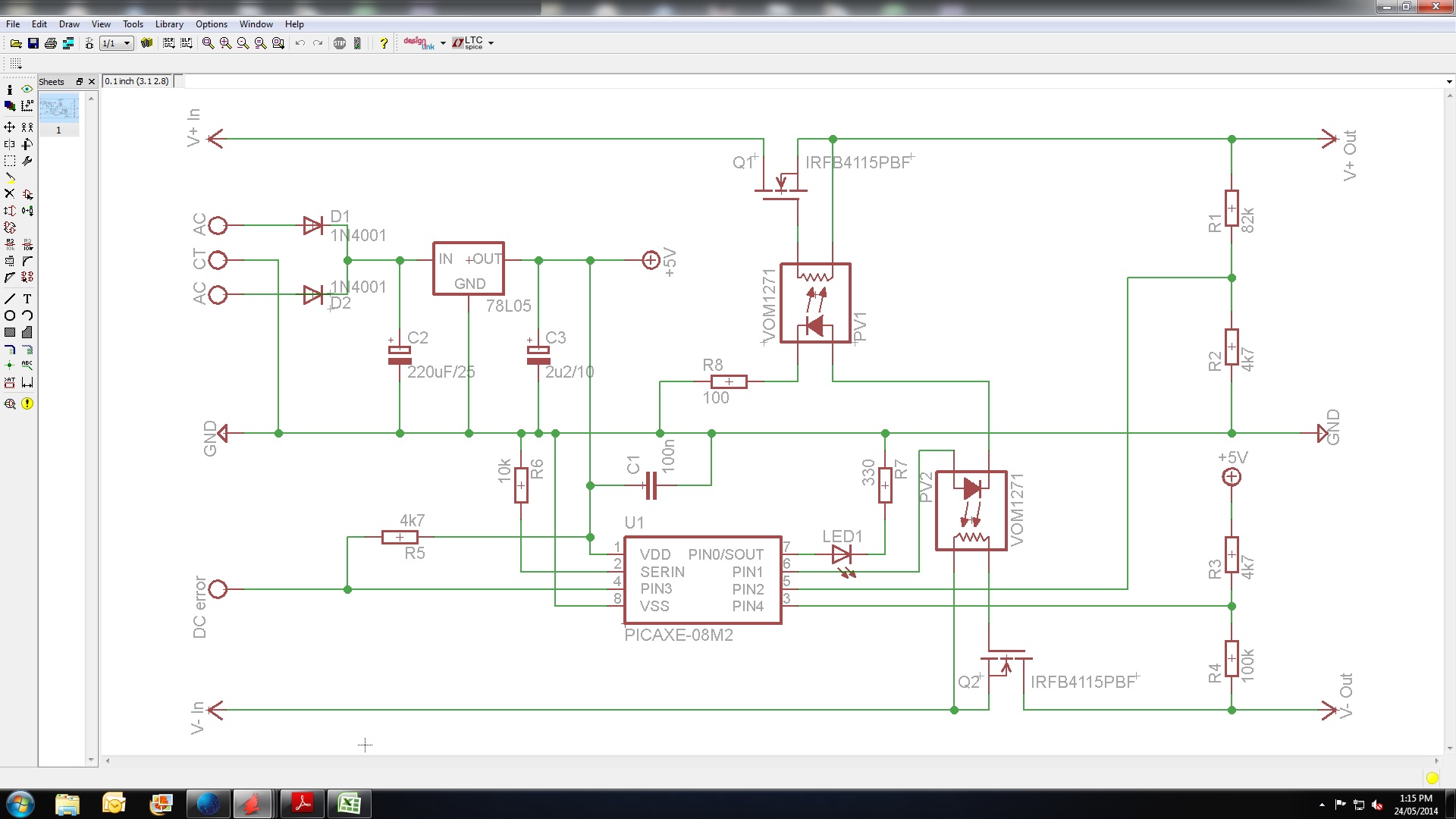

This schematic should do the trick .
Could not find a PV symbol in Eagle ( Which one did you use ?), but think this is clear enough .
Did not have enough pins to serve the soft start , but think there are plenty available out there .
The picaxe senses the DC error signal and the positive and negative rail for FET failure .
Will calculate the values the coming days for the different UCD's and write some code as we discussed before and test the circuit .

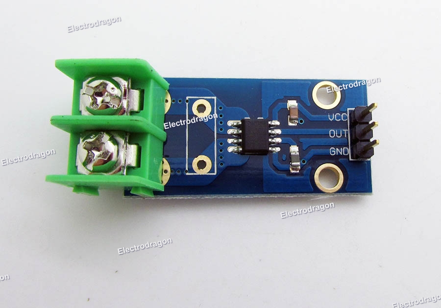

For the over current protection , the ACS712 current sensors can be implemented in the schematic instead of the resistor network on the output voltage , in series with the FET's . They have a Max resistance of 1.5 mOhms!
and produce 66mV per ampere , easy measurable with the picaxe .
Only problem could be the picaxe's speed ( due to it's build in Basic interpreter ), running at 32Mhz it will take about halve a millisecond to detect over current . Fast enough ?
Can post schematic if anybody is interested .

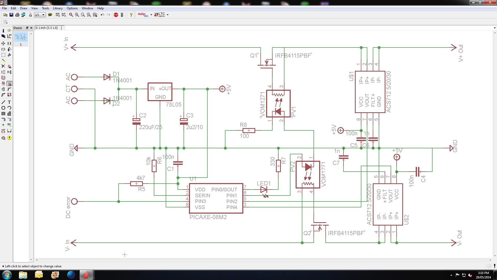

FAst turn off at DC and overcurrent protection
ADC and buffer are all in the PIC . Firmware is just a couple of lines basic code .
The attached schematic shows the ACS712, available in 5 , 20 and 30Amps version .
