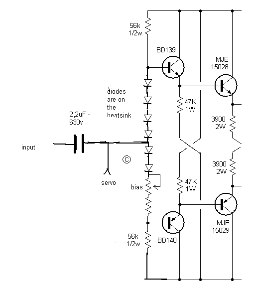

Thank you to everybody!
The tubes stage as I said is a principle schematic. In the reality, there are:
- relay switching the output to ground since the DC = 0 and that works if any kind of problem (f.ex. absence of mains) occurs
- three different power for the tubes stage
- a servo circuit that help the output to be very close to 0 volt DC
So no problem for the tubes stage! It's save enough, and deliver only signal - NO DC - .
There is another delay circuit that swich on the SS stage after the tube stage is on (around 1 minute) and DC = 0.
So no problem.
There is a servo also on the SS stage for the DC voltage at output. But this is always slow (around 200mV) also without servo.
So my problem (I don't know if it could be solved, anyway) still remain.
Now I'm entring on point C on my ciruit, and everything works fine.
BUT, I would like to not pass throug diodes, and enter straigh to points A and B
(maybe using another or two BJT, with NO voltage amplification, seen that is gave exclusively by the tubes stage)
Otherwise the tube stage could be more simple and I could use two capacitor (around 2 uF) starting from the same point and entering on same time on points A and B. I know already...
Thank you, and if you could write a little schematic about...
Best wishes!

Gianmaria, you will need to disable the BJT stage servo as this will no longer be needed for a DC connection between the stages, but the input of the tube side servo needs to be connected to the output of the BJT stage, since that is where you really want 0V DC.

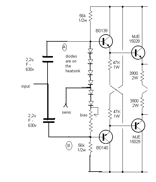

Regarding avoiding the diodes - you have to provide an AC path that bypasses them. There is really no simpler way to do this except to put two capacitors, one between points A and C, and one between B and C.

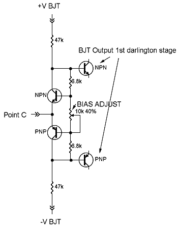

You could also, assuming you reconnect the tube end DC servo input from the BJT stage output, forget anbout point C and put a single capacitor across A and B, and input the signal from the tube stage at either A or B. The DC servo will take care that the output of the tube stage goes 3x Vbe + or - (depending on wether you use point A or B as inputs), in order for the BJT stage output to be at 0V DC. Even if the bias chain (between A and B) was put in circuit with the cathode current of you pentode (then you do not need extra resistors to = and - rail of the BJT stage), you would still need a capacitor between A and B. You could replace the diodes with a VBE multiplier - the standard circuit used to generate bias on many amps via a small transistor mounted on the heatsink with them - but even that would need a capacitor across the equivalent of points A and B as it is also a 'sort of' diode.
Finally, you could use something like the circuit I am attaching - but this circuit is really an amplifier strapped for unity gain, so you again either need caps across the 6.8k resistors (and even that is not a very good solution), or across the C/E of both the bias adjust transistors, or you risk HF instability. The lefthand side BJTs are small signal and in thermal contact with the heatsink. To be honest I would rather use a regular Vbe multiplier bypassed by a cap than this circuit.

Dear ilimzn, all,
thank you for your detailed explanation and for your schematic!
The point is clearer to me now.
Everything was born from some experiences:
I noticed very clearly and without any doubt, that the sound has got an improvement (is more neutral, clear, controlled) if (with exactly the same schematic BJT stage and Tubes stage), I entered to point A and B (of course with two capacitors), instead of point C (without capacitor or with one capacitor, exactly the same type I used when entered to points A and B).
So if I have to use the two capacitors on poits A and B, that is seems to be - at the end - the best solution, I would go to change the tubes stage to a simplest one.
My request was to try, with the schematic I gave, to have (as in origin entered on point C) STILL a copletely DC coupled amplifier.
Infact I don't need anymore the big complexity of the power supply, of the servo etc... only to avoid the output caps...
I can very much easily use a SRPP followed by a cathode follower (to lower at maximum possible the output impedence) with two capacitor of 1,5 or 2,2 uF and entering points A and B.
Of course the problem now will be direct to the technology of the two coupling capacitors and I can assure you that the differences between a polipropylen and a paper in oil, is clearly evident and are not dreams...
Very good high frequencies of the paper in oil but a little confused bass, exactly the contrary for the poliprop who has got a very detailed and clear bass freq but is very "sparkly" and disturbing on the high freq...
Dear Ilimzn, all, have you any comment on these consideration?
Thank you so much, regards, G.M.

gianmaria said:My request and my intention was to try, modifyingwith the schematic I gave, STILL to have a copletely DC coupled amplifier also without enetered on point C.
Yes, i understood that. But even so, you cannot avoid AC currents passing through the diode string. The reason you can hear a marked difference when they do is that the dynamic resistance of the diodes is fairly high because a relatively low DC current is passing through them (<1mA) and, with AC signal, is not even nearly constant. This is something that you will not see with coupling caps as they will essentially be in series for AC signals, across point A and B. A capacitor between points A and B would be necessary either way, to give the AC currents a low and more linear impedance. It's just that with two caps from the tube stage to points A and B, you get a cap across points A and B 'for free'.
The situation above could be improved by replacing the resistors to + and - SS suply rails with current sources. If nothing else, you could use dual bootstrapping from the output (since your output stage has voltage gain = 1). This would effectively increase the input impedance of the SS stage as seen by the tubes, which will mean better performance from your caps, but it also requires two more caps (lower voltage), fortunately, these have a far lower influence on sound than the coupler caps.
Another possibility, that requires DC coupling with the tubes, and therefore:
1) Dual power supplies for the tubes
2) -B for tubes carefully filtered and quality cap decoupled to GND
3) DC servo for the whole amp
4) Startup and DC protection via relais or similar
...would be to put the diodes and pot (vith adjusted values) in circuit with the Rk of the tube follower. Point A would connect to it's cathode, point B to the cathode resistors. You MUST use a quality cap between A and B still to prevent diodes from passing AC current (it will go through cap instead). The cap only sees a small voltage (about 3.4 V) so the choice of caps is much wider.
The resulting amp would not have a point C but would be DC coupled and would avoid the problem of low current through diodes and hence high rd of the diodes and associated distortion for LF, while the C in paralel with diodes takes care of HF.
Apart from that, you are back to AC coupling, and simplified stages. You will probably still need a DC servo for the SS stage.

In answer to your original question as how to get rid of the diodes, this is called a diamond buffer:

I keep finding that A Ciuffoli's designs are full of assumptions which very seldomly hold true.
In his diamond buffer, the bias current depends (quite heavily) on the rail voltages, and by what divine providence he guarantees the idle current to be 'optimal class AB' remains a mystery. It is also HARDLY a never before seen design. Even Walt Jung that is often credited with it, does not credit himself with coming up with the design.
A diamond buffer would be a good idea, but for it to work properly at high power, it requires the first stage to be fed from supply rails via current sources - this insures non-switching operation of the first stage if the source current is properly chosen. With current sources, the two parallel capacitors will either not be needed at all or could be replaced by one of vastly smaller capacitance.
Regarding the Threshold, it uses a CFP pair with multiple second stage - nothing new there either. CFPs can be used instead of the output BJTs in the diamond buffer, keeping in mind that one CFP (with all it's resistors) replaces a single BJT in the diamond buffer, WITHOUT it's emitter resistor.
Using a CFP has the advantage of a shallower and wider gm 'notch' at crossover. However, because of the above, you effectively have two Re per side in series (0.18 ohm in AC's diagram) in order to get stable bias current AND current sharing, one in every emitter of the power BJTs (final stage) and another one in the 'effective' emitter of the CFP (connection of emitter of first and collector of second stage of the CFP).
The typical cookbook approach for thermally stabilising a CFP by (in this case) putting the first stage of the buffer on the same heatsink as the first stage of the CFP does not assure proper thermal tracking and absence of runaway! With dual Re's, all transistors on the same heatsink, it will work - but you will have some power loss due to the double Re's compared to simple emitter follower.
You're the one that asked for a single drive point without diodes, the diamond circuit does that.
"With current sources, the two parallel capacitors will either not be needed at all or could be replaced by one of vastly smaller capacitance."
Without the caps the output stage is very limited in current unless you bias it fully into class A. With the caps it can move into class AB.
The current sources should be constructed with a diode connected transistor as the voltage reference. This diode should then be thermally linked to the outputs. As the outputs heat up so will the diode, and thus decrease the reference voltage for the current sources.
You can get the basic idea from the LC End Millenium or the Hawk A18 as part of the DC servo design they have. At this point the Threshold CFP output stage could be used, and it would have less drop from the rail than a triple EF.
djk said:You're the one that asked for a single drive point without diodes, the diamond circuit does that.
No, it wasn't me, it was Gianmaria. I would have used a different topology with the bias chain in the cathode circuit of the follower.
Without the caps the output stage is very limited in current unless you bias it fully into class A. With the caps it can move into class AB."With current sources, the two parallel capacitors will either not be needed at all or could be replaced by one of vastly smaller capacitance."
The caps need to be there to bootstrap the bias voltage otherwise the current available to turn on the output BJTs lowers as the output voltage increases, at some point the output BJTs will current-limit the output. In class A, this point would be for input voltages equal to power rails or more, but since the point is defined by load current, even that would not insure proper operation if complex loads were used.
It would also have been possible to bootstrap the second stage from it's output, this would also create virtual current sources to it's bases, as well as avoid problems with hard cap discharge at clipping (see below).
This was precisely why I said that if current sources were used instead of the 10W resistors, this would not be a problem (and less heat would be generated).
The advantage of the capacitors is that the voltage at the output stage bases can swing higher than the power rails, resulting in lower losses - up to the point of saturation of a driver transistor, which will at that point clam the input signal by forward biasing it's CB junction.
You pay for that by having to pass audio current through an electrolytic cap, as well as some other considerations at clipping.
Alternatively a two-transistor source can be used, the BJT with the sensing resistor between B and E should be on the heatsink.
Actually, that is not a given. Combining a diamond buffer and CFP for good thermal stability requires extra emitter resistors, so you get a bit more loss at full output current. That is, comparing to the original diamond buffer. For tripple EF, you get the drop at the final Re + 2x Vbe - you can drive the first stage of the EF to satuiration since one Vbe extra over it's supply rails is not a problem for the tube driving stage.
On the Diamond buffer, you have to rely on bootstrapping (capacitors in AC's diagram) or provide higher supply rails and current sources from them, to the first stage of the buffer - the driver for the buffer can't do a thing here. Even with bootstrapping, you only get the bias voltage to shift up over the supply rail, and that's approximately 2x Vbe. Increasing driver voltage will do nothing as the CB junction of the first diamond buffer stage becomes forward biassed and clamps the input voltage. Assuming ideal output BJTs, 1xVbe over rail voltage will saturate the output transistor. Anything over that will be fed into the rail and output, and will partially discharge the large capacitors, through forward biassed BC and BE junctions of the output BJT, and through the driver BJT - this will be a large amount of current, though limited by the base current available to the first stage BJT. The bigger problem is the discharge of the caps, which means that for some time later the bufer will be unbderbiassed, and produce distortion. The rail loss of the stage will equal output BJT saturation loss plus voltage drop on an equivalent of 0.18/3 ohm, resistor.
Things become more complex for a CFP used as the second stage of the diamond buffer. The CFP current starves it's output transistors exactly at saturation, at Vc = Vb, assuming zero saturation voltage on the first stage of the CFP. Thius is helpful for clipping recovery, but implies you have 1 x Vbe loss by default. You also have one effective 0.06 ohm Re for the second stage of the CFP (0.18/3) for current sharing and one more in place of the 0.18/3 that would be found in the simple 2-stage implementation of the diamond buffer - without this, there would be no thermal stability. The rail loss equals voltage drop on the two equivalent Re's, i.e. Iout x (0.12), plus 1 x Vbe. For this, the input voltage to the CFP needs to be Iout x 0.06 + Vbe + Vout, i.e. Iout x 0.06 below the power rail. In this case the bootstrap experiences potentially more severe discharge as anything over that voltage discharges the large caps through the driver of the CFP and one 0.06 ohm Re, and the driver of the diamond buffer. Again, the current is limited by the base current available to the first stage of the diamond buffer, but the cap can discharge lower, and for very high output currents, even charge in reverse. So, the output stage can theoretically slip into class B or even slightly into class C for a short while.
So, comparing all three, you get (Vre = voltage on Re):
2 x Vbe + Vre for EF
Vre for straight diamond buffer
2 x Vre + Vbe for CFP diamond buffer,
Keeping in mind that diamond buffers may become underbiassed for a short while after clipping severely.
The straight diamond buffer has smallest losses but lowest current gain, and is reasonably easy to stabilise thermally.
The CFP diamond buffer leads over the EF as long as Vre < Vbe, but has high current gain and smoothest transfer curve, but can be difficult to stabilise thermally (T versus Ibies is a complex function).
The EF has high gain but is less linear than the CFP diamond buffer, but is dead easy to stabilise thermally, and does not have problems at clipping, but may not have a single signal entry point.
As far as coupling goes, it should be noted that all of these need some sort of capacitor somewhere, even when DC coupled to the tube stage. For both diamond buffers, this will be the cap between bases of the output stage (either single BJT or CFP). Straight diamond buffer needs large caps, CFP diamond buffer and EF need small caps. ALL would benefit from current sources to provide input biassing current, instead of simple resistors off of the supply rails, which may relax the requirement of the caps. In the case of the EF, the current source may be provided by the circuit in the last stage of the tube driver, if DC coupling is used, the diamond buffers do not have that option.
Let me just finish off that in my own design I intend on using MOSFETs, which largely removes all problems with rail loss, leaving the source follower as the most logical configuration.
Hi!
Please remind my two circuits...
The differences entered to point A and B (join file BJT2) and entering on point C (file BJT1), with exactly the same conditions, circuits etc., will be not only very clear when you listen, but will be also different at mesurements.
Infact using Spectralab, FFT analisys, in the same conditions as I repeat, I obtained the following results:
- with the "BJT 2" we have at 10 volt rms output (on 8 OHm resistive), around 0,1% THD+N with 2nd armonic predominant on 3rd armonic.
- With the "BJT 1" we have THD+N 0,07% with 3rd armonic predominant (also at 10 volt rms output on 8 OHM resistive)!
ONLY BECAUSE THE SIGNAL PASS or NOT PASS THROUGH DIODES!!
Ilimzn (thank you) has already explained why there are the motivations... but I couldn't belive to my ears.
I repeat I try many time the experiences to be sure, and always the same result.

Gianmaria, you may want to try three things:
1) Try using two caps as in BJT2, on BJT1, but in parallel coming into point C. This way you get the same coupling for both cases. his will probably reduce distortion but only by a negligible amount.
2) reduce 56k from supply rails to 27 or 22k, also re-adjust the bias (with the same setting of the pot it will be higher for 22k or 27k resistors), on BJT1. You would now need 2x the capacitance of the coupling cap for equal LF response, try it if you have the larger cap.
3) Add two caps (0.47 - 2.2u or even more, low voltage is OK as there are only a few V there) between points A and C, and B and C on BJT1. With these caps, BJT1 should behave like BJT2. Of course, you now have 2 more caps, but they can be low voltage, and you can optimize the single HV coupling cap from the tube stage on it's own.
Still, i think BJT2 is the simplest...
