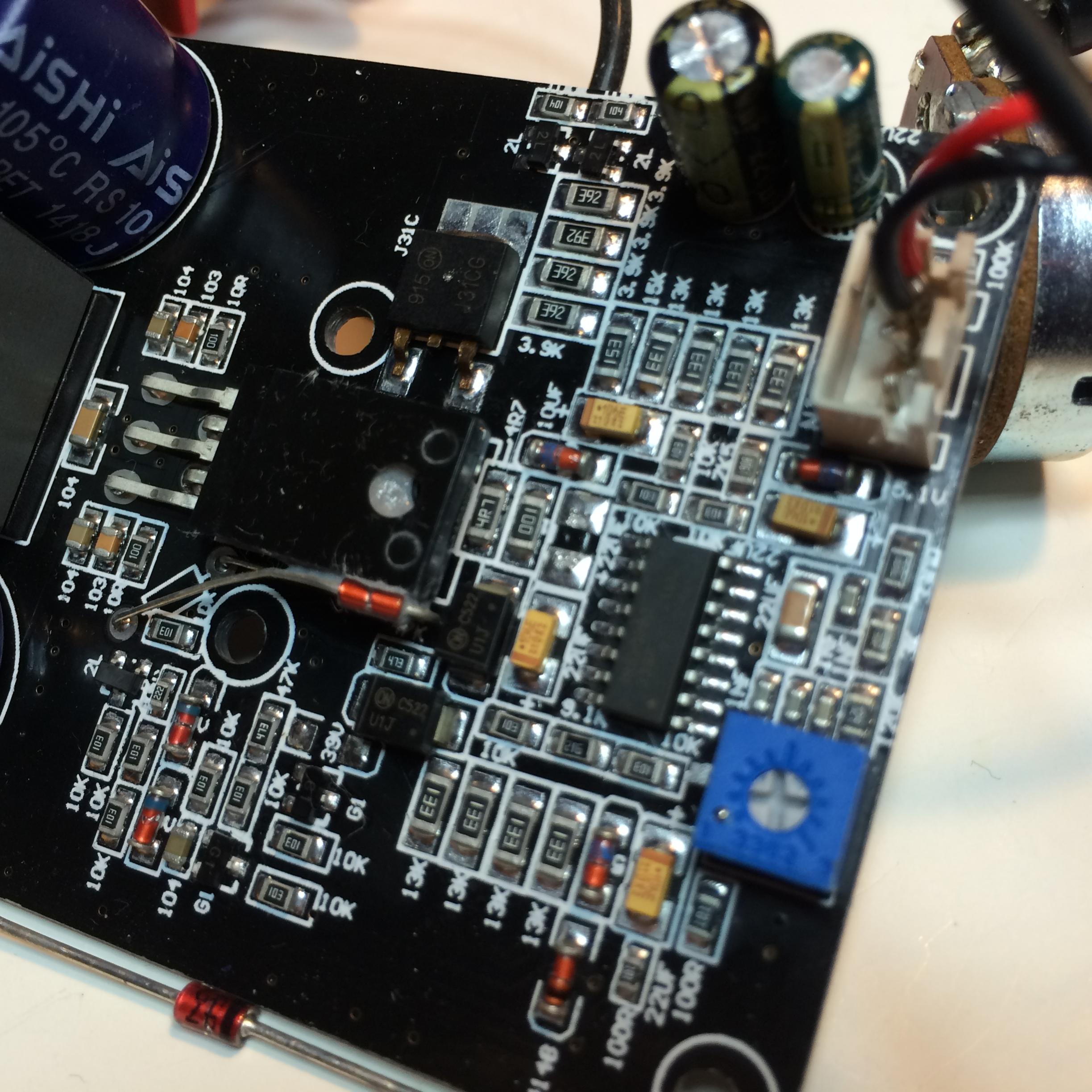

So having an excellent valve-fet pre-amp driver and in a hurry; I broke open my sample box of class-d Asia YJ modules.
fortunately I'm very familiar with the TI and IR class D families.
The YJ "200" watt module is very compact , so far no reliability issues.
I ordered some more today from different sellers for lot comparision.
Changed some smt componets to match my supply no problem.
I will run in 50W and 10W configurations.
Definetly will reduce the gain. No clipping in final section allowed.
So we'll see.
Right now the last posted .61 schematic is current.
here is pic with heat sink removed.
here is yj link but is sold for $ 16-24 qty 1.

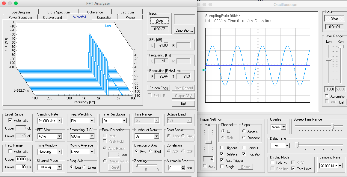

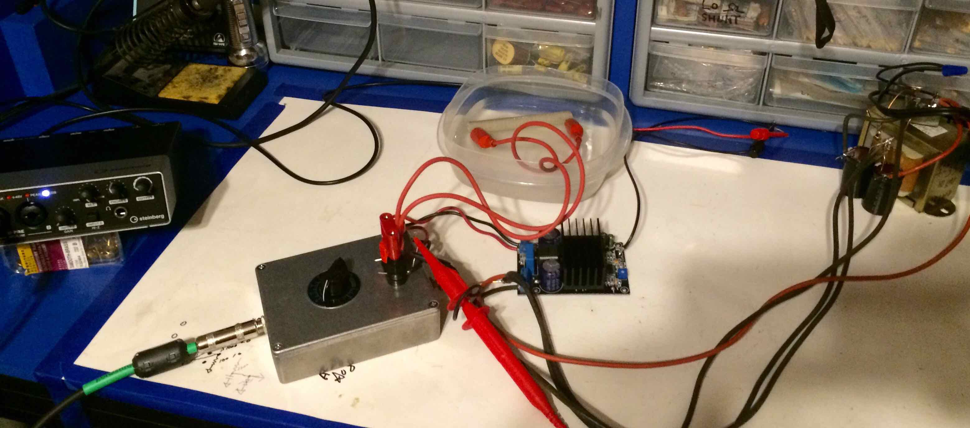

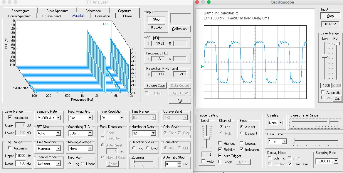

another update
Have the class-d setup for high power real time analyzing. Threw together a pad/filter box with overload protect to the sound card UR22.
I reduced the gain of power module to 4 so that the hybrid pre can really sing loud.
Now moving back to the 12AU7/fet pre.
pic of some testing, plots. Note these are at low power , the UR22 cannot really output high line levels.

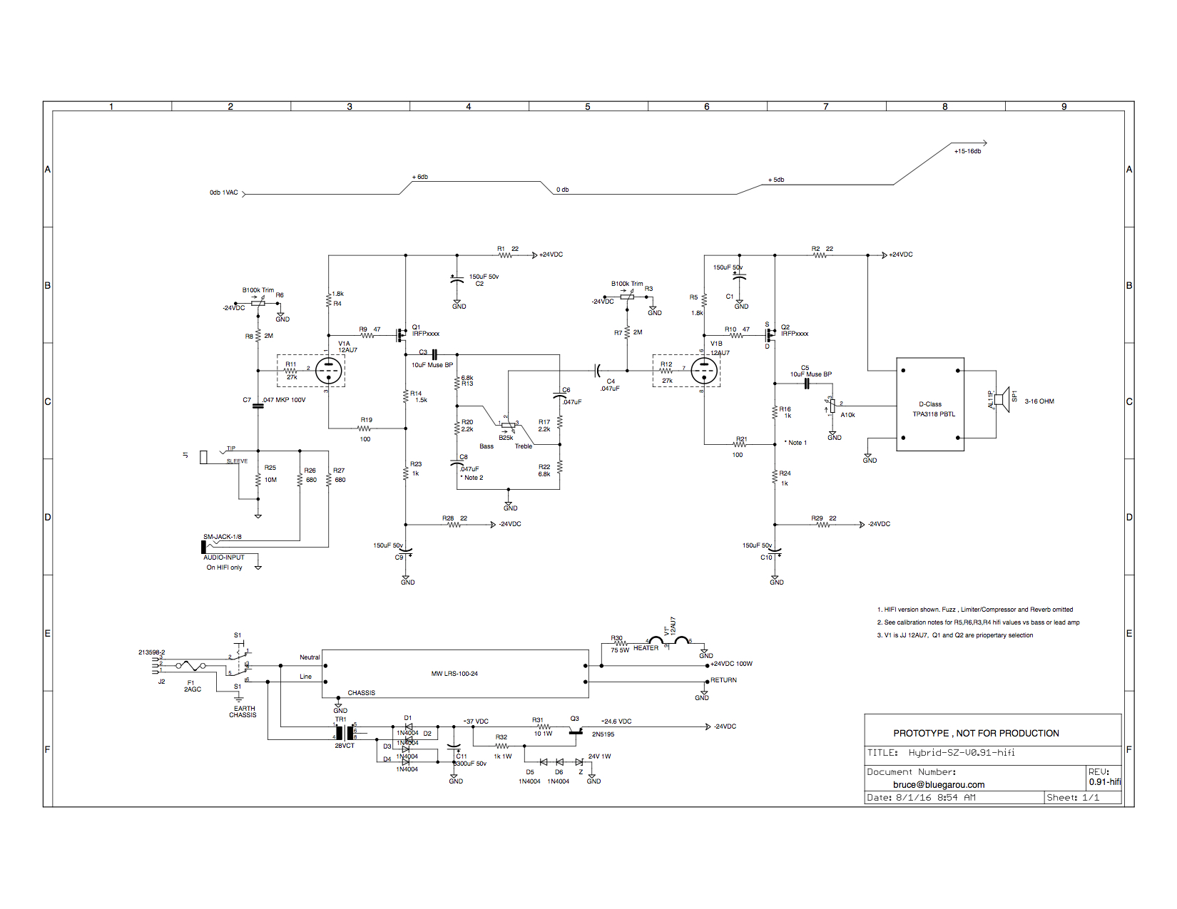

what does the final schematic look like?
i'll put something together, bits and pieces are all over diyaudio.
Its spread out because no hybrid section.

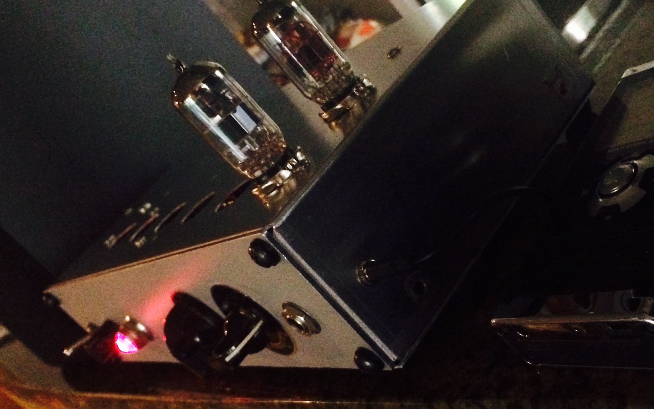

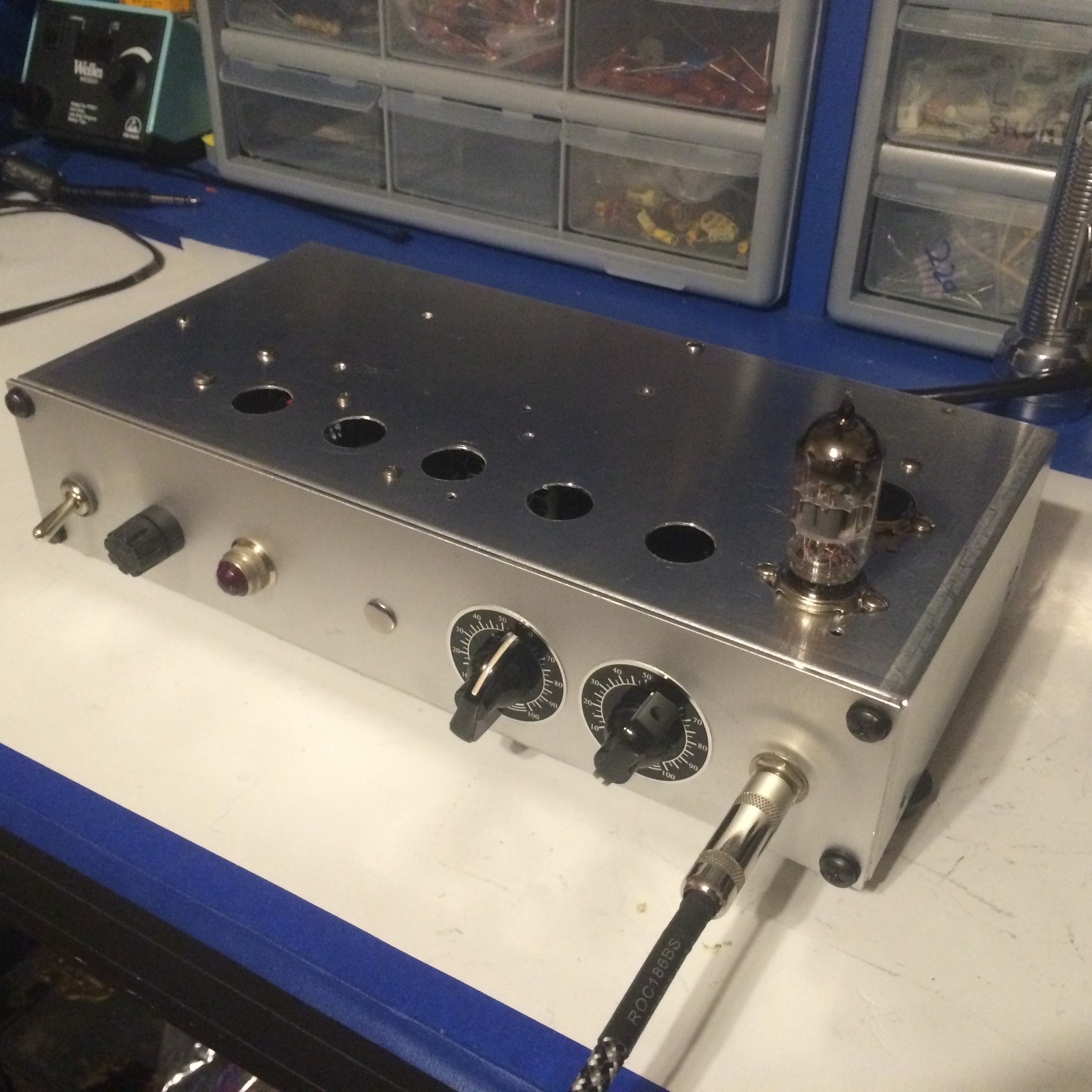

Ran with fat Telecaster sweet. humbuckers did not run out of headroom.
Running in hifi mode now. driving two uniQ Kefs in parallel 3 ohm z.
Red Fang 8 ohm with Telecaster.
Added a S2M 1/8" jack near 1/4" input. Of course cant have iRiver and Tele pluged same time.
V0.91-HIFI
I'll put up the hifi version here. Its been a lot of fun, used many different bookshelf type speakers , the Kef's were best.
I'm cutting off the share here, music instrument version will keep closed.
This schematic works super with values shown , avoids clipping even with a high input line level.
Bruce
