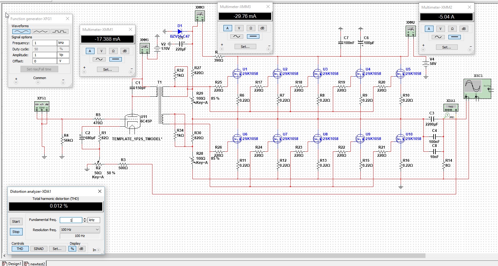

Hi
just test and see what it does, it do work nicely.
Now I go on with my own, otherwise I get time shortnesses. or who do I write this
regards
Really nice results !
only few remarks ,
- R1 need to be around max 82R , and C2 around 680uF , in the same time Rfb trim pot R2 need to be with ten time smaller value(50R max or lower) since R2=500R@50% will be upset way to much optimum bias point of 6C45P tube , which is when DC voltage on cathode is around 2VDC or Ia ~30mA ,
and yes Rfb (R3)in that case need to be lowered to around 500R ,
-this few modification results in significant lowered impedance of current GNFB loop which is good effect ,
- R4 need to be around 56K max , with 470K 6C45P will oscillate somewhere in UHF band ,
- output coupling cap value need to be raised on let`s say 10KuF at least for really good bass spectrum response ,
all in all I think that we are now very close to one very good sounding A class amp

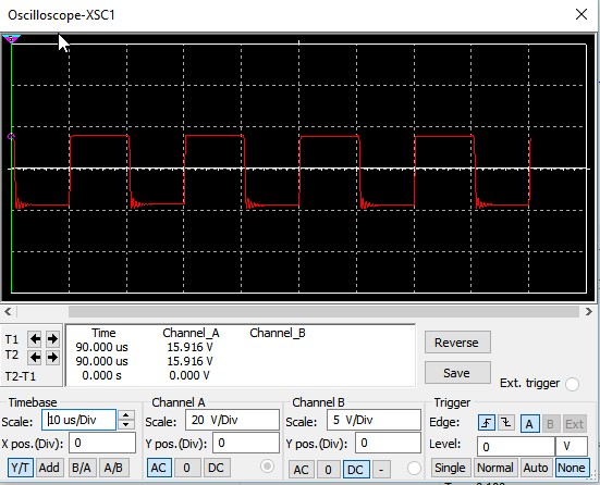

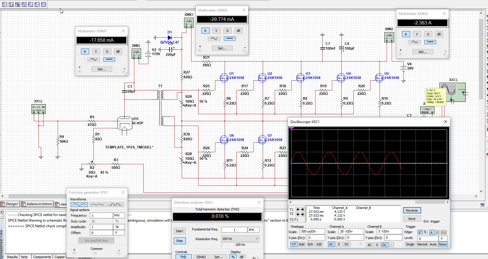

I have corrected all, it was because models are not always oke, but find a better one and these looks oke, have 17 mA with the resistors you mention, the feedback is changed, it is current feedback so low value is oke, until dissipation gets high, but with 500 ohm and 50 ohm it stays in borders, amp is not so high voltage, but has big current, so 2 ohm spekaers can also be connected?..

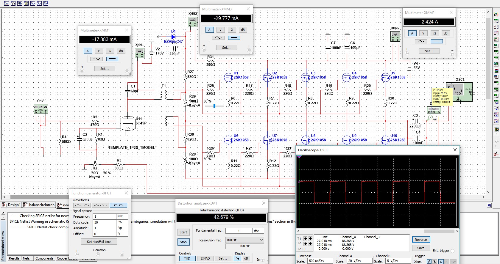

why is the big cap needed on tube? without it do also fine and little lower distortion, special in low frequenty part, the cap do make setup of idle in a slower way as sim let see, not a problem because you have cap in output.
the cap of 100 P on the transformer give in sim a ringing in negative square, without it do much better.
Did squares, these do nicely for a transformer. I have done measurements with a idel current of 2 amps for all fets.
regards

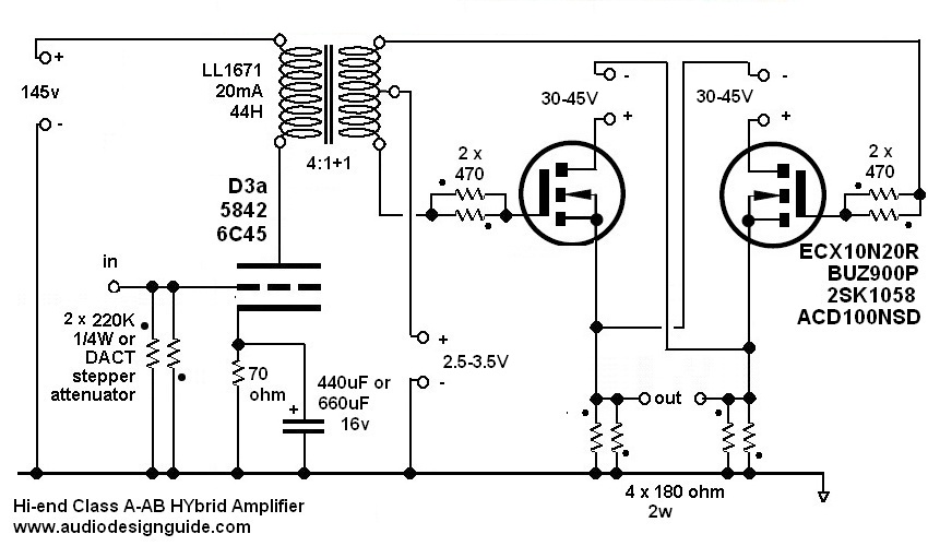

- Of course that nominal 2 ohms LS can be connected , special in case when we have SEPP-OPS which consist of 5 pairs of K1058 connected in parallel ,
- that cathode cap need to be there just to get maximum gain from 6C45P tube , without that cap tube driver distortion will go down because of local cathode NFb but the gain will go down to ,
- parallel 100pF cap is needed there against HF oscillation which very high gain (~52 ) 6C45P triode tube sometime have trend , but also introduce HF roll of,
any way you can try there with some smaller value cap as 82p or 68p but not less than 47p ,
-also I think that you can raise the SEPP-OPS idle current at let`s say 5A , and in that way to get more A class operation region ,that will introduce static dissipation per each K1058 device of around 29,5W which is OK SOA wise .

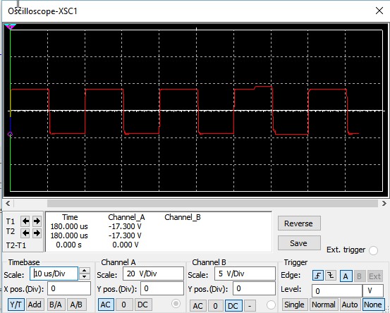

Hi
I have not a signal it do go lower in amplitude when remove the cap, it has a little more distortion when remove it.
these amp can sound nice, special because the harmonic content seems to even ones who are more present.
here some tests, and now I presume, you go build it and shake joegoslavia on his ground.

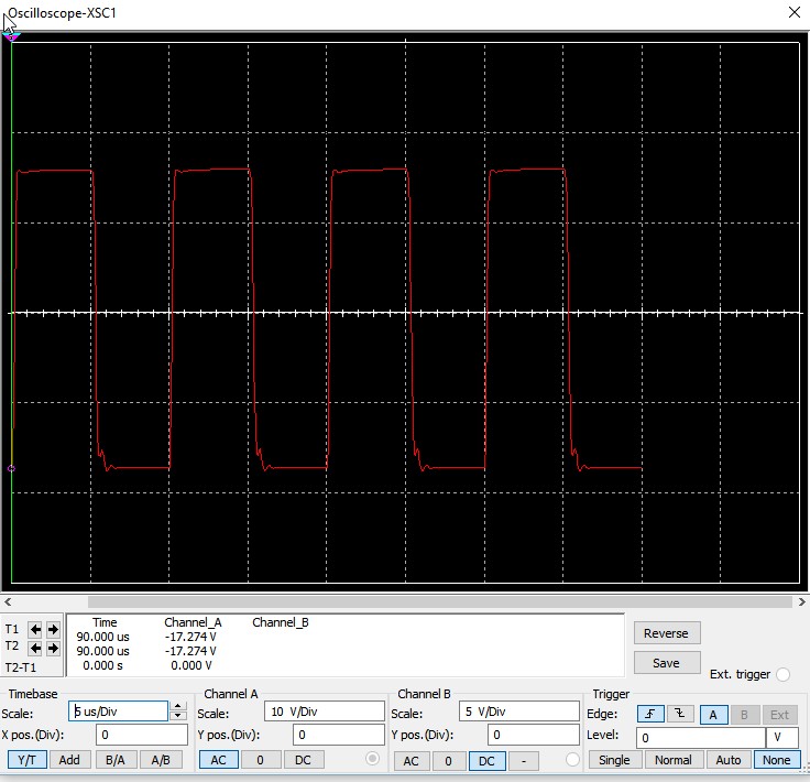

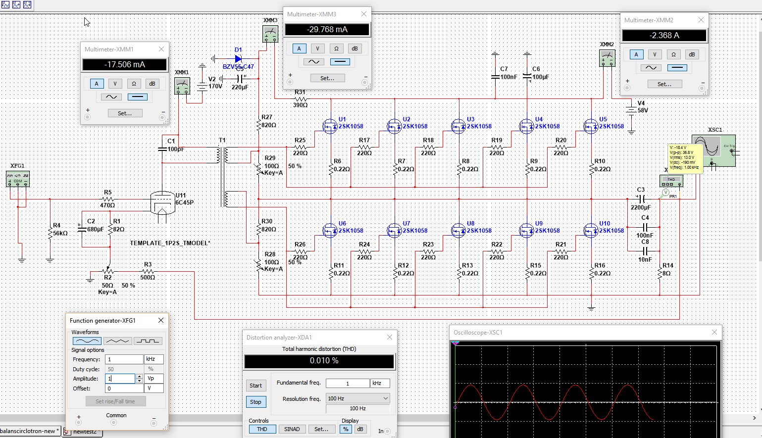

Oke some put extra, resistors over the transformer output damping ringing on HF, and need expermenting how big she need, sim is not 100 procent accurate.
cap is 150 pF, this do make 100 Khz square free of overshoot, this is not very good if we do nothing about it, making sound hars.
oke and I let you try it out, I have much work to do and go on with it, succes with building it.

- I guess that when we remove that cathode cap OLG goes down and GNFB become less effective and than THD factor goes up ,
-yes the specific output harmonics content is the thing which I hunt for here ,

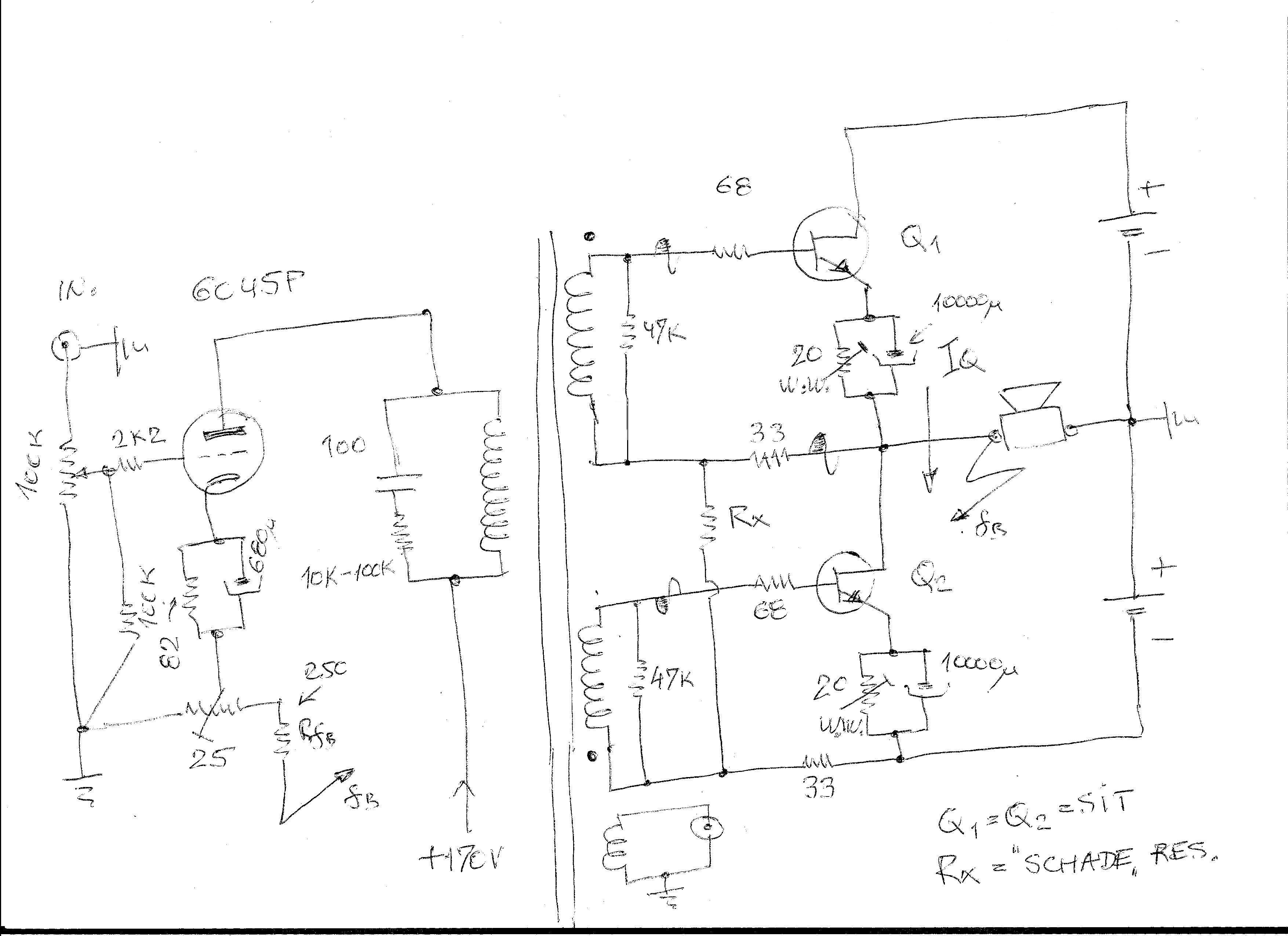

Here is the corrected schematic from my post #17 , so when you have time check it out with device SJDP120R085 ,
I believe that parameters model from my previous post is correct one .

I see here are bipolairs? but some strange way of using them bu use a emittor degeneration pot of 20 watts?? and a ac path through two caps, it is a idea to fight run away, but I think there are better ways.

Those devices sign are not for BJT but for SIT transistor ,
easy way to get stable negative gate bias voltage in respect to source is auto bias scheme same as in by some vacuum tubes applications ,
but than some heat from W.W. source trim pots must be accepted for sure ,
but hey this is A class game here so heat from different sources and devices is one normal appearance ,

I can seek the sic, yes I now it is a J-fet but on schematic you drawn bipolairs, as with tubes our mosfets, we talk about much more current here, I do not like so much that aproach making a heater of it.
But first I go on with X, between these work i help you out, I can change my model of the sic, making it other gate on voltages, so we can also come close.

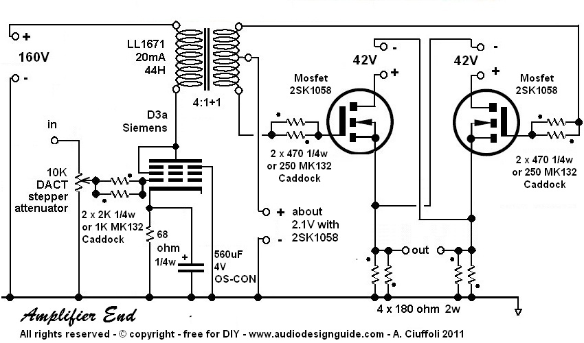

but I did see this schematic on the internet so you can see how other do, however get into account that there is a voltage on the transformer secondairy for the mosfet idle current maybe transformer get saturated.

Hi Kees
-Yes I have noticed that you are very busy with finishing your Alfet Circlotron project , which topic I always follow ,
-I know that hybrid schematic developed by Grant and followed by Audidesignguide , its OK , but as I have already say this time I want amp with SEPP-OPS not Circlotron- OPS,
-I know that interstage drive transformer is one very crirtical part for this type of amp , but with right IT transf. results can be very good .
-any way there is another options for simple hybrid amp which don`t use any IT transf. , but about that later ...
