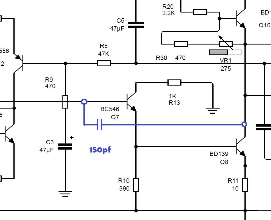

Hi Carlos! I have several questions about the HX Home version amp. First can I increase the R9 in NFB from 470R to 1.3k to reduce the input sensitivity. As shown now is around 100 and this is too much for my source. I want it to be 0.75V. If is impossible is not a big problem will use voltage divider. Second there is no VAS and NFB compensation shown on the schematic if there is any what are the values of the capacitors?
Thanks and Greetings from the cold Bulgaria to the hot Brazil!
Yes my dear...you can adjust your sensitivity the way you want
There's no capacitor in the NFB...if you want to use, then place 4.7 picofards there.
I forgot the VAS capacitor...use the standard value suggested by Dr. Self to the Blameless...use 150 pF
