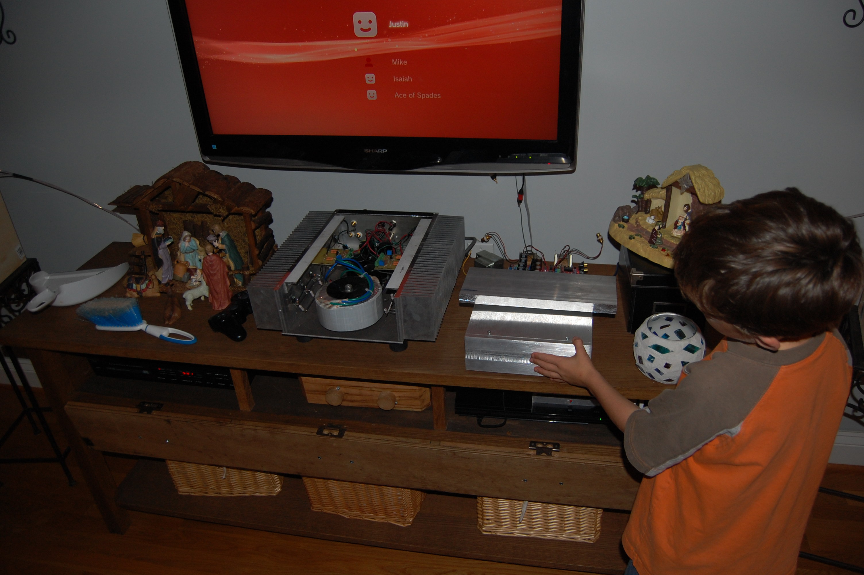

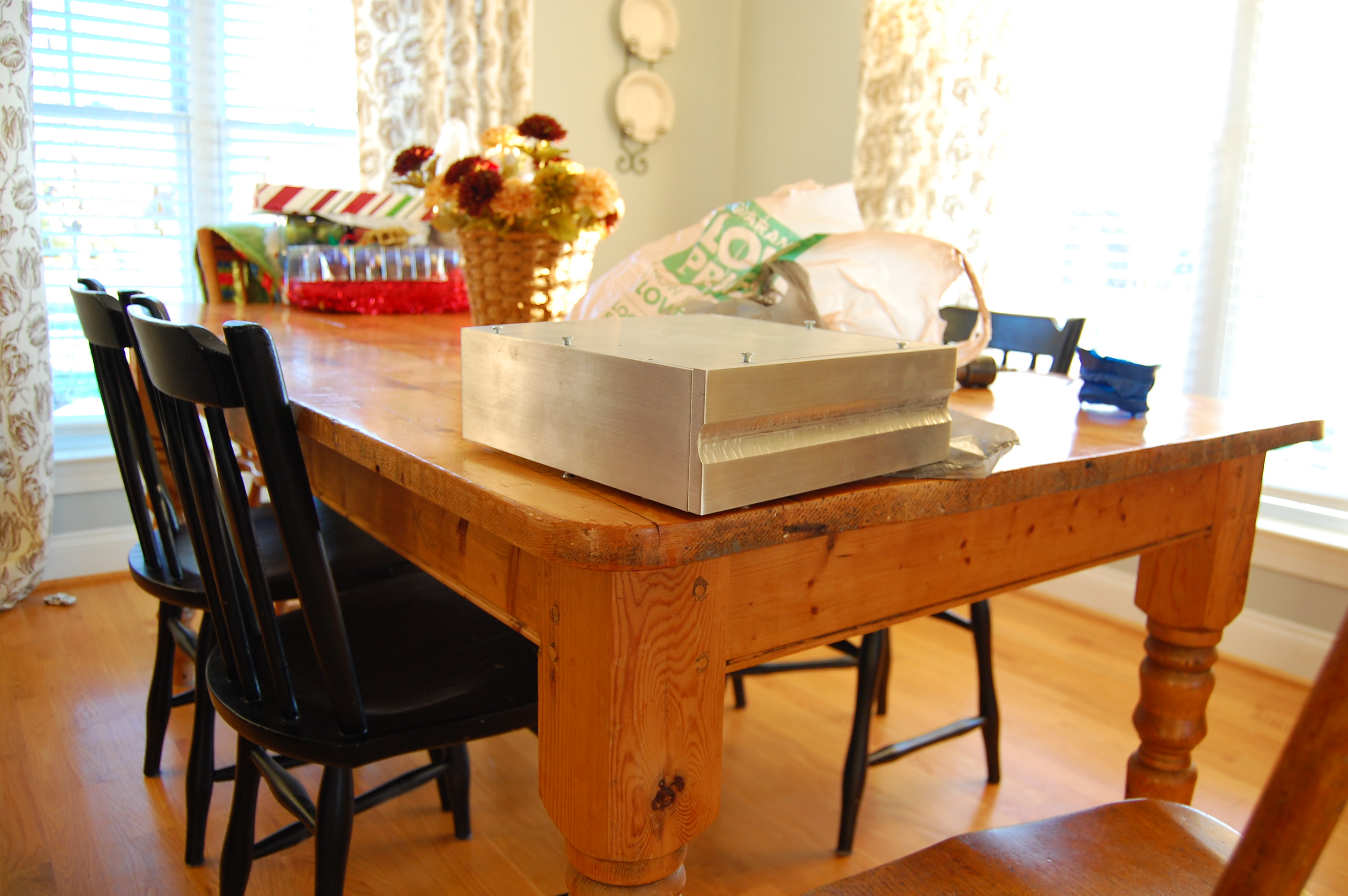

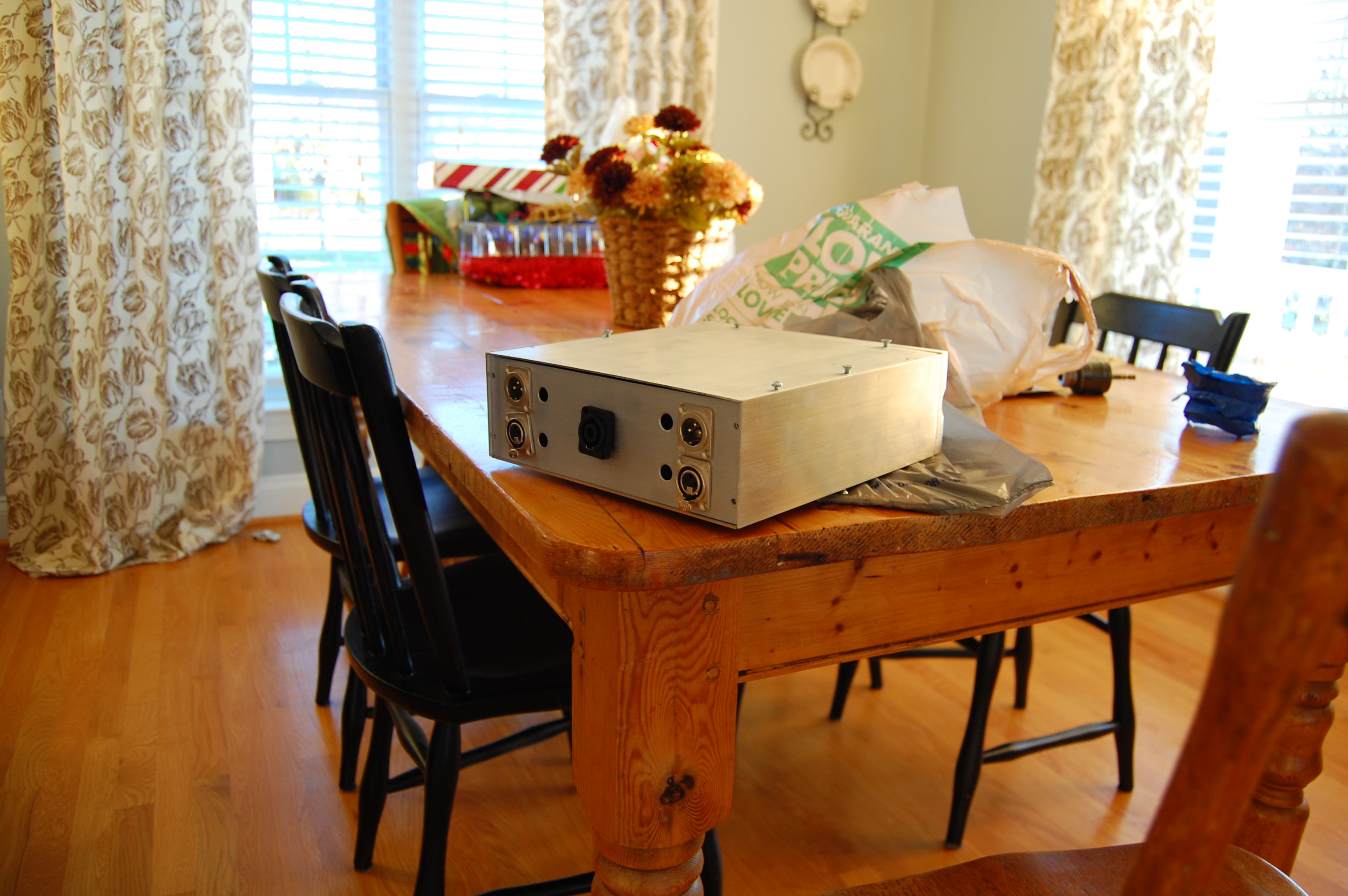

Here is the beginnings of my BA modular setup. Included pic is raw unfinished case for BA3B FE. There will be matching case with OPA1632 as well as Salas Shunt reg for each. I was going to power FE's with umbilical from BA output, but decided to change. Each monoblock poweramp will have its own standalone PSU with soft start diodes and 54000uF of caps. THis will be connected to main power amp through Speakon umbilical just like FE/Pre. In main power amp case, there will be another 36000uF of caps and output boards, nothing else. I am in the middle of trying IRF vs Renasas laterals. I may try the Fairchild as well. I will not use 3 output pairs because I just don't need the power and will instead heavily bias a single transistor pair or 2P and 2N per monoblock. Hope to have pics start to role in of different cases. I normally just build a partial enclosure like last pic (Jumas F5 version) and listen for couple of months. The boss said it was time to finish something, so the journey begins.
