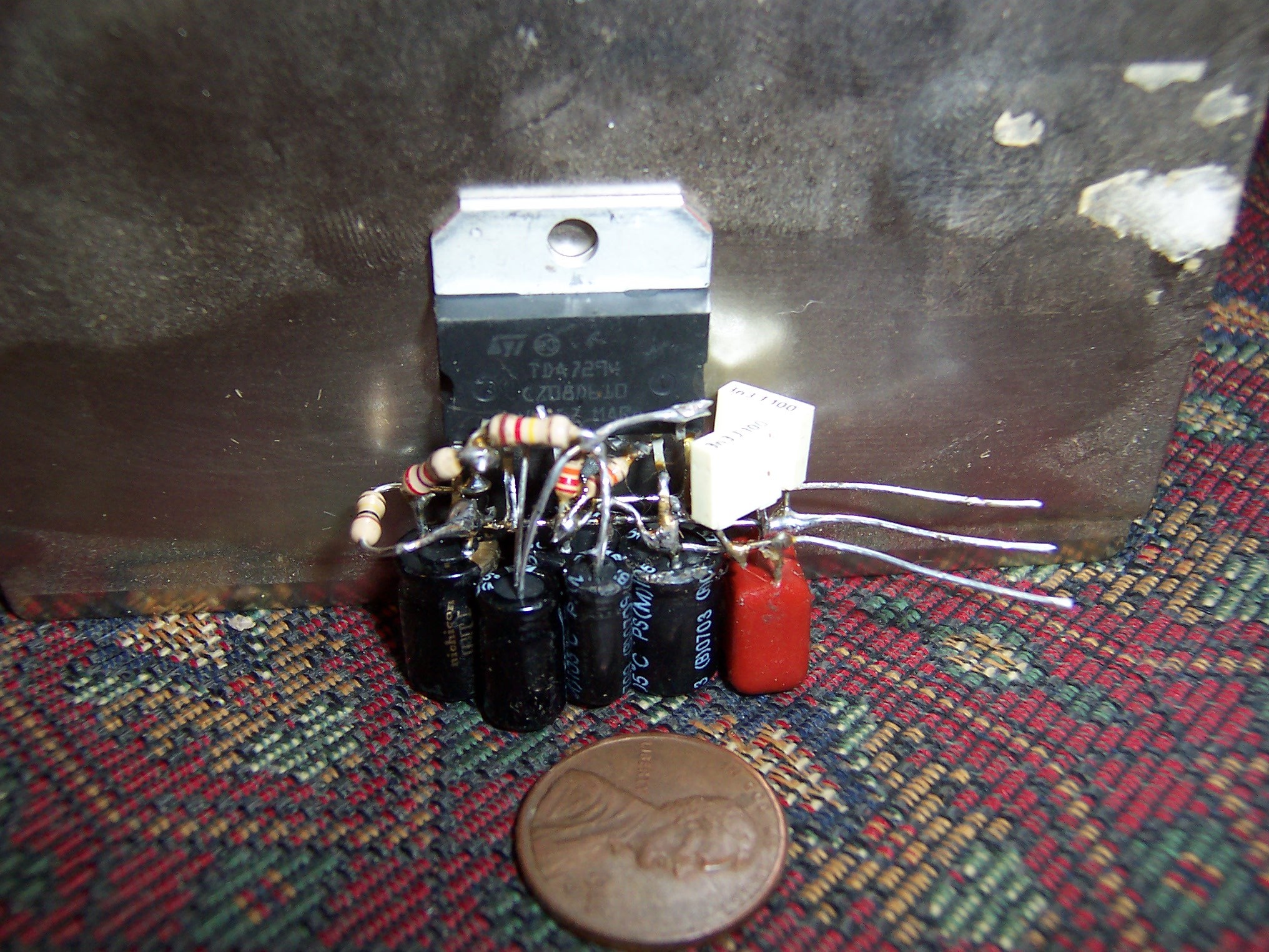

To meet the bare minimum, use a 47uF for each of the pre power pins and 22nF for each of the output power pins. That should maybe fit into the space available. With 4 chips, it adds up to just enough.
So, 16 caps under that little board? Well, that's still considerably easier than homemade led light fixtures. :)
And its far out easier than super clean sound Open Wire TDA7294 with no circuit board, but that option does exist:
