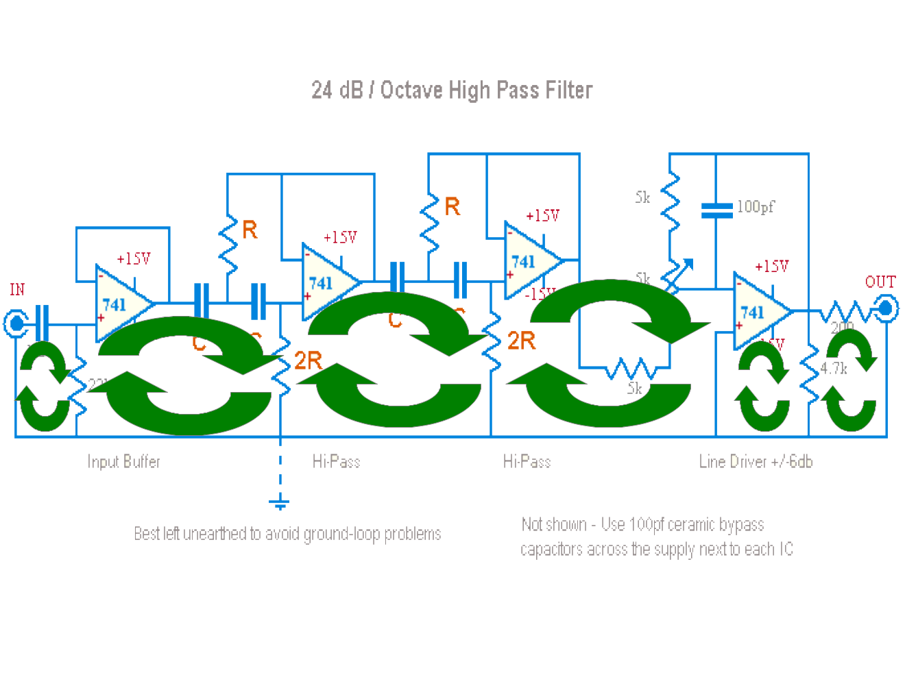

To eliminate power supply noise try running out off of batteries.
This is a good idea. Not to permanently leave it like that but to rule out whether the power supply is the source of your noise problem.
If there is still noise, then you can look closer at the filter circuit.
This way you are forcing the Return current to flow as closely as possible to the ROUTE that the Flow signal takes from input to output. This is close coupling.
It applies between equipment boxes. It applies between modules inside a box. It applies across a signal handling PCB.
I think Andrew is talking about these green ground loops and the other pic shows the close coupling method. Please correct me if I am wrong.
It's pretty funny that the schematic says to leave the ground un-earthed to avoid ground loops and then it shows a bunch of ground loops.

minimise the LOOP AREAS.
They are not ground loops, but they are loops.
Loop = aerial, receiving or transmitting interference.
Always arrange your wiring AND traces to minimise Loop Area.
There are also loops in the NFB components and their traces that need the same care in laying out on the PCB.

Ahhhh,
So connections haven't changed, the lines are just physically closer thus eliminating a coil and in turn, any interference.
Though this circuit is on vero board, I will keep this technique in mind.

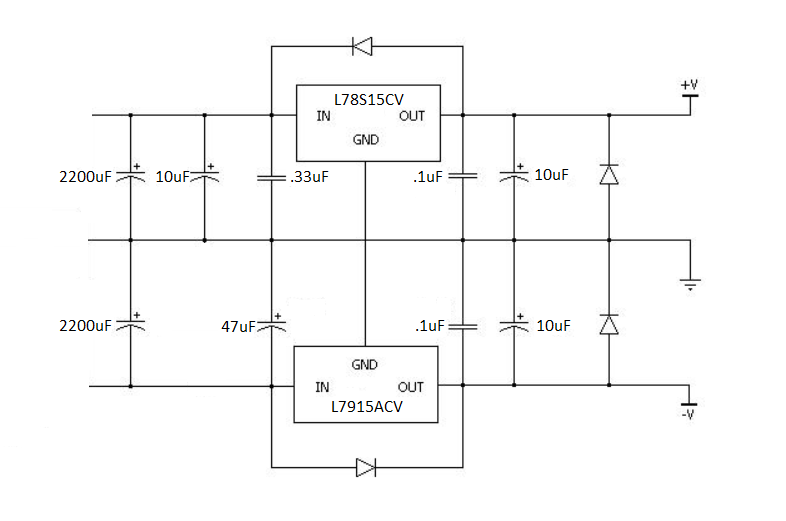

currently there are no caps subsequent to regulators of my psu, nor prior to hpf (same thing).
I'm told adding buffer to HPF (or subsequent to regs -same thing) should help.
Check the data sheet for your regulator and you'll probably see that they require a 10uF or larger capacitor
physically located right at the regulator input and output.
Alright chaps
As you can see C5-C8 'buffer' added as instructed.
@shreadhead perhaps a mistake in your diagram are polarized caps the right way up?
I've drawn them in the schematic as per your diagram but I think the lower one is up-side down?
Also, I realize HPF is actually dual polarity circuit, perhaps I'm wrong - please confirm.
I thought it was a single polarity at first. So I believe VE+ connects to +15v and VE- connects to -15v, subsequent to new capacitor arrangement, this right?
This and that power common (black triangle) should be isolated from commons in the HPF (white triangles)...

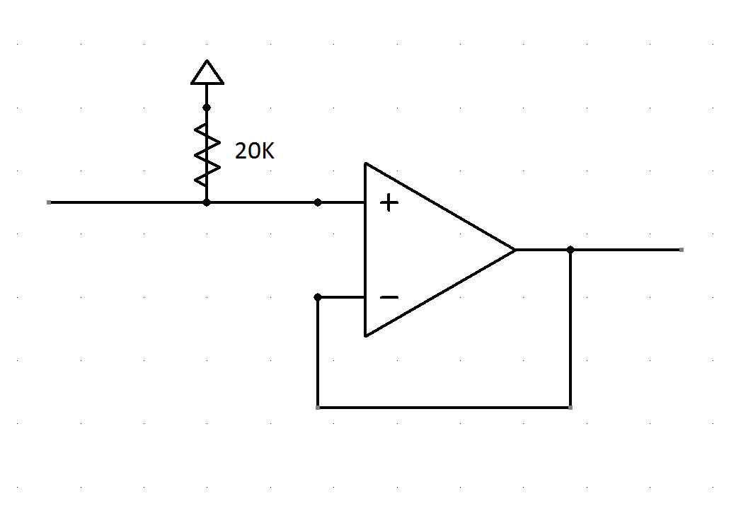

I've enclosed a pic of the PSU I use these days. You are right about the cap being out of polarity but it is a 100nF which is supposed to be a ceramic non-polarized anyway so it doesn't matter. If that was my fault I am sorry about that. From what I understand it is important for the 100nF and 330nF ceramics to be as close to the chip's pins as possible.
As far as whether you need a buffer on the input of your HPF, I read this on Rod Elliot's site pertaining to filters:
"It is very important to remember that inputs must always be from a low impedance source for any filter"
So probably you'll be ok without an input buffer but this simple buffer (see pic) will ensure that your filter will be fed with a low impedance source.
Also, Rod Elliot usually puts a 100 ohm resistor in series with the output of the last op amp in the circuit. About that he says:
"The 100 ohm output resistor isolates the opamp output from the capacitance of the output cable."

Alright
Regarding low impedance source, the HPF will be fed from XO directly.
XO already has a buffer therefore I don't think I will need to add one to hpf.
I will try re-arranging the second 2200uf caps to after the regulator see if this makes a difference, I will try adding regular non-polarized ceramics subsequent to regs if not.
