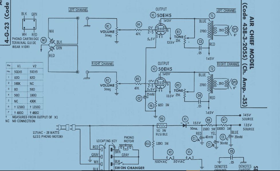

Looks like the PDF of the SAMS page didn't upload, too big - here's the schematic from a snip of it. It's a very basic 50EH5 amp design. There aren't a lot of places to look for potential capacitive links.

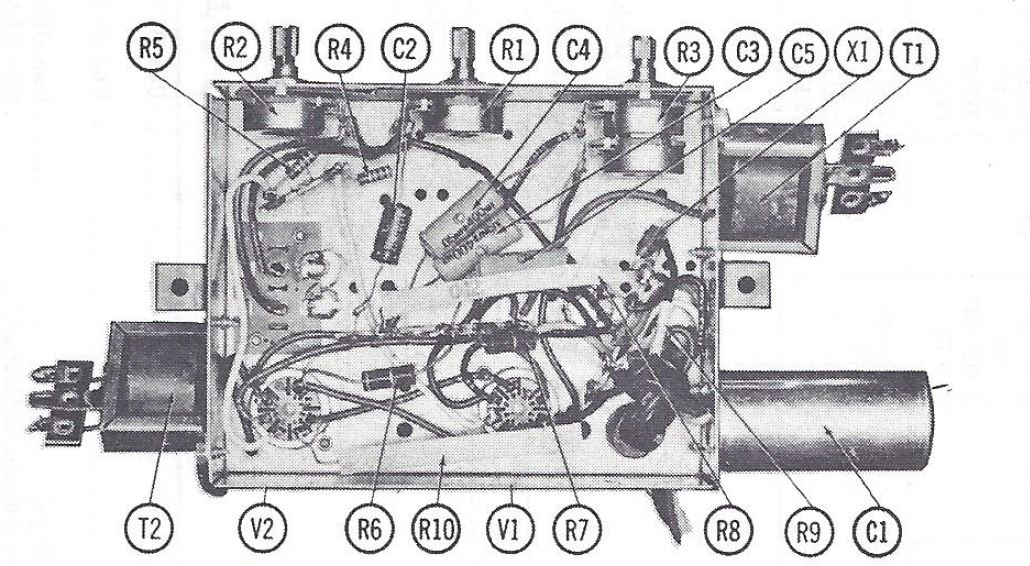

Here's another snip - it's the pic of the layout from the same SAMS page. I have replaced the 3 caps in the can - as usual they've gone bad. It removed the horrific loud noise that was present at all volume settings when I first got it. I've also replaced the three old paper caps with film caps of the same .05uf size. The 25uf 25V cap was replaced as well.

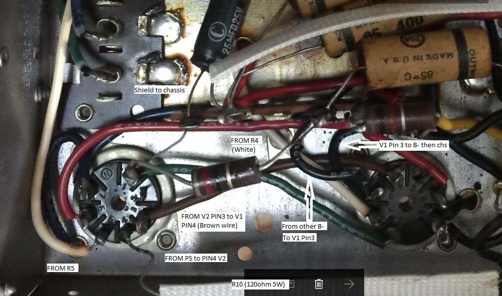

Wires from R4 and R5 to grids. They are not shielded, and go near filament wires.
The RCA plugs are soldered to the chassis right at the connection - if you look at the picture you'll see the two big solder points to the right of each RCA plug (there's more than one connecting point for the return besides the unoccupied return tabs). Mine looks pretty much exactly the same as the picture. I supposed I could try using wire to tap from the unoccupied tabs to the chassis to see if that helps.
It's possible it's the R4/R5 to grid wires, but then why do I have the mid-control hum so loud in one versus the other? Wouldn't that imply that this amp hummed loud in mid-control like this right from the factory?
Turns out I did indeed take a pic of this amp before working on it; the wirings the same with new caps (V2 is the tube at the left). I noted the different connections on this zoom view . I can see the white wire from R4 crossing under the power line tween V1 and V2 - but R4 is for the channel that has LESS noise mid-control. Any suggestions for shielding these wires? Maybe replace with different ones? I'm realistic in my expectations here - its's a cheap amp for the time, it'll never be noiseless, but I believe what I'm hearing is quite a bit more than what you'd expect from the factory.
