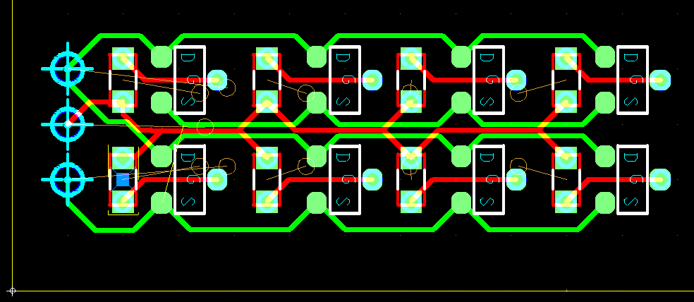

Actually, you can use the radio shack prototyper boards to fit the SOT transistors: I think this was an MMB5087 that I had on the workbench:
Just slice the gate connection with an Exacto knife.
