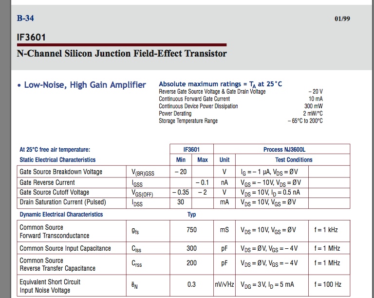

HPS 5.0 is going to use BF862 in SMD. Probably the best low noise JFET available today, so sorry a P-channel equivalent doesn't exist...
Here is the part.
You have to compare the equivalent paralleled BF862's to that FET. The gm/C is the important figure of merit.
Here is the part.
Yup, last time I've checked it was $50 a pop, in quantities.
BF862, I got 200 pcs for half of that. All you would save with Interfet is SMD soldering points, paralleled BF862 for the same transconductance are, performance wise, significantly better.
The point was to enable everyone to DIY something of real performance. BF862's typically equal 2SK170's on noise at 1/3 the C's. Yes there is a risk as the noise is not guaranteed, but they can be had for as little as .05$. A front end that requires $50 FETs (invariably only available as part of a group buy) is another matter entirely.
On a technical point the Interfet C's are specified at a reverse bias of 4V. Depending on junction grading this can be only 25-33% of the extrapolated zero bias capacitance (the SPICE parameter). Still 200mS at 5mA is impressive in a single package.
