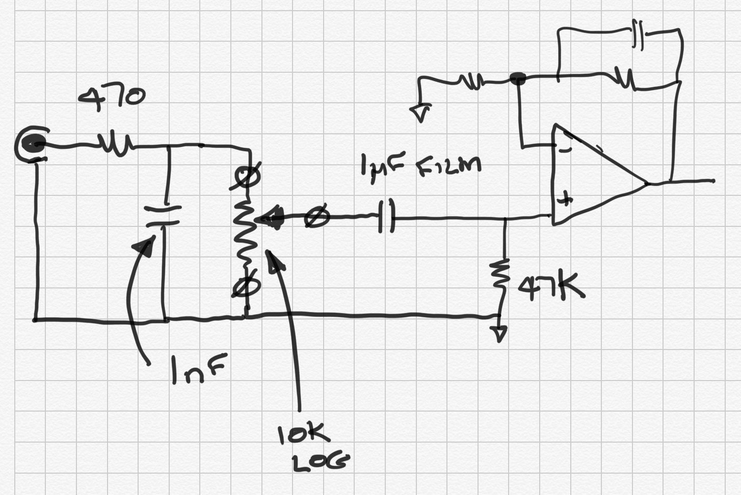

How to add a volume control to the HPA-1 if you are using bipolar input opamps. If using FET input devices, you can skip the capacitor.
The reason for the cap in bipolar input devices is that the input bias current causing ‘scratchy’ noise as you adjust the pot level.
