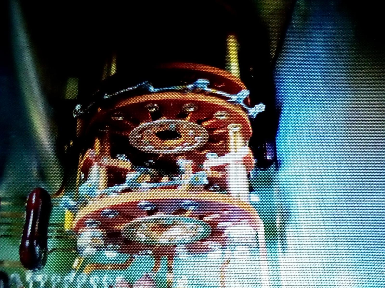

Hi Sync, and Mr. Marsh,
Well I finally found out was is wrong with one of my 339a's. See pix. I think that is Sw4
Steven

Hi Steve,
That's heart breaking! That damage came about from within the instrument.
"Struck by Technician", or someone who calls themself a technician. All you can do now is buy a parts unit to raid that switch from. Either that, or this analyser becomes a parts unit. I'm very sorry this happened to you.

I took a while to see what the problem is. I keep staring at it thinking this is cleanest looking 339a I've ever seen. No corrosion or dust. After a minute of staring I see half a wafer missing.
What a shame. I tried to find wafers for them with no avail. Close but not quite.
I also found a second switch with the center moving contacts pushed out beyond the wafer, I'm guessing these things must be my fault, as the owner, I have been working on the front panel Banana Jack's, two of which, had recent breakage of the plastic mounts, leaving the metal inserts "hanging", also the meter came loose and was moving around.
I don't believe in coincidences, so I'm guilty here. Yup. Too much heavy hand, not enough alignment and gentle, those switches are much too fragile.
HP should have used the blue plastic mil-spec based switches, the one place that HP didn't use the best parts, becomes a true failure mode decades later.

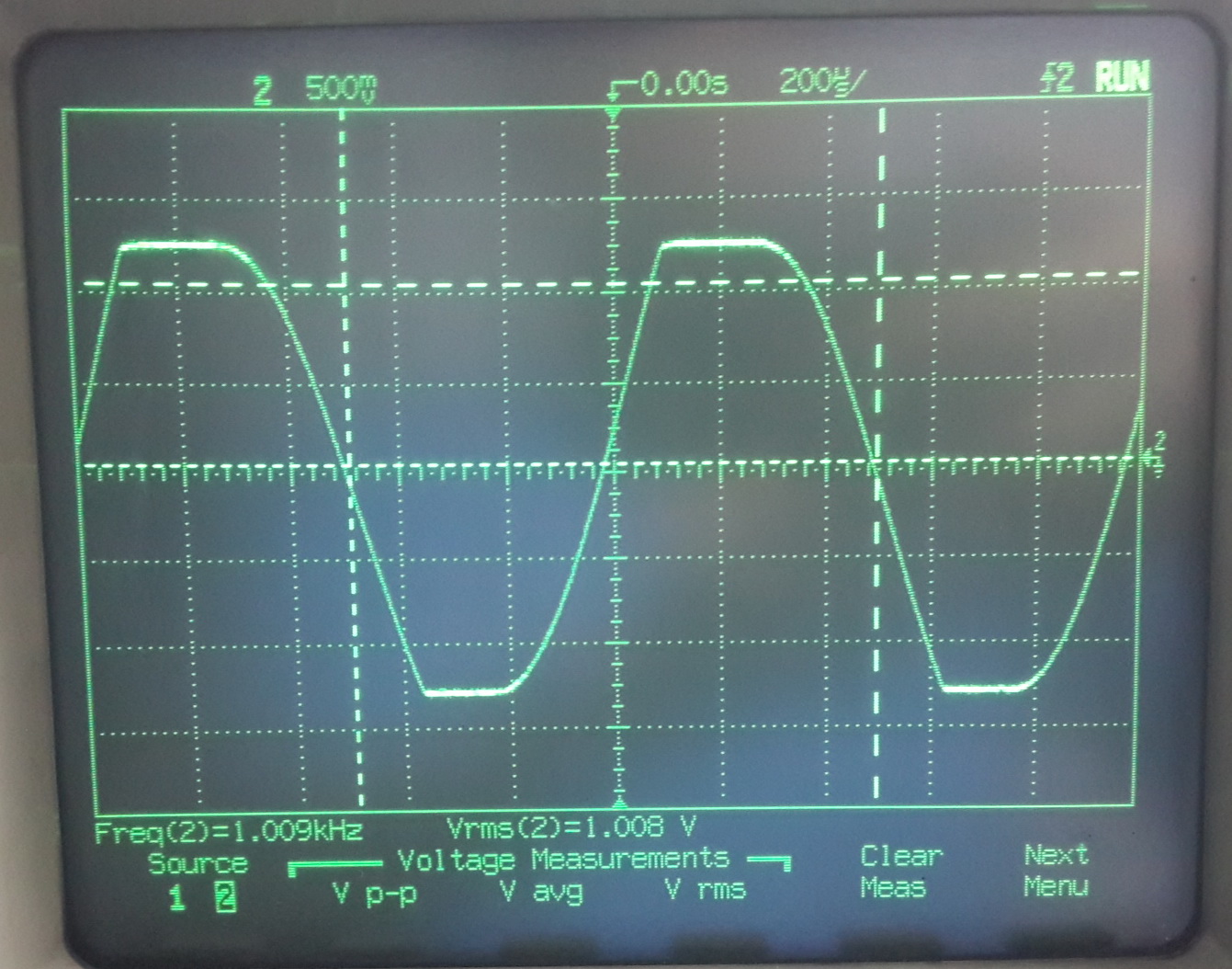

HP-339A OSC Output Distortion
I had one HP-339A.
But there is something that I can not understand.
Is there a noise (50Hz, 1K, 2K, 3K, 4K, 5K, 6K ...) in the scope waveform and spectrum of the OSC output as shown in the attached figure?
The Boonton-1120's OSC output is free of normal Sine waveforms and noise.
