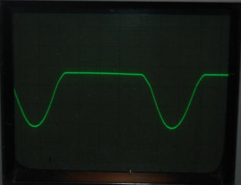

hp 654a test oscillator

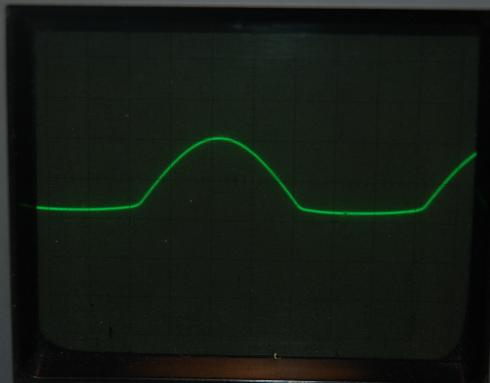

this is Q12 collector

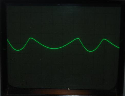

and finally this is Q13 collector
and Q14 collector is the same or has same waveform.
the Q12 base is nothing (zero amplitude)
i think that covers them all, at least the first couple transistors.
so again the problem is that the output is not a sine wave, its morelike Q11 collector look. and the meter circuit isnt functioning (i think because the output is wrong. ill get to the meter after the balanced amp is fixed)
hopefully that will give you a more 'in the lab' or 'on thebench' feel for diagnosing this oscillator. Im not sure about the negative feedback, but I did check all the DC values, and most were in tolerance, but some were out, I would have to go back and see.

OK, a quick look would indicate :
Q11 is OK. The funny looking collector signal is due to it emitter shifting (as its part of a diff amp)
Q12 is OK. There is a collector signal - it looks wierd since its base is clamped (the fault condition - it should look like Q11's base) and its emitter is shifting due to signal in Q11.
All in all, the diff pair Q11/12 are working the best they can but they are running out of 'swing' since there is no feedback :smash:
I'll have another look later ...
A couple of analysis tips:
(1) for diff amps, look at both collector signals at the same time, dc coupled and the same gain. They should be 'roughly' in anti-phase (mirror image) whatever the input signal is if the amp is operating normally. A caveat is that when the diff pair is biased with a resistor (like in this example) the bias point will move around somewhat with any common mode input. In the case of Q11/12 the amp is operating outside its normal range but doing its best ...
(2) for an individual transistor, look at the base and emitter signals at the same time, dc coupled and the same gain (set the traces to be co-incident before connecting the signals). They should look near identical with something like 0.5 to 1 volt between them if the transistor is in its normal operating condition.
My 1st stab at the fault would be Q21 (since its the OP and will be the first to suffer in a fault condition) as there is no feedback at Q12's base ...
that's funny I immediately diagnosed Q11 as the faulty transistor!however, upon reading your explanation, what you are saying makes sense, especially since our friend deyjavont here said the DC voltages seemed good.
