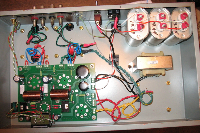

Well I pulled the trigger and ordered a couple of PCB's from George this morning. I got one for the Simple SE to start with, but also ordered one for the SE for later on.
This will be my second build so I'm obviously a newb. ;)
Unless someone points me in a better direction I'm intending on using the Edcore iron that George mentions. CXSE25-8-5K and XPWR035.
It also looks like a good idea to use the choke & run cap (suggestions?)
I'm currently thinking of building this on a 10" x 17" x 4" Hammond case, I thought I'd put the transformers and the PCB on top of this while the run cap and choke could be inside the case. I was also thinking of using the 10" x 17" x 5.2" cage to keep kids and critters out of harms way. Plus I kind of like the old style look. :D
My first question is this, do you guys think everything will fit as I've described it?

For run caps you can find them all over ebay. Just type in motor run capacitor. Look for something in the range of 80-100uf. The choke I used in my amp was a cheap triad choke from allied electronics.
Triad Magnetics - C-14X - Inductors - Passive Components - Allied Electronics
The best way I have found to see if everything will fit is either plot it on graph paper or make full size cut outs of all the parts(board, transformers cap etc) and arrange them on the counter and see what will work for you. I also used the Edcor iron and I am very pleased with it.
The 10" depth will make things a bit tight between the back of the PCB and the transformers, but it can be done. This is an annoying limitation of the Hammond chassis. They go no deeper than 10" unless you get a steel one. Then you won't be able to cover it because the deepest cover is still 10".
The 17" width may allow you to put them to either side if you wish. The Triad choke will fit under a 3" chassis, so that will not be a problem. The motor run cap is just a matter of finding an appropriate one. If you want it under the chassis, look for an oval one. Checkout "supplystuf" on eBay. They have a huge selection of motor run caps.

If you're able, try to find Aerovox motor runs. I think they sound better. There should be up to 50uF available, I paralleled 3 - 20uF for mine and they were a perfect, if tight, fit in my 4" deep Hammond case.

Bill, are the Aerovox run caps very expensive?
Also what are the copper caps you're using on your board?
Aerovox: Depends on who's offering when you search E-bay, as some sellers know they're in demand for audio, most don't. My last buy was for 6 pieces of assorted values from 20uF to 50uF for about $50 with shipping.
"copper caps": those are Obbligato from Diyhifisupply, $8 each for .22uF. I prefer them to Auricaps, Kimber, Jantzen Z-Superior and Jensen tin; more detail, better soundstage and never harsh or overly sweet. JMHO, of course.

Ty, thanks for the pictures, I don't know yet if the Edcor trannys I'm planning on are larger than yours or not. But I do notice that you've placed items on your top plate that I plan on putting on the ends, so maybe that will help.

You bet. Their size is what spawned my thread. They are overkill for this amp, but I wouldn't change a thing. My SSE puts out amazing bass with big tubes...it's great. I have a TSE to handle the delicate stuff. But that picture is the reason why I built a custom chassis. It was a lot of work. I had thoughts of building another for a matching Simple PP, but thinking about all the milling and drilling dashes that plan immediately. I have found a slightly goofy "chassis" for the Simple PP instead, but that is another thread.
