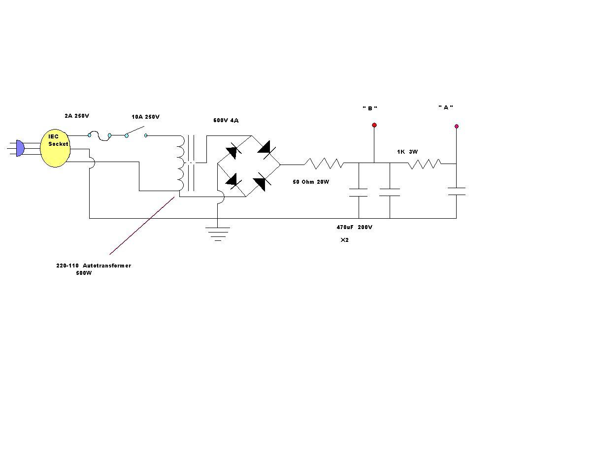

I'm on my way toward building my first tube amp & the most straightforward set-up would be using an autotransformer. Down here I can get a 220-110 at 300W for some $15 USD(60 Pesos) With a core of 5" by 5" by 2 1/2"....
Just how unsafe are these transformers & am I commiting the ultimate sin here by not using a "true" transformer....am I about to be censured?
Perhaps I could fuse it three ways to Sunday! Just to throw gas on the fire the grounds here are a hit & miss affair. Household wiring here is shoddy to say the least!
_______________________________________________________Rick.....

Gas on the fire is a good enough analogy
If any part of that circuit shown above and its connected circuitry interfaces with the outside of a grounded enclosed metallic or doubley insulated case then it's considered a safety hazard in most industrialized countries.
I would recommend a proper step-down isolation XFMR.
In-fact any time I use an auto transformer it's paired with an oversized isolation XFMER.
EDIT>A Fuse or more than one especially is not a panacea for shocking hazard protection.
An autotransformer is about the same thing as connecting a wire directly from your circuit to the wall outlet. It has zero isolation. Don't do it. An autotransformer doesn't need quite as large a core (not sure why), so is often cheaper. Is there any part of "Don't do it" that needs additional clarification? Did I mention not to do this? We'd like you to keep posting and the internet connection from six feet under is really bad. :dead:

If you like life, you'll heed the other posters and acquire a proper power trafo. Depending on the B+ draw, either a Triad N-68X (50 VA) or a Triad N-77U (100 VA) will get the job done for you, SAFELY. Both of those isolation trafos have dual primaries, a "115" V. secondary, and they are inexpensive.

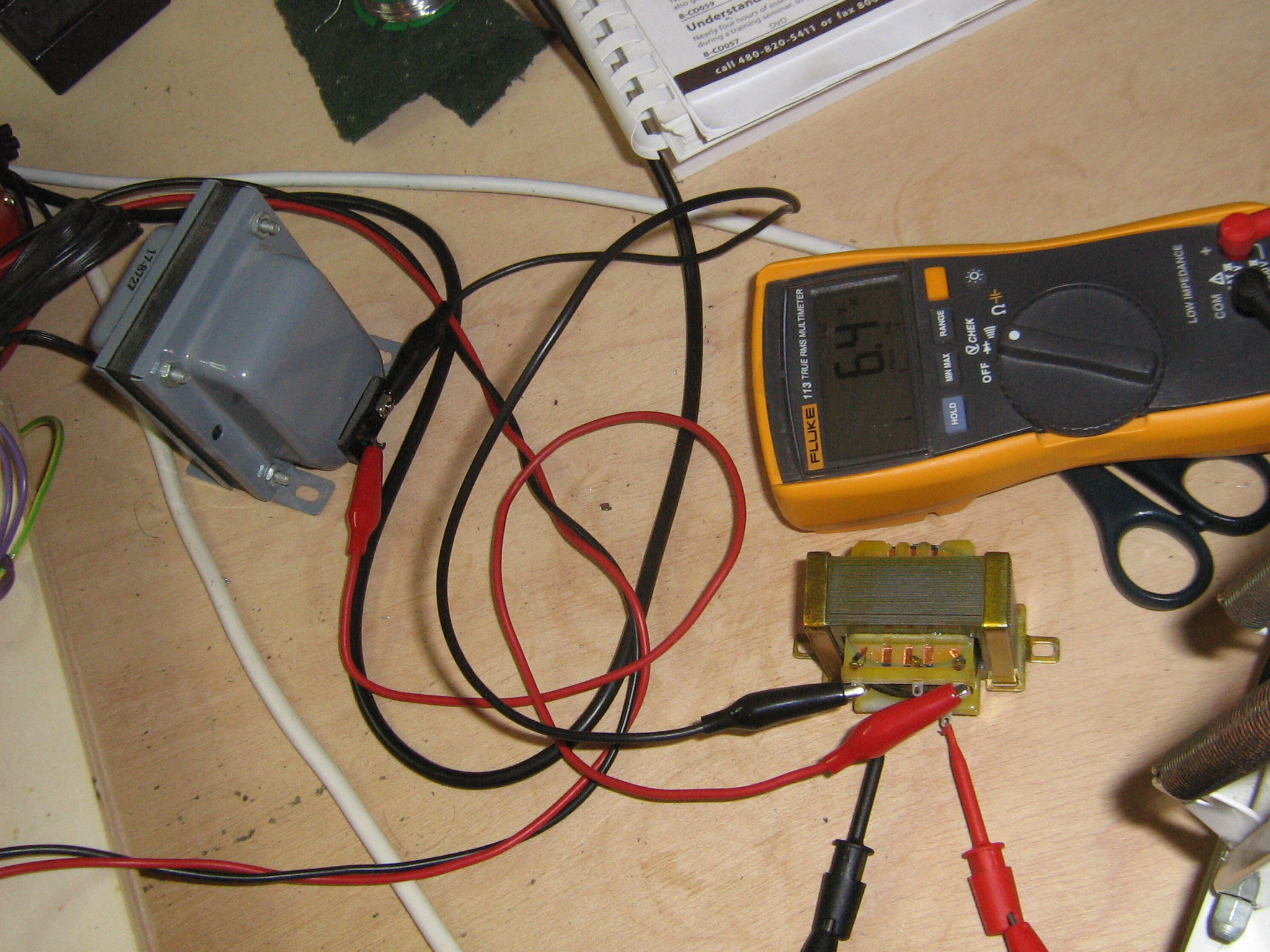

The best solution are the Triad xformers (I'm using these), but if You are by no means able to access to imported material, a couple of 220/12V cheap xformers, tied back to back, can do the trick. When feeded trough the step down autoformer ( this one rigorously outboard), You'll get half the socket voltage, and a safe chassis. I've just done this, this morning, to be sure that it works.

In my earlier days, anyone on my watch caught using an autotranny directly on the workbench without an isolating tranny where others also working was a punishable offence because it endangered others. Back to Tech evening classes on safety.
Simply put, engineering wise it isn't the done thing and contravenes a raft of IEEE regulations.. In many domestic European locations one often finds there isn't a neutral, but two live phases and earth. Don't blow ones chances.
