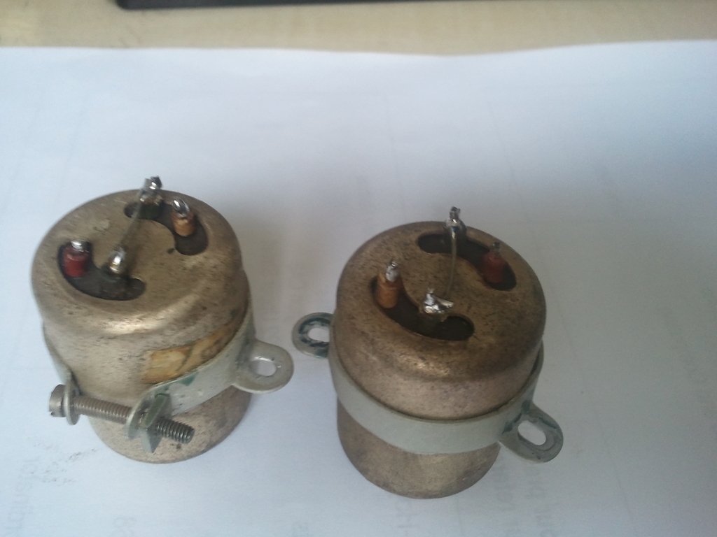

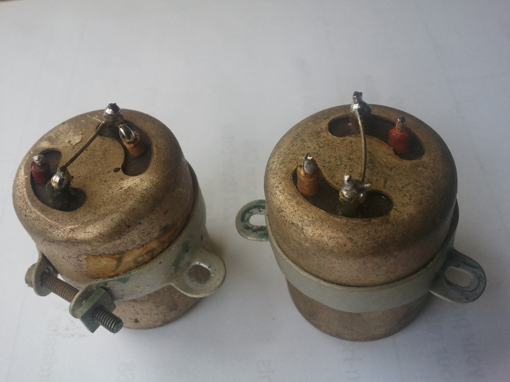

I have just bought a matched pair of vintage Partridge 6:1 977 transformers, and would like to know how to connect them up?
I am using a Cambridge audio 640p phone stage, currently mc input, with at33ptg cartridge that has 0.5mV output.
So i want try the 977 connected to the mm input.
I have a metal boxe and some RCA's, cables etc, and want to know how to connect it all up?
I am unsure of the best earthing method and if i need to add a resister for loading?
The 977's have red and brown connectors, and a wire joining two others. Do i assume the red is signal positive, brown negative?
Do i also earth the transformer cases?
Do i wire the tone arm earth wire, to the step up earth and then the phono stage earth connector, so all three earths are together?
Thanks very much
Ian

The diagonal wire is the ground for input and output. I would need to check mine for the input and output pins, but I would NOT use the meter to determine which is which - misconnection will result in no or very little sound, but no harm either. Edit: Checking old photos I'm pretty sure the red pin is the output and the gold/yellow is the input.
Use the ground connection diagonal wire on each transformer just for the specific channel's cartridge ground and pre-amp ground, and that transformer's case - do not tie the grounds from both channels together! And the arm and your case ground can share the phono pre-amp chassis ground connection. The transformer should be isolated from your chassis box to prevent loops.
Do not overheat the connections, I recommend pre-tinning the wires and tack soldering them to the pins. I have used a number of these excellent transformers and have not run into one that is damaged, but it could happen I suppose if sufficiently overheated.
Dead silent with this implementation. Run straight into 47K without any additional load resistors sounds best to me with the DL-103D and Zu DL-103.

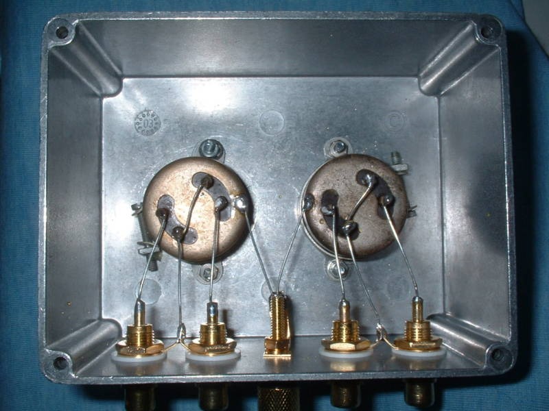

I found the ebay seller making a boxed version, so have copied his. The outputs are on the left hand RCA's as you look at the picture, output on the left.
The transformers are touching the case, do you think i need to isolate them, i am having no hum issues at all?
The transformers sound great, even with the same phono stage. a worthwhile investment. These will be fitted to the phono stage i build next.
Any suggestions?
Many Thanks
Ian

Looks just fine to me as implemented - no ground loops and it is quiet so no issues. I'm very pleased with the pair I own. :D
Note that they should not be placed near any transformers or motors - as well shielded as they are they will pick up fields from either.. (Noting that they are amongst the best shielded transformers I have)
