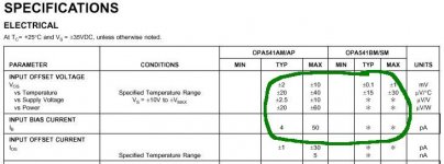

I also have a question, seeing that this is an OPA541/9 thread, what is the best way to zero the ofset of an OPA541/9 amp? i have used the following circuit:
help apreciated, thanks in advance,

The simplest would be a res in ser. of In+. Though those amps have jfet inputs and the ofset shoudn't be too dependent on that resistor. Make sure you don't have DC leftovers on the output of your source/preamp if you don't use input cap.
Looking at the data sheet: Ibisa-max=50pA. 50pA*220k=11uV. It means the major offset is due not to the inbalnce based on the Ib+ and Ib- rather the Vofset (Vos). Using just a resistor IMHO will not give you enough compensation -(you have to use rally high values which is not practical).
(More on that here. The input trans. are different but the concept stays the same http://www.diyaudio.com/forums/showthread.php?postid=259680#post259680). To finish that try the resistor (the one you are showing in your sch.) as Thor. sugests of 220k but I don't think it's going to work(I coud be wrong). Adding the resistor may need the cap in paralel because 220k is quite high.
You really have to add Vcomp. (from a voltage devider) at the +In. but I don’t think that’s justified having in mind you are getting only 10 and 20 mV offset (agree that still higher that the data sheet sugest). In fact looking at the data sheet (if you can believe them 100%) makes me think that there might be a measurement error coming from some noise in the output that shows at the output. Measure the offset with the pot in min (slider to GND) and max positions (no input signal though). I assume your DMM is good and it shows 0V when the leads are shorted.

Check http://www.diyaudio.com/forums/showthread.php?postid=260959#post260959 the peace of data sheet. It says Vos= +/-10mV. More than that and it should go to the garbadge. It depends on the manufacturing process.
