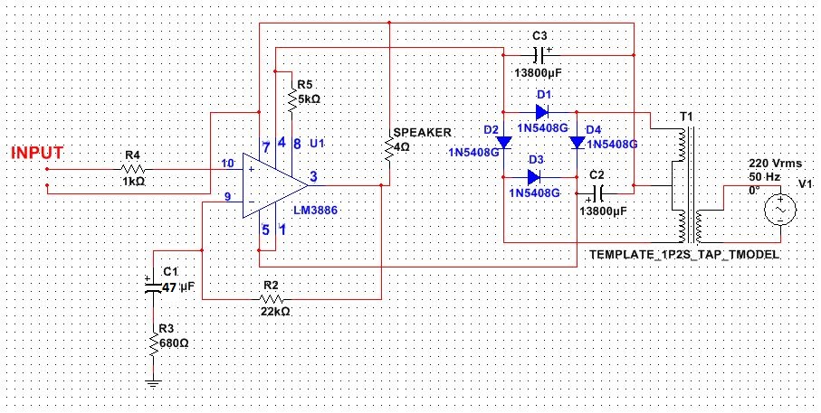

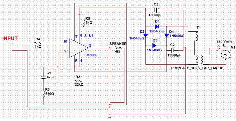

Once again, does the non-inverting (+)input have a dc-ground referance connection somehow? If there isn't a DC path for the input bias currents to follow, no, it won't work.
You need a resistor from pin 10 (Vin+) to ground
This is why we want pictures, could have avoided all the nonsense over PM.

Yes, most (might as well assume all) opamp inputs (both the inverting and non-inverting) need a DC path to a low resistance node. A signal source may or may not provide that path for you, so you should include one yourself to be sure. The 1k resistor in series with the non-inverting input is usually there to limit current for reducing the turn-on and turn-off thumps and noises, so isn't really necessary for proper operation.so are u saying if i feed input directly from headphone jack to pin 10, it wont work and i have to attach 1k series with 20k parallel to gnd for reference?

there are pics in posts 11 & 13.
Sorry, should have been clearer - the OP has been on PMs with me for a month now and has stubbornly refused to every request to provide pictures and a schematic, even after me saying that it was not possible to remotely troubleshoot without a schematic.
It was once we saw the pics that things became clear to me
It wasn't possible to help him at one point without seeing this, and when I told him to open a thread, he assumed it was because I was being difficult, and even messaged me something about the tone. I chose to ignore that. I can't help those who will not help me help them :S

Please provide DC reading on output pin (speaker output, not supply voltage). You may have a voltage close to rail voltage here.
As Michael said, if you do not provide a DC 0V reference the chip uses the negative supply rail as the reference. This results in an initial offset of close to one supply rail (in your case, 18V) on the output, and when you connect a speaker the entire voltage appears on the speaker voice coil. This may or may not destroy your voice coil, but will burn a chip in the matter of half a second.
If you have not provided the Rin to ground you did not follow the schematic 'exactly', as you told me you had. It is important to follow exact components down to the last detail unless you understand clearly the implications of removing them.
Sad as it sounds, you will probably need new chips.
