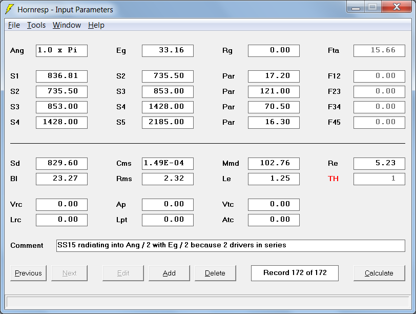

Attachment 1 shows the input values for your SS15 example.

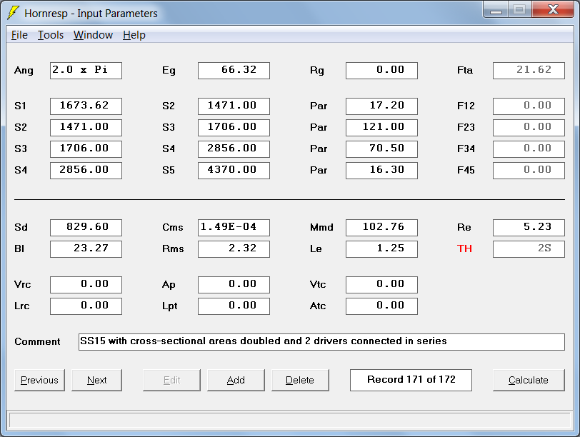

Attachment 2 shows the input values with SS15 cross-sectional areas doubled and 2 drivers connected in series.
Attachment 3 shows the input values for SS15 radiating into Ang / 2 and with Eg / 2 (because the 2 drivers are connected in series).
The frequency response results for:
* Attachment 1 with the Multiple Speakers tool used to specify 2 speaker in series
* Attachment 2
* Attachment 3
Are all identical, as are the diaphragm displacement results.
