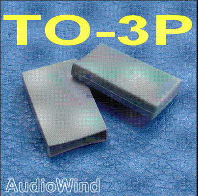

I prefer the gray silicon gum, pretty good isolation (over 500V) and good thermal transfer. Usually with grease in both sides. Also try the gray boxes that cover all the transistor, available for TO220 and TO247/TO3P.

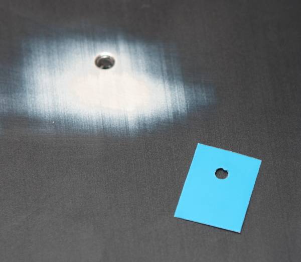

make sure you counter sink the holes on your heat sink.
attachment.php
also, polish the surface since extruded Aluminium surface is far from even..
attachment.php
finally, in my case i've made use of Copper spreader which bolted onto the heat-sink. and transistor is placed over it pressed down by Aluminium plate.
