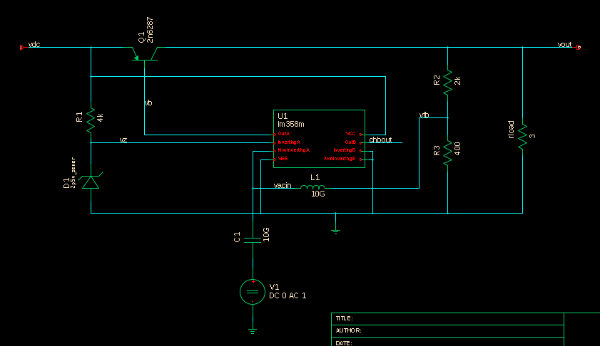

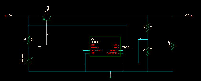

How to model stability analysis of a linear regulator such as this?
In simulation, what is the proper method to model a stability analysis of the following circuit?
Meaning where do I inject the AC signal and where do I look at the loop gain/phase? Do I need to inject the AC signal into vdc and look at vb? If so, what other modifications do I need to make to my testbench to properly model the analysis?

use forum search for Tain Middlebrook LoopGainProbe for some discussions
you can also force the output with a Isource - the impedance curve is related to the feedback factor - severe peaking is a warning sign
load step response gives similar info
-30 degrees phase margin at the 0 dB gain intercept means its an oscillator, not a regulator
base pullup R is always used in real circuits
the pass Q adds gain depending on load current to the loop so compensation is required somewhere - heavier overcompensation is required for larger load range, C on the reg output has a big impact on stability

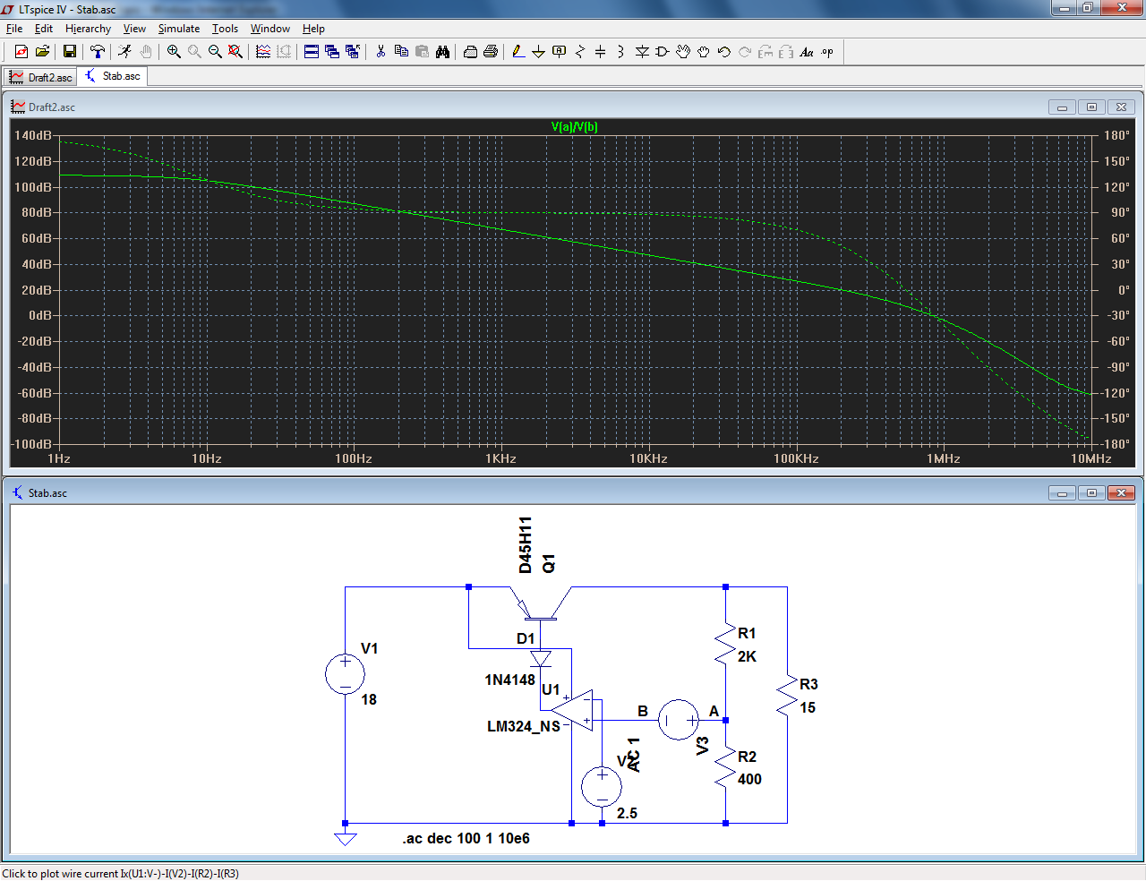

Here it is; the circuit had to be adjusted to display something usable as the original values were too crazy, but the principle remains the same whatever the exact circuit.

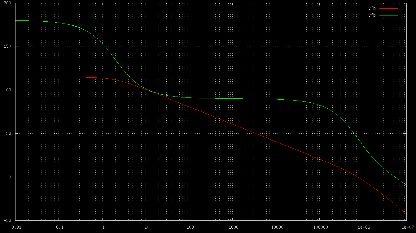

Hmm, Elvee for some reason the circuit that you posted does not work for stability analysis. I had to put a large series L and large C to the AC source to get the analysis to work.
With that said, I'm finding this setup stable without any compensation. Why is this? I modeled my opamps to have a similar open loop frequency response as in the datasheet of the LM358. Is this because the low gain bandwidth product of the opamp?
Probably some restriction of the simulator you use.
Could be many reasons, transistor not conforming to model, parasitic inductance in the input loop, etc
