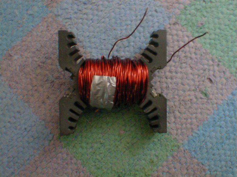

Hi again,
I'm still trying to make my 12 mH inductors, so I guess time is of no value Chuck ;) I was looking to make an inductor like this one http://home.hetnet.nl/~geenius/Sales_bestanden/image002.jpg It's made out of CRGO (silicon) steel or colded rolled grain oriented steel or in other words electrical steel laminations (I'm pretty sure). It's inductor/transformer with an EI-96 core stacked to 102 mm. It's 15 mH.
I was going to obtain some of these CRGO (type M6) steel laminations and try to glue them together myself with varnish. I say "try" because manafactures do it with a vacum (do it with a vacum:goodbad: ).
But then, I was taking apart a washing machine and found out that the motor has electrical steel laminations, but they're not grain oriented I think. They're 5x5" with a 4x4" hole and about 1.5 thick. So I cut them in half and flipped them, so that they make an "I" now, get it? And then wound wire around the "I." They seem have a permability no more than air.
Why is this? Is it because I cut them? Is this what gives the EI cored transformer above inductance? That fact that the core has electrical continuity all the way through and surrounding the core? Is this the right forum for this question? How do I post pictures in this place? Do I have to post them on the internet and then provide links? Maybe that would help me.
Please read my post right above
Inductance of these inductors is .08 mH. But they look damn good if you ask me.
I had the same amount of wire around a ferrite rod and the inductance was 12 mH. But when I took the steel clamps off the ends of the rod (they were used for winding the wire) the inductance dropped dramatically. I think if no one has any advise for me I will unwind the wire off these and drill holes and attached them to the ends of my ferrite rods (after cutting them to a smaller size). Is this a good idea?
Yes, they're magnetic. They're coated with automotive primer. My main question is if I didn't cut them would they be more effective? I'm wondering if that's how the EI-core has good permability; because current can go all the way around and through the copper windings. I guess this material just sux, but I don't know why:scratch:
