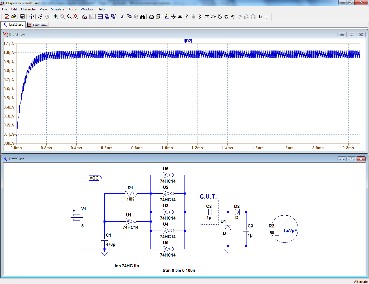

Small capacitance values can be measured on basic multimeter operating as a microammeter with a simple multimeter adapter: this one will give ~1µA/pF, and the scale factor can easily be modified.
If a function generator is used as a squarewave source, the circuit simplifies to two diodes and one cap
