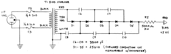

Please see the attached diagram on my Medallian transformers.
Have never measured, and was wondering what the bias voltage is.
Where do I put my test probes,

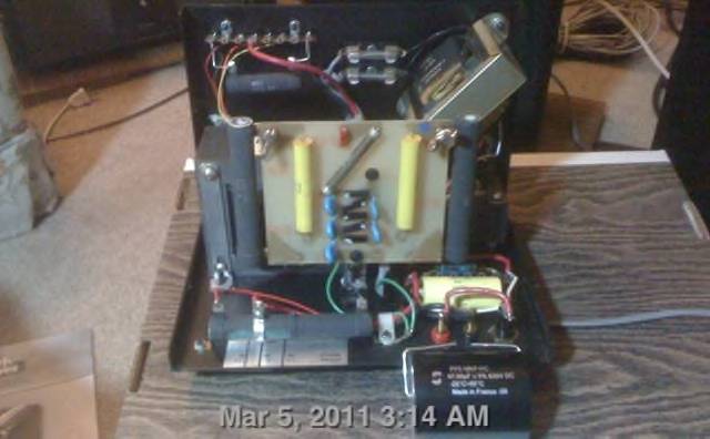

What i have done with the Stock Acoustat bias.... make a bias outboard box you set 4-7k............
So this mean geing bias out of the Box were the stepup tranX an res. 50k 50watt an the .1 caps are....
Stray eddys are alover the board look at the pic...1" from the driver res an caps...Driveing the panels can pull the bias Down....you get much better output out of the Panels......An the Acoustats are well worth it.
But if you wont to stay...With stock bias setup.....that i have found all low.. like 4k.....after being feed Ac-Dc all the time for what over 15 years.....
I have found this after owning 20 Acoustats panels for over 30 years
Drop the bias 500 meg to 15-20meg...get the bias up.....you Can get 3db more output...an the setup transfourmers An parts...well run a lot cooler....an you may get 20-50 more years out of the Acoustats.....

The best way to measure the bias voltage is with a high-voltage probe, and this is the way that Acoustat's factory verified the voltage. This is done by connecting the probe's negative lead to the high voltage ground, at the center rear of the printed circuit board. The positive lead is connected to the red tip-jack, that is, after the 500-megohm resistor. However, due to the high output impedance of the supply, and the loading effect of the probe, you will typically measure about 3000-3500 volts when the supply is actually putting out about 5000 volts. The measured voltage will vary with the impedance of the probe, so different brands/models will yield different results. Therefore, this method is not so much for measuring the exact voltage output, but it is useful for troubleshooting, and/or verifying that both interfaces are operating the same.
A digital voltmeter with a 10-megohm input impedance can also be used, with the same connections as above. In this case, the meter will read about 90-volts due to the meter loading the supply. Again, this method will not yield actual voltage, but it is useful for comparing two interfaces.
A variation of Heisenberg's Uncertainty Principle applies here - due to the high output impedance of the supply, it is virtually impossible to measure the voltage applied to the diaphragm without changing that voltage.
The method mentioned in another post is okay (measuring the voltage across the first diode, and then multiplying by five), but will also yield results that are more relative than exact. However, that method will not verify the proper operation of the 500-megohm resistor.
I am also not a big fan of increasing the bias voltage, but others have differing opinions. Decreasing the value of the 500M resistor by a significant amount will take away from the very important constant charge operation (and thereby increase distortion). If you needed to replace the resistors, and couldn't find 500M, then a several-hundred megohm resistor would still be okay, but I wouldn't go lower than that. Otherwise, if your resistors are okay, I would recommend sticking with the stock values.
Likewise for the bias voltage, Acoustat did extensive research in arriving at the optimum bias voltage for the speakers, which is a good compromise between efficiency and potential arcing problems in high humidty/high altitude conditions. Increasing the bias voltage WILL increase the efficiency, but at the expense of possible problems with arcing under high-drive conditions.
I have posted many times on how to build a device to very accurately measure such voltages.
The whole thing would cost but maybe about $10 with parts from your local Radio Shack store.
However it would have to be measured before the 500Megohm resistor.
Or measure the 500Meg resistor for it's exact value and include that into the voltage divider calculation and use another resistor to ground to give you a 1000:1 voltage drop,
Then the reading on your meter across the new resistor to ground would be 1V per 1000V.
Using an opamp buffer will eliminate any errors due to the meters input resistance.

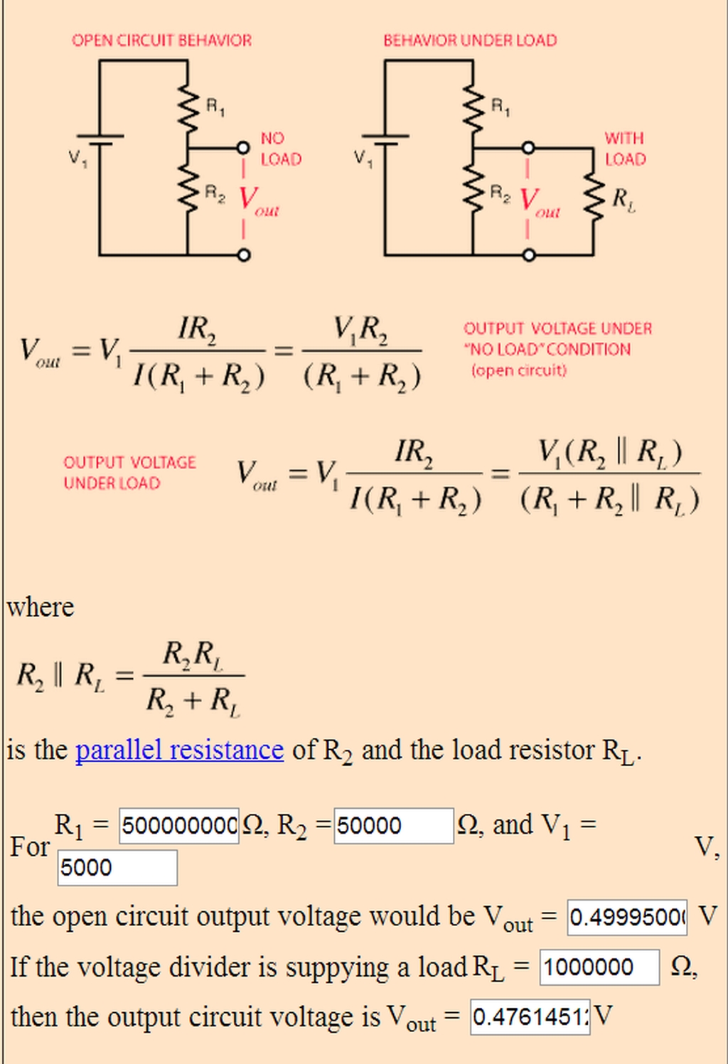

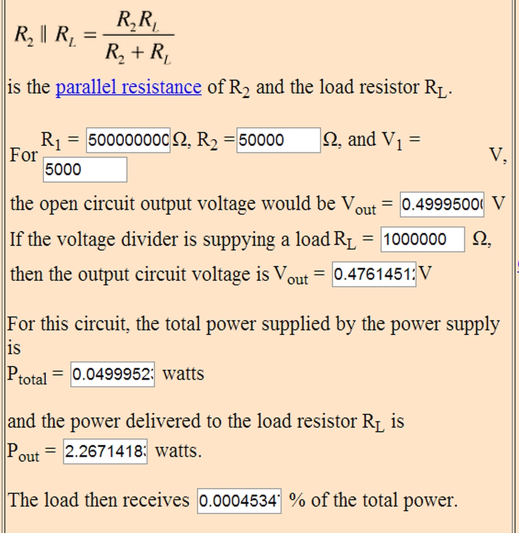

Yes, If you know your meters input resistance you can closely calculate the voltage.
Do have the ground lead connected to your meter First before attempting such measurement technique.
If you don't then there is the possibility of harming your meter as it will be energized at a 5Kv potential without the ground lead
connected.
Using the link to the online calculator I provided will allow you to include the meters input resistance as well into the calculation.
It needs to be much higher than the bottom resistor in the chain.
you would surprised in how much of a difference of an error it can make it you don't.
Using a 50K resistor from the 500meg to ground will give you a reading of .5V for 5Kv (.1V per 1Kv) across it on your meter and will be fairly accurate if your meter has an input resistance of at least 1Megohm or greater.
With a 1Megohm meter input resistance the voltage reading error will be about 4.76% lower than the actual value with the above method.
