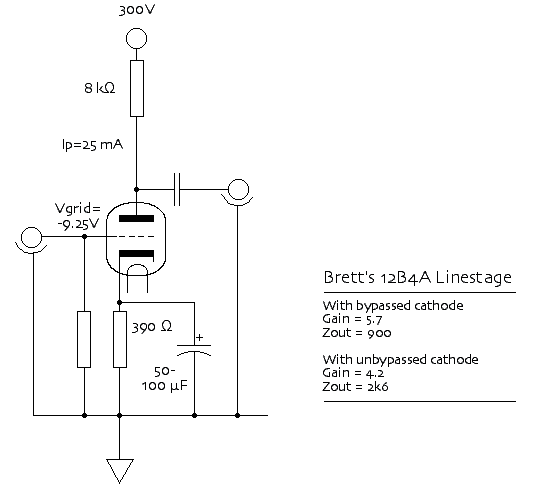

I don't know how different is Brett's to Brian's which I changed a bit and fdegrove changed a bit which became...You are right bright is the word with the 12b4.
it is a brett 12b4 linstage.
I have try changing the the bais form 15ma to 19ma to 25 ma.
change the from 265v to 300 v
change bypass cap to black gate.
try 3 other SET amp, they all sound bright.
can it be the out cap ? .22 beewax.
Thansk again for all the help.
John

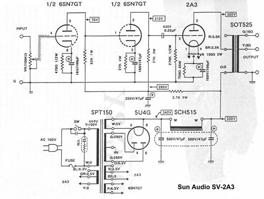

The 8k2 plate resistor is a Kiwame. And ignore the Auricap on the output as I downgraded to a 0.5uF Electrocube. B+ is 180V.

Sun Audio 2A3 attached...
It also exceeds the maximum capacitance for a cap-input PSU. I'd also change the 750 Rk to 880 (or 820 available at Farnell).

problem solve
thanks arnoldc
problem solve ,it was the cap.(.22 beewax)
the 12b4 was bright when I have it with beewax .22uf, but after I change it to 3.3uf the brightness are gone.
I have use 6x4>46uf>2k>4uf>8k2 plate resistor.
my speakers are Avantgarde UNO,ZU Druid and Omega super 3.
amps DRD45,sun 2A# and Cary 805C

jj2,
I built Brett's 12B4A preamp and I would not describe it bright. Natural or analytical perhaps. It sounds very good. In an A/B test it destroyed the Audio Research LS8 comfortably. The ARC has a very sweet and clear tone.
I used the cheapest possible 2W metal film resistors (in parallel to make up the Watts) since I couldn't source any resistors of famous brands in Australia.
220R grid stopper, 680R cathode (no cathode bypass), 5.8k plate, 4.7uF ICW Clarity SA Cap (630V polypropylene), cheap 50k volume pot.
I have compared using the 12B4A preamp to without using a preamp (with a 845, LS3/5A, since the 845 has a volume control) and adding the preamp actually improved the overall sound. Without the preamp, the sound was clearer and cleaner but much thinner. Adding the 12B4A preamp added much more depth to the music. It may be due to the "good" distortion introduced by the 12B4A or the 12B4A provides better drivability / impedance matching.
I agreed that the 0.22uF was way too low. As far as parts are concerned, your electro caps have the biggest influence on the sound.
I think to get mellow and warmer sound a tiny change on the speaker crossover will have a much bigger impact than changing parts on the preamp.
Tube rolling? I have had Westinghouse, Sylvania and GE JAN. The differences in noise and microphonics exist (can't say which brand is better because I had at most a pair or two for each) but you would push yourself hard to find differences in sound.
I would be interested in knowing your result comparing your now "rectified" 12B4A preamp (with 3.3uF output cap) to your passive preamp. I would also be interested in your findings on various bias points on the sound of the 12B4A.

Hi John,
It's not mine. But the minor mods include:
1) lowering the first cap to 20uF (so as not to exceed 5U4-G limit)
2) the extra 47uF used with another choke (lower effective B+, a bit)
3) last filter cap paralleled with small value film (0.01 RTX)
4) changed 750 ohm Rk to 820 ohm
