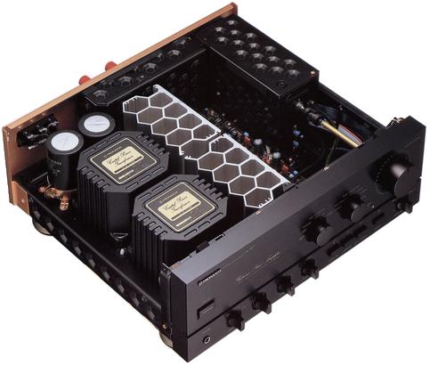

From MPOV it's nothing to do with sonics. Just to stop it buzzing and rattling. I think from the sonics aspect, you need to spec a decent transformer, antd make sure it does not go anywhere near saturation. I bought a 1KVA from RS that buzzes like a chainsaw (and it's not because of DC on the mains) and runs very warm. I put it down to the fact that it is 1KVA by the skin of its teeth. The Triad I am using on my e-Amp is a world away in terms of noise and it runs cool also. Interestingly, the Triad is about 2Kgs heavier than the RS transformer which I now use for stepping 110 to 220 in my office/workroom. It's not much use for anything else.
chassis...
I have repaired some of those commercial brand amplifiers mostly japanese.when you removed the base plate still the power transformer will remain inside the chassis screwed on a thick bracing or plate.I have seen most of the amplifier enclosure here and most of them without proper bracing.when you mount those big transformer on the base plate specially on the middle part the base plate will act as a trampoline causing the whole unit to vibrate.
I have seen the goldmund casing and notice the footings of the enclosure.I think they have used rubber bushing to lessen the vibration.I have opened a washing machine and i have noticed that it is using rubber bushings then the motor are mount on top of it to lessen of course the vibration.
And notice also that transformer are mounted usually at the side close to the corner or fold of the chassis coz this where the strongest part and most stable(COMMERCIAL BRANDS).
regards,
joel
