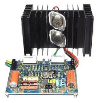

In the age of 16 i constructed an amplifier made from smart kit ( since you are Greek i presume that you know what i am talking about ) though the same amplifier is also sold in UK from quasar electronics . here is a link
http://www.quasarelectronics.com/kit-files/smart-kit/1033.pdf
The amplifier was constructed for a costumer and i was privileged enough to have a teacher at 16 to explain to me what to truss from the kit and what to keep
--replace the resistors with precision ones
--truss the capacitors and place better ones
--form a bit better input filter
-- truss the ceramic miller caps and use styroflex
--form a better vbe multiplier
--add a zobel
--use a beefy power supply + heatsinks
--construct everything clean and in order
--scope the blody thing after finished the construction

Did you have to mount all the electrolytics vertically to get such a long life?
